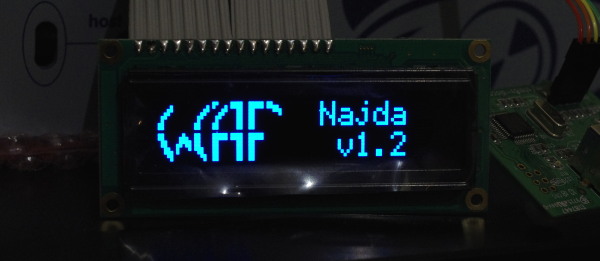

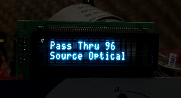

New stuff today: get your special displays out of the drawer 😉
OLED (WS0010)
VFD (PT6314)
Coming soon!

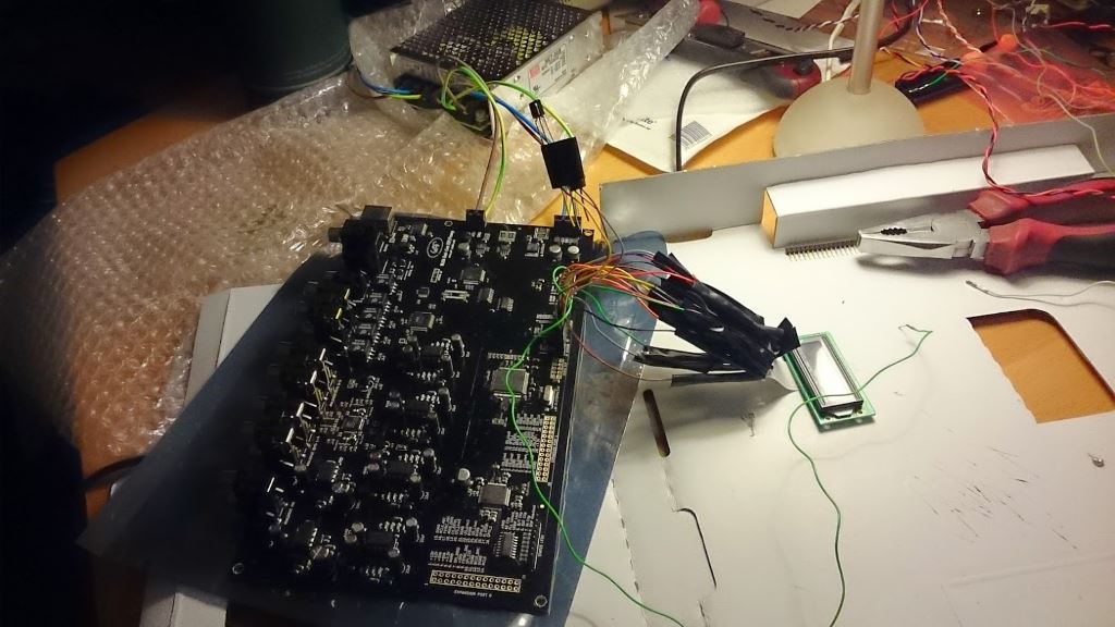

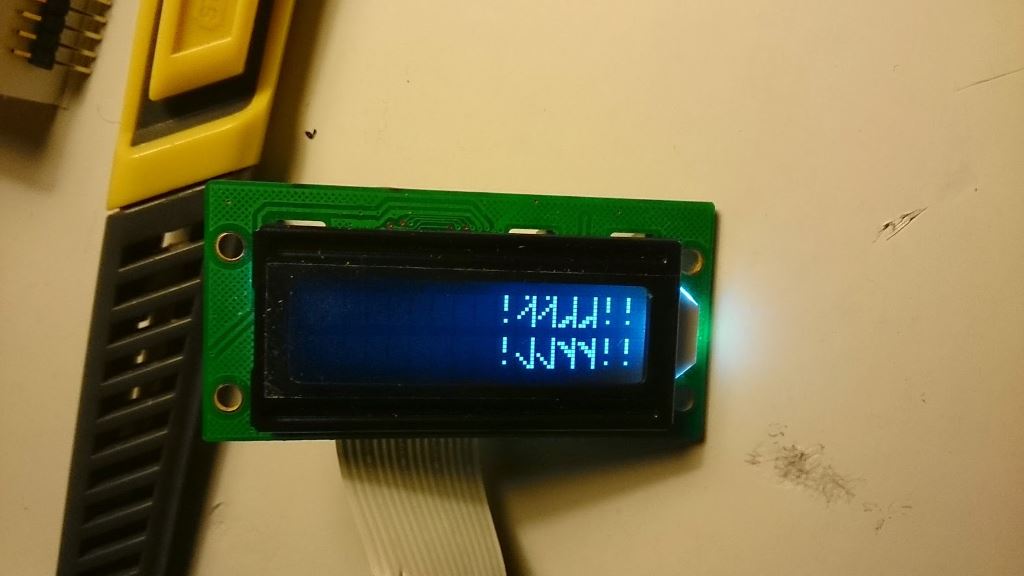

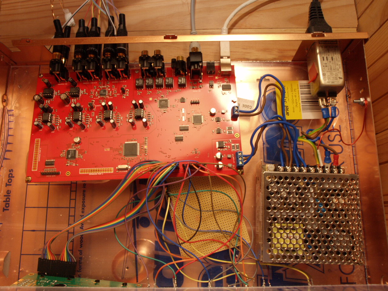

Making progress!
(Disclaimer: Not a single cable is connected or routed the way it will be eventually! This is just a ghetto get started version)

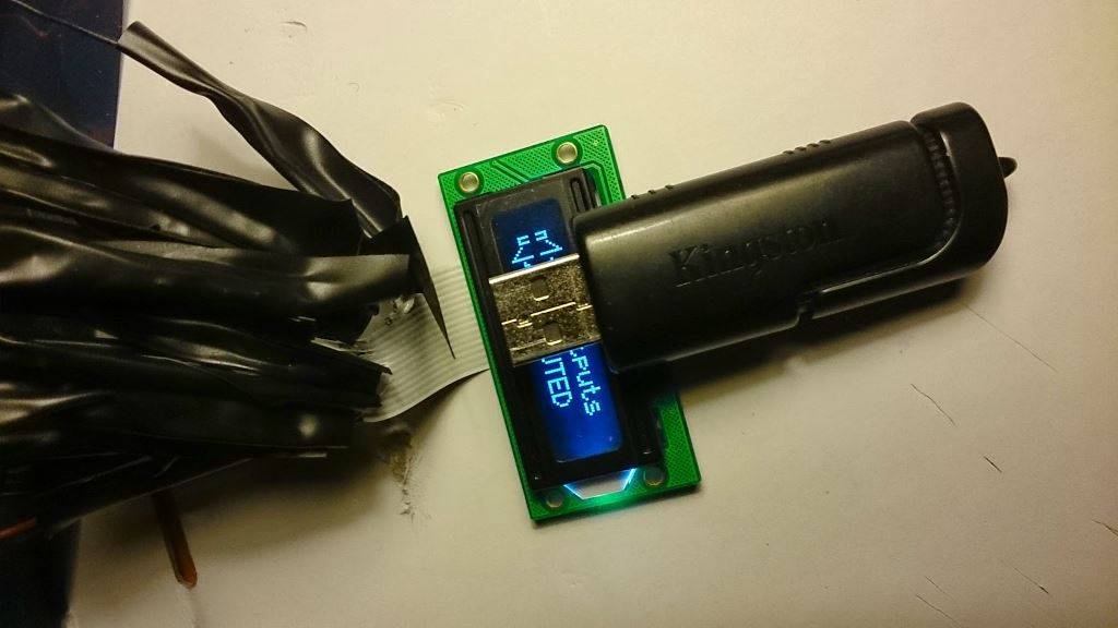

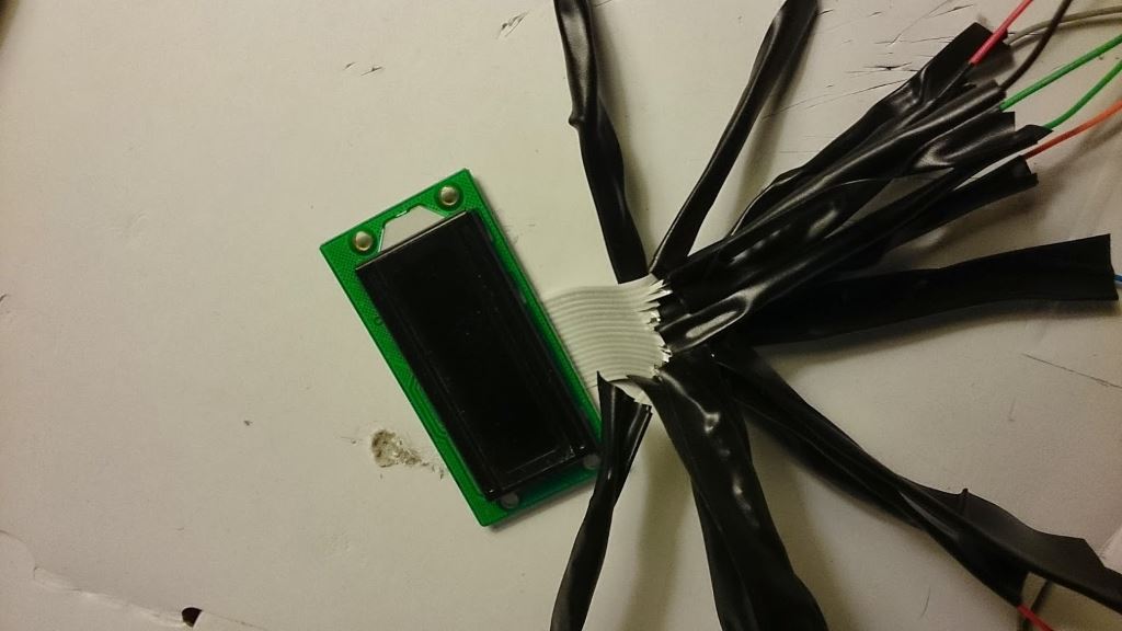

I got a display today, courtesy of UrSv 🙂)), that I'll be using to get things running until I get the one I've ordered.

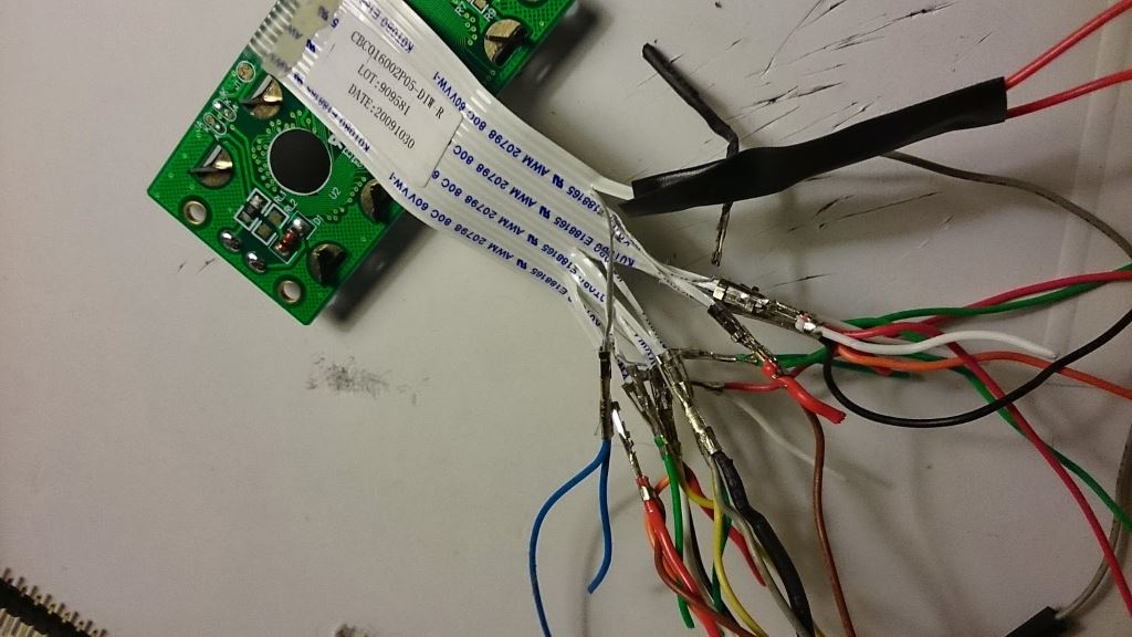

It came with a tiny ribbon cable for which I had no suitable connector. Fear not, I took a Stanley knife and started cutting carefully between the tiny conductors trying not to mess up too much of the isolating material. Not an easy feat when the isolating material is about as wide as the knife blade! After shredding the cable I clamped on wires scavenged from an old computer chassis, the kind that attaches front panel USB-connectors and audio IO to the main board (I believe they may be dupont standard? They fit nicely on the Najda headers in any case).
Next I clumsily added way too much electricians tape to isolate the bare metal connectors as well as the ribbon cable conductors as there were some bare parts where I cut it too close. Much later I realized I have lots of heat shrink tubing which would have worked a lot better here, oh well.

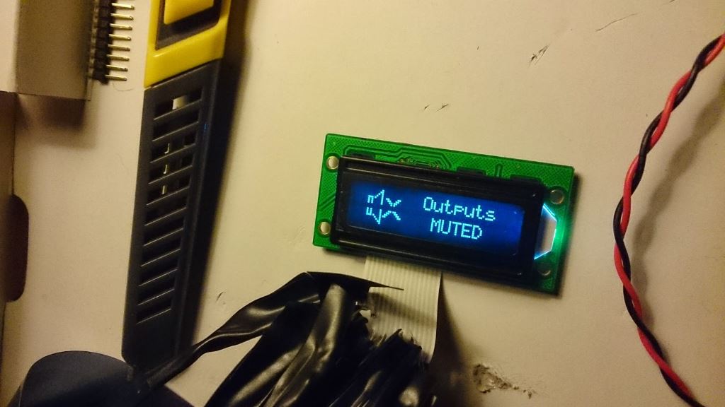

Step 3: Connect to Najda and start it up (I had previously started it up using a LED connected to the display backlight connectors as per Nick's suggestion earlier).
Ooops, that doesn't look right. Better disconnect and recheck for any possible shorts and make sure I connected all cables correctly.
Tada!
Here's a USB-memory to give a better scale reference. That's one tiny ribbon cable.
Here I've connected the IR-receiver in a similar manner. You can also see my multi function "button" in the form of that lone green wire. It's connected to ground on the button header and I simply touch it to the relevant pins to navigate the menus. Or rather, I did that before I looked around and found an old Yamaha amplifier remote with rotten batteries. After borrowing batteries from my gamepad I tried using the IR-learn function on the Najda, and luckily the remote used NEC-standard IR and I could successfully program it.
Now all that remains is to load the first program (all ready to be uploaded) and see if I can get some sound out of this too! To start with I'll be using the coaxial input, but the plan is to connect it to my Raspberry Pi via I2S.

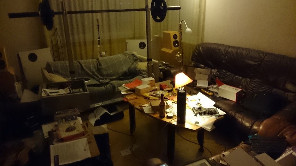

Here's a bonus shot of my workshop, ie living room, currently in quite a state 😀

Here's a supplier of VFD displays. Paid EUR 17.5, it's much cheaper than the Noritake model.
Keep in mind however that VFD drivers aren't fully compatible with HD44780 when it comes to custom characters. This is because the lower segment is a single line that can't be divided into points. I'll modify slightly the custom characters to go around this limitation (but still we'll end with 5x7 characters instead of 5x8 ones as in a fully compatible display).

Yay!
Thanks, Nick. What I've been waiting for.

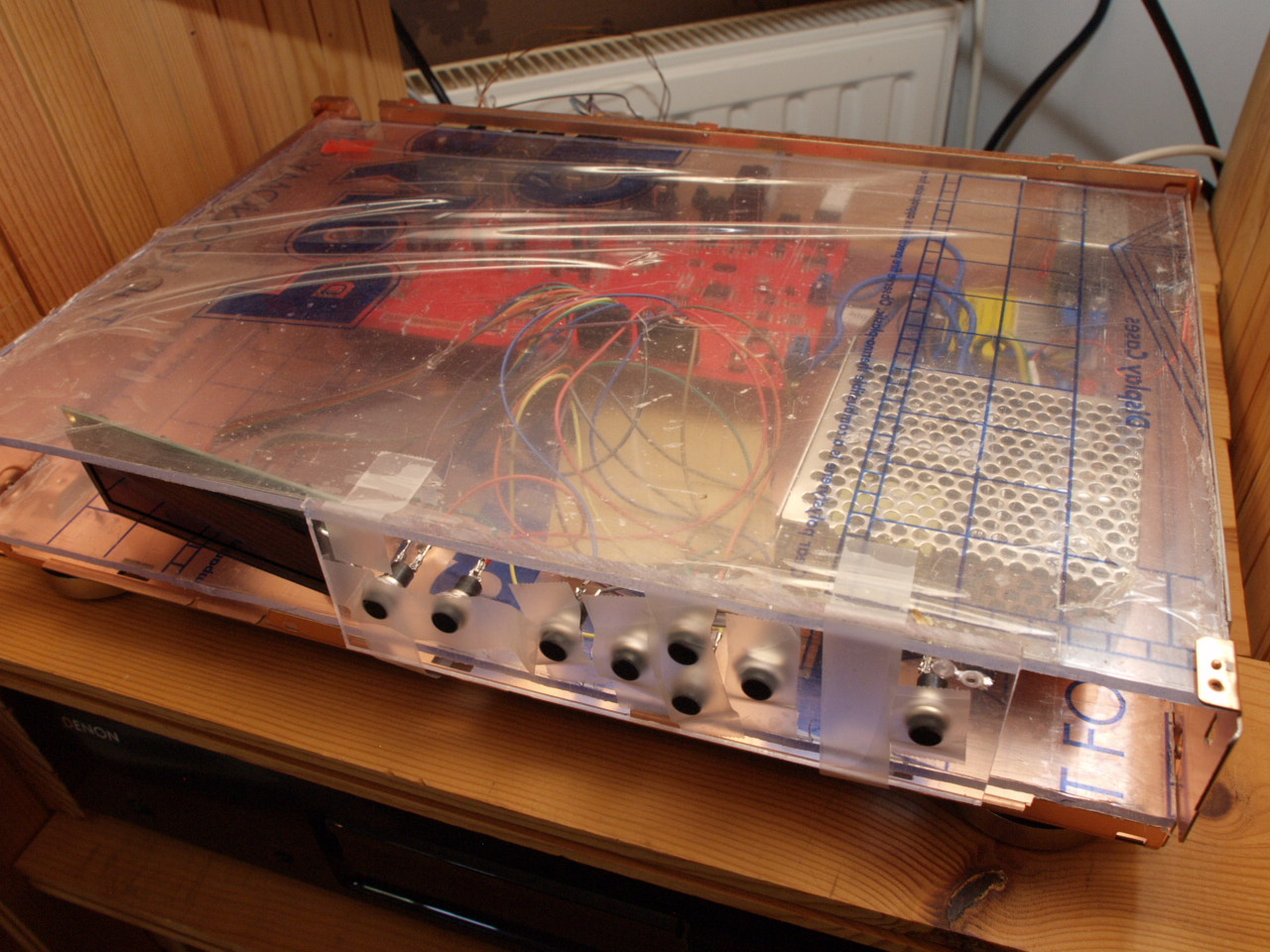

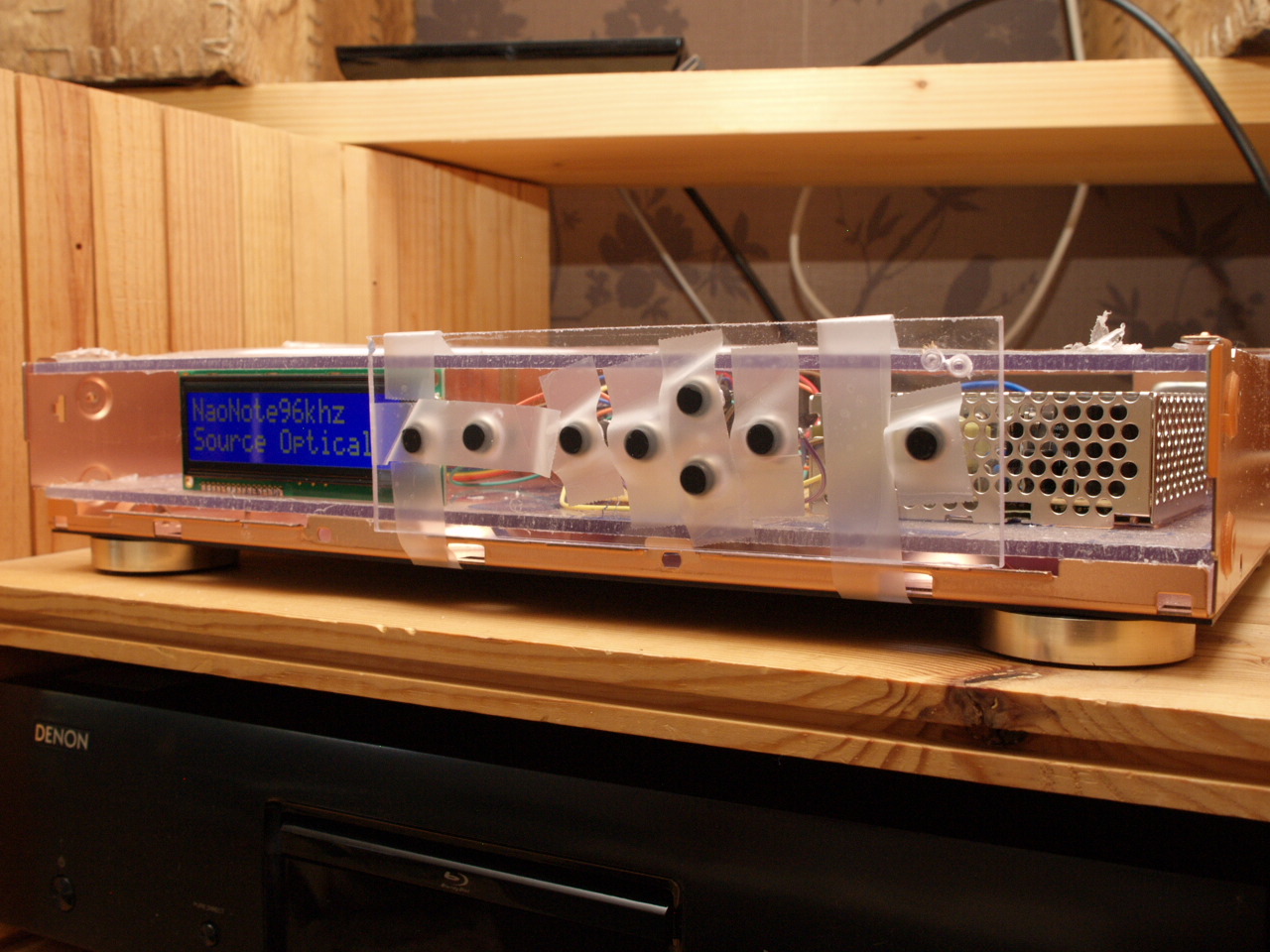

I'll try and post some pics of my build, though it is still in limbo while things get sorted, slooowly. Next to do;
- Connect Amanero USB board to Najda - I have no idea where to start🙁
- Hold out for expansion board (cost permitting😉) since it allows 5 way, and a I believe a better input sensitivity suitable for 2volts?
- Make a rear panel - the thread regarding a group buy seems to have stopped
- find different buttons, the ones I have are too shallow threaded for the acrylic I am using
- finish my speakers/amps - recently interested in Legacy Whisper XD speakers "compound woofers" - because I have a spare couple of alpha15s and sidewall proximity issues. These done properly would make a 5-way speaker since the second woofer should have a delay on it (a Harry Olsen theory originally).
OLED 2x16 Green Character Display | Maplin

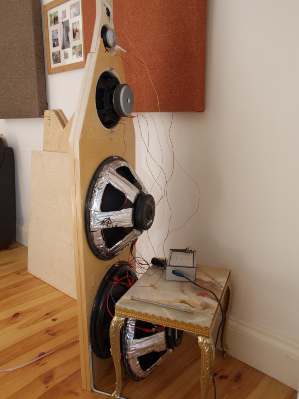

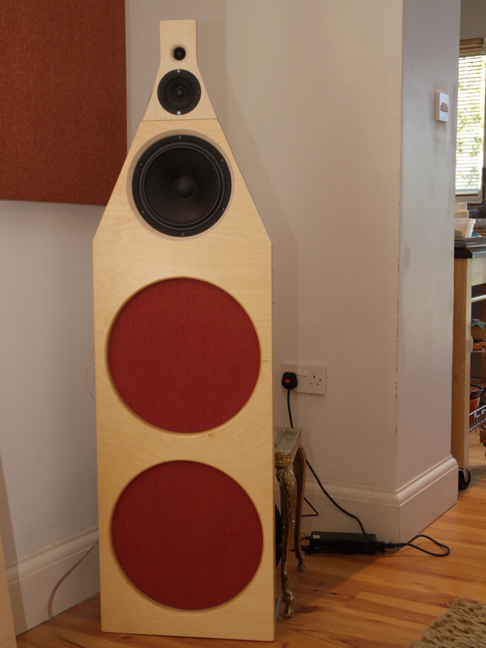

Speakers are Nao Note II - though with alpha15s on the bottom. The third 15" propped up under the side table is a Legacy Whisper XD experiment.
That´s a nice workshop.. 🙂Here's a bonus shot of my workshop, ie living room, currently in quite a state
OLED (WS0010)
Coming soon!

Hi Sigi,
All 3 references should be fine as they all iclude the same driver chip.
The first one, WEH001602ABPP5N00000, is the one I have myself.
The second one, WEH001602BBPP5N00000, is bigger and has a reversed pinout, which is probably easier to wire to the Najda.
The third one, WEH001602DBPP5N00001, is identical to the first reference except for the layout of the pins. These are indeed located on the side of the display (instead of above). It shouldn't be too hard to wire.
On their webpage, if you click on the 'Adobe' logo, you'll get the datasheet with the drawings of the part.
If you want a normal sized display, then I'd probably recommend the 3rd reference.
If you want a bigger display, then go for the second reference.
The first one is OK too, but in my experience not so cool to install because the wires are crossing in a X pattern. Well nothing too bad anyway 😉

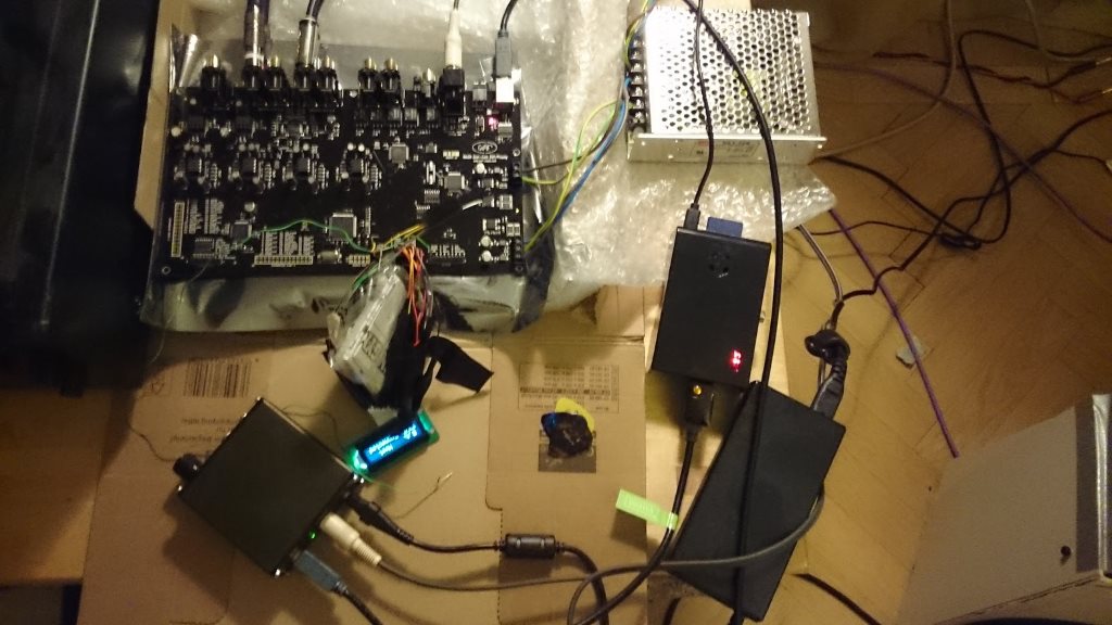

It works! I mean, it actually outputs sound 😀
Here's a blurry picture of my equipment chain apart from amps and speakers. From the Raspberry Pi via USB to a ESS Sabre32 DAC, which I use for coaxial S/PDIF output to the Najda. The raspberry streams FLAC-files from a NAS. Later I plan to go via I2S straight from the Raspberry Pi to the Najda.
Since I don't actually have enough amps for running active yet (as they haven't arrived), I'm using my Rotel RB-991 for the bass and going through my ancient Sony surround receiver that I normally use for my computer speakers (it's ancient, first gen. Pro Logic) for my full rangers. No pre-ins on this one, so it's through the normal inputs, through the entire amp via the volume control 🙂
The first draft of my EQ/crossover needs some adjustments, but it's close enough to sound great already. It sounds way too good for going through that mess of stuff to be honest. It can only get better though. As it is, I've been listening to music for a couple of hours and not messing with settings at all which is a good sign! 😀
To celebrate I drank some 18 year old Single Malt Whisky straight from the bottle😎
You can see part of the remote I'm using (for now) too.

Lots of pics here lately, that's great 🙂
That's actually pretty easy.
1. Sort out the power for the Amanero. Either USB powered or fed straight from the PSU if it can handle it (probably it can).
Don't power via the expansion port, the Amanero draws far too much current.
2. Refer to the StartUp Guide section I.6. Keep the wire run short and don't forget to tie IS_EXP1 to DGND.
3. Sit back and listen. Optionally, get yourself a drink 😉
