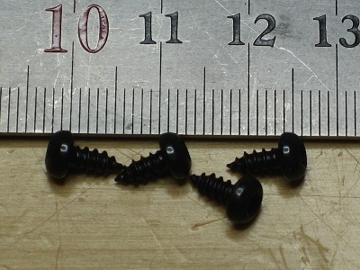

Screws for rear plate
at the moment I am using my Najda in a Hifi2000 slimline case without rear plate. The connectors of my RCA cables are quite tight and the Najda PCB bends when plugging in the cable connector to the Najda jacks. I fear that one time they might break off.
I am going to use the 3mm rear plate to secure the Najda RCA jacks.
The appendix says the RCA jacks have a 2.4mm mounting hole. However, I did not find 2.4mm screws anywhere.
To those who already build a case:
What screws are you using for securing the Najda RCA jacks to the rear plate?
Thanks!
Uwe

@Urban: Could you tell us what screws you have used for securing the connectors to the rear panel on your (great) build?
I use a self-threading T10 "cheese head" screw that's roughly 6 mm in length. It's commonly used for 2-3 mm panels in lots of stuff and was sourced from a company that coincidently makes audio equipment with 2-3 mm panels using PCB mount RCA jacks very similar to the ones on the Najda board. 15 years ago. I started planning my Najda build quite early you see. I probably have a hundred or so left in case you need a few.
