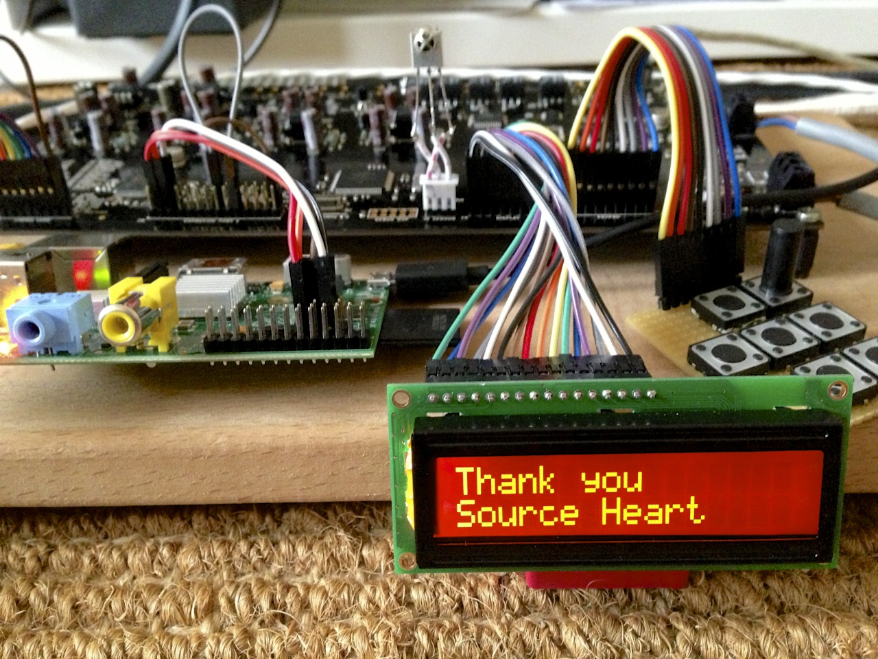

Hey a first black one out there!
(I first wondered: How did Abel manage that on the LCD? 😉 )
Hello, is this display an oled? If so, where did you get it?
Best regards
Sigi
Hi Sigi,
it's a cheap 4€ LCD from here:
LCD Display 480x240 Graphical 3 in one Blue White RED Artikel im zyscom Shop bei eBay!
Abel
Abel
