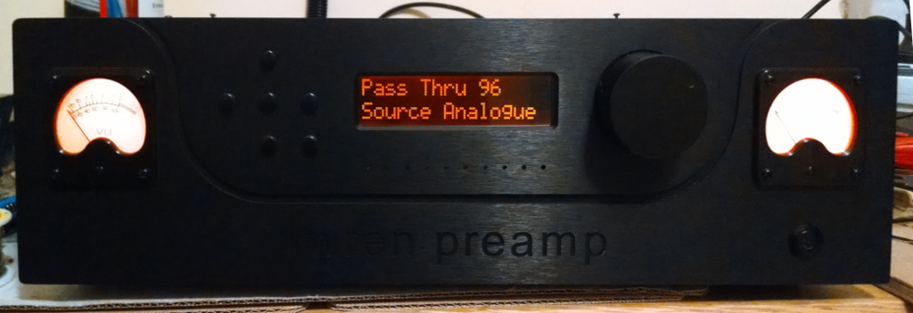

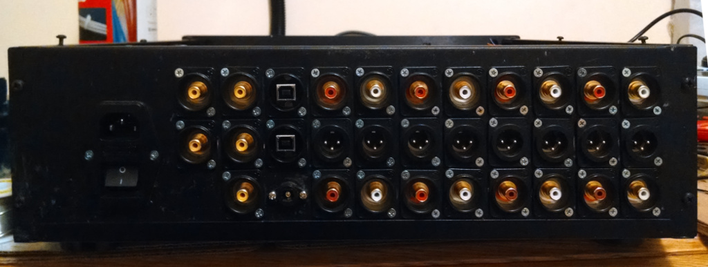

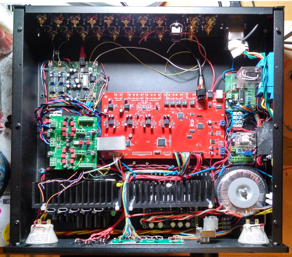

Guys, I thought it was about time I uploaded some photos of my progress
It's a Nadja where I'm using external ADC, DAC, volume control and have spent effort (and money) on trying to get good results to both my ears and eyes.
Case is built to my spec by modu.
DAC is twisted pair buffalo.
ADC is beis.
Power supplies are JLM kraftwerk.
Transformers (2) from tortech.
Connectors from neutrik.
Motorised volume and VU driver circuits are nothing fancy.
VU meters look pretty.
LCD is the biggest I could find online.
Power supplies took some time as there's separate supplies for analog and digital devices; each of which has 5 (3+ve, 2-ve) rails for a total of 10 regulated rails. I divided those based on not polluting the most important supplies (ADC + DAC).
I'm really, really, really, really slow when I work but I think tonight marks the point when all my power supply, control and indication cabling is done. Now I just need to do signal cables which are a pain because they're all silver/teflon and hard to strip.
Can't wait until this thing is finished!

So I went back to the previous LCD. Light comes on, buttons work, but no dialogue displays.
Is there some way to reset everything? Can I go back to the previous firmware?
Nick, any thoughts on this?
Hi Sean,
i'm afraid that rolling back software is not going to solve your issue. Pretty sure about it.
Now that you've installed the LCD back, you must set this in NUC again. Have you done that?
If you have, then it's probably the wiring. A short somewhere, could be? Check the wiring for shorts and continuity with your meter (beep).
Hope this helps
Nick

Yes, changed the menus setting but no luck. I'll check the wiring again for issues.
Things like shorts or bad connections would not cause the strange graphics I showed photos of would they? You did suggest a "bad initialisation" before. What is the solution for such a thing normally?
Hard to say what bad connections would cause on the display - most likely a blank display.
When you intend to use a display in a system, it has to be initialized - i.e. the micro must send some commands initially. Which commands exactly, that depends on the display model. The pics of the OLED you've posted somehow reminded me of what I've seen when the initialization routine is not appropriate. But it could also be anything.
The solution for you is having your LCD working first, as it was before. Take your time and calmly inspect the wiring with a meter. Make sure you pull off the power chord before you touch any part of your build.
I am going to try the Najda. As far as the power supply I saw the posted options:
Any reason why I need to choose anything over the "RT-50B Mean Well?
Does it influence the sound quality? If so, than I'd rather get one that has the best sound quality (if the PS matters there)
Please let me know your recommendations.
Thank you,
Herman
Thank you,
Herman
I don't like the Mean Well models too much because they have a high requirement in terms of minimal load. The Najda uses pretty little current; the Mean Well PSUs want to output more than 0.5 A on the 5V line in order to regulate. So if you're set to use this power supply, you should consider dummy loads - which is not elegant.
The TDK MTW line seems better suited.
The smaller and the larger models have no minimal load requirement at all.
The intermediary model (MTW30-51212) should output at least 0.5 A on the 5V line in order to have the +/- 12 V properly regulated. This is less of a concern because all the sensitive devices that are powered from these rails are buffered with an onboard regulator.
The PSU I use is the Skynet SNP-9021-1. This one has no minimal load requirement either.

You will need at least 2 AC Transformers, then make rectification for 5, 12 -12 Volt, and last not least a good regulating shunt or series regulator for each supply.
Send me an e-mail if you need more details
Regards
Sigi
I use the JLM Audio Kraftwerk to supply my Nadja. It's a Linear PSU kit that generates 3 positive and 2 negative voltage rails from a single transformer. It's designed to be used with microphone pre-amps, so one of the positive rails has a voltage doubler/tripler on it (to get to +48v) which makes that rail useless for Nadja. Still though, you get the +12v, +5v and -12v needed for Nadja from a single 12-0-12 transformer. Or probably any transformer between about 6-0-6 and 18-0-18 (yay for regulators!)What parts will I need to build a Najda linear power supply?
It's cheaper to get a switching PSU and there may be cheaper linear supplies out there but I'm happy with the kraftwerk kit. JLM have another almost identical kit (can't remember name) with 5 rails that I've also used but went with the premium kraftwerk kit because.... well, why not?
