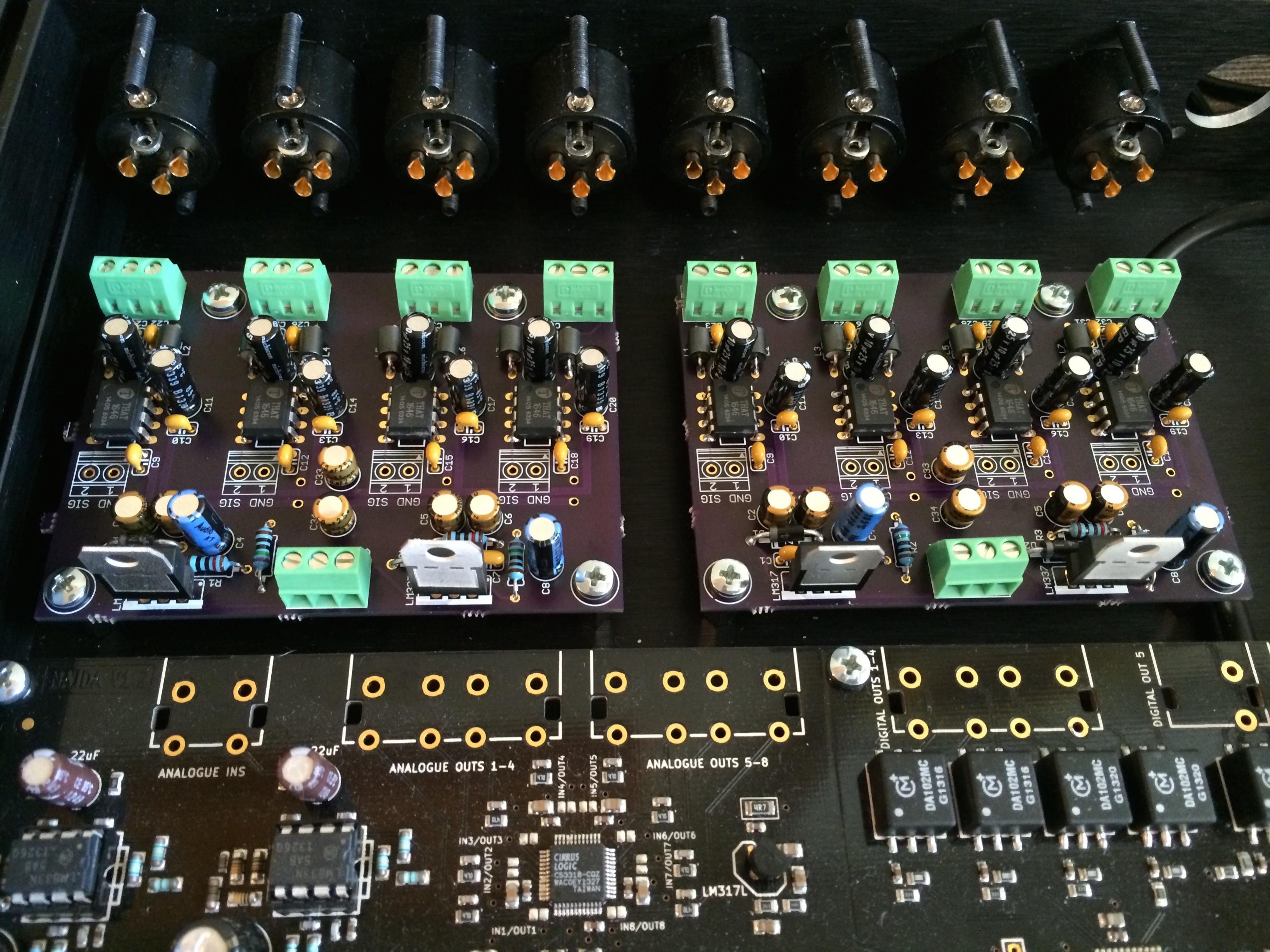

Yes, I will the AES-48 standard. Pin1 and the shield will be shorted and connected to the chassis. This is done on the SE/BAL boards, making a "shield plane" (separate from the gnd plane) on these boards part of the chassis.

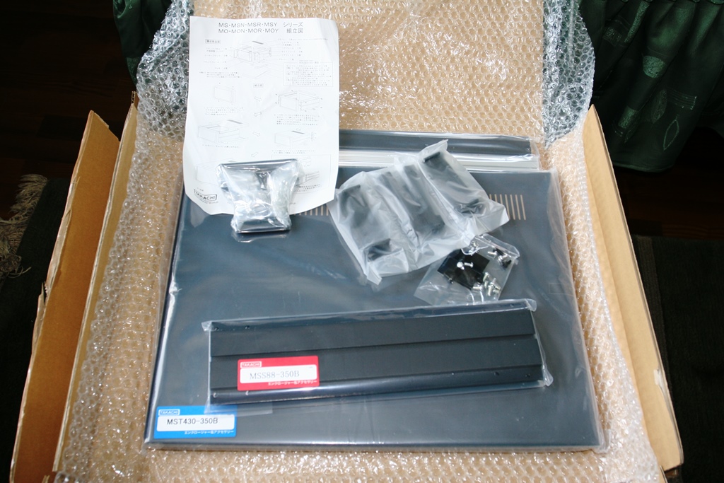

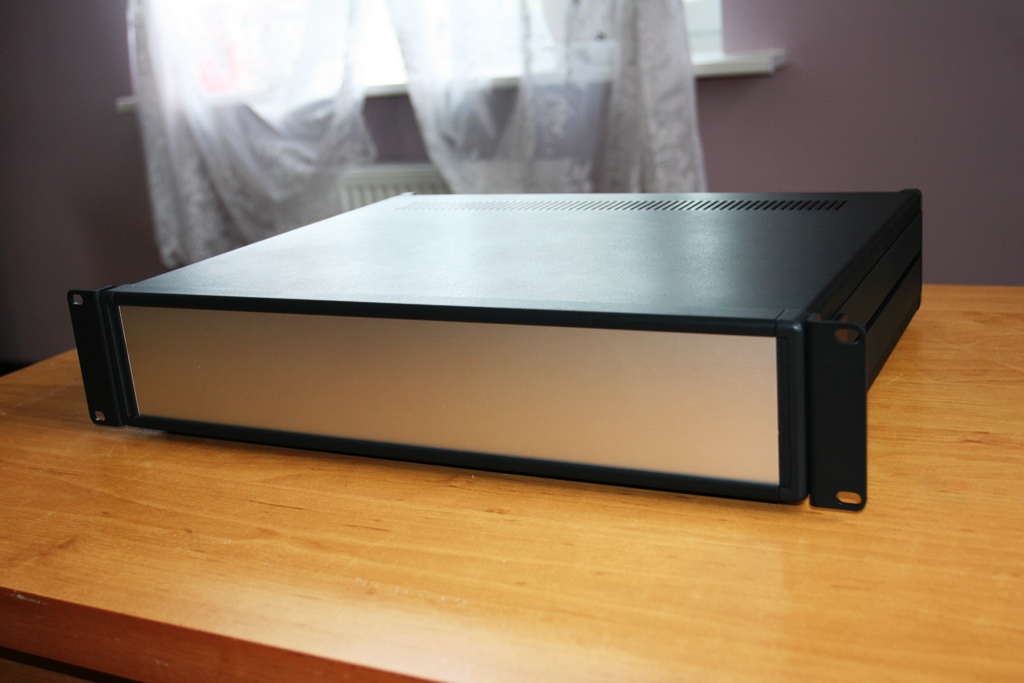

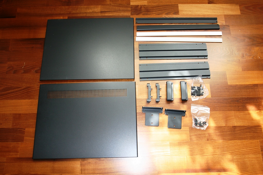

That´s a nice enclosure.may I ask what the price is?Hello, Najda fans!
Today I've got my enclousure from Takachi, Japan. Very good made and easy to assemble. Still waiting for the other parts.
And shipping cost?
Hi Ryssen!That´s a nice enclosure.may I ask what the price is?
And shipping cost?
The enclosure is MSR88-43-35BS
http://www.takachi-enclosure.com/data/c1213/c_en_p165-169.pdf
The price is $101.64 USD and freight charge EMS (express) was $108.00 to my address.

Since you like pictures Nick, I will post another.
I have populated the BAL/SE boards (almost - I forgot to order the input connectors.. )
Anyhow - at least it looks nice. I think the design is solid, so if these don´t work it´s probably because I made a mistake in soldering or ordered the wrong parts. Lets see how it goes when I power them up.
