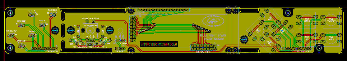

I got the final invoices for the front control board, so I have pricing information. The PCB alone will be only EUR 12. Hopefully I can slip it into an envelope with some cardboard and get decent shipping costs (letter format). PCB size is 260 x 36 mm.
There's been a lot of mechanical work on this board. Note the strange shape is to make space for mounting brackets, should you need that.
The full option is EUR 45. This includes a OLED display (white text), push-buttons with black round caps, transparent round leds with colour when they light on, Vishay IR sensor 38 kHz, Bourns all metal rotary encoder with central push for mute plus the filter discrete components (4 resistors and 2 caps) and a black "aluminum" 30x19mm knob, plus all cables and screws/bolts.
Full option will be delivered unassembled, so you're going to need a soldering iron if you choose this option. Nothing complicated.
I'll post pictures early July. It's nice 😉

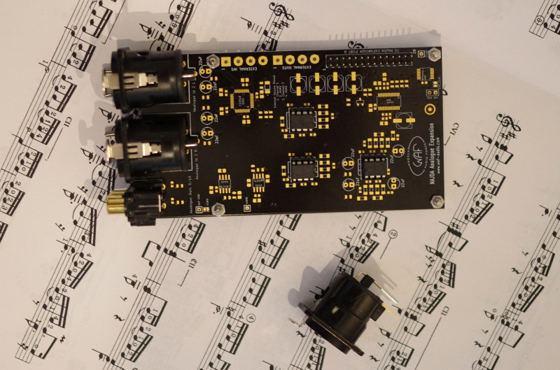

Hi Ake,
The analogue expansion has:
- Balanced stereo input with adjustable input gain
- 2 unbalanced outputs with analogue volume (that's for outs 9/10)
- Volume control on 2 external channels
Nick

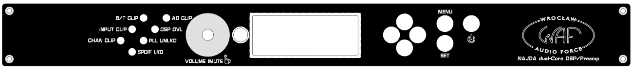

Hi Nick,
What display size will fit your front control board? How soon the board (full options and PCB alone) will be available for order?
Mike
Mike
Hi Mike,
The display should be 80x36 or 85x36 mm.
The PCB alone will be available on next Tuesday.
