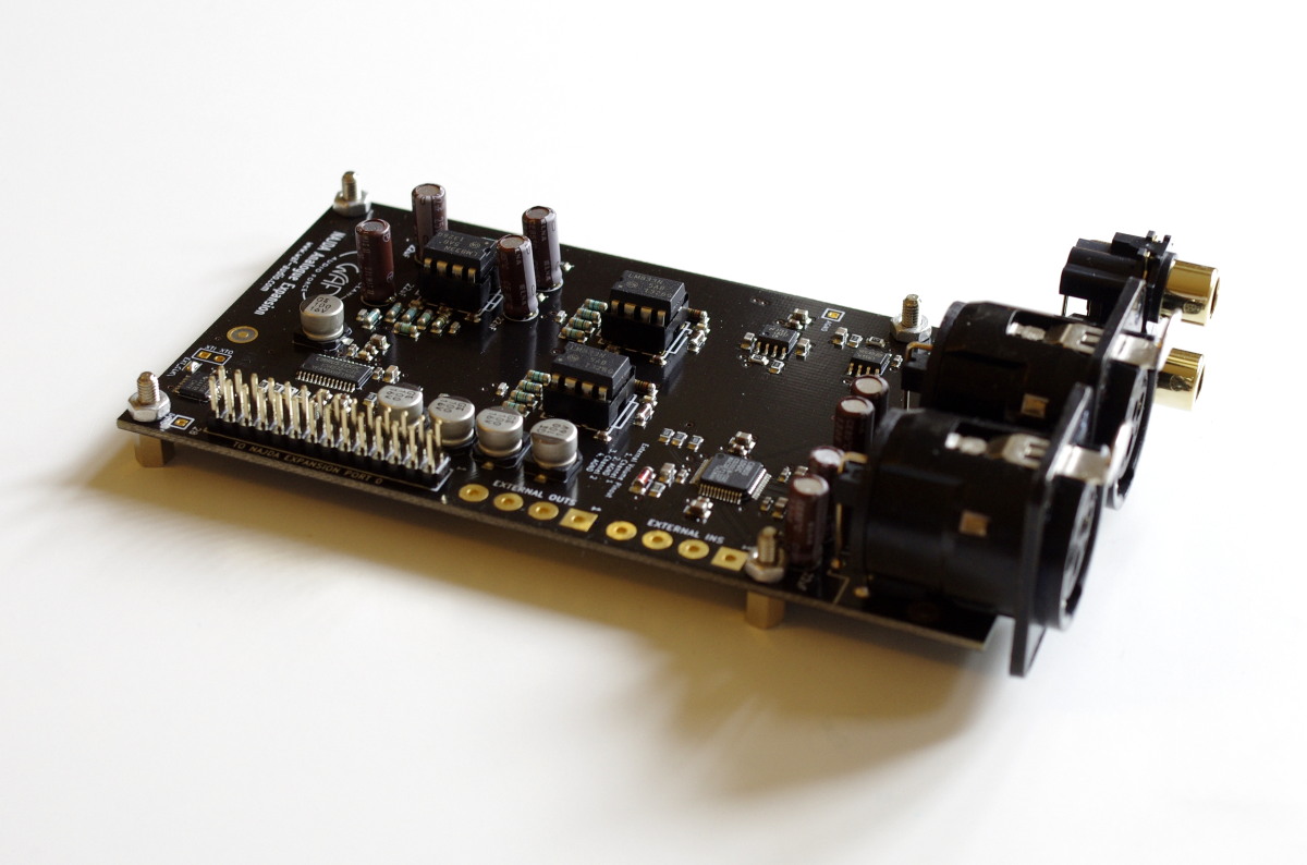

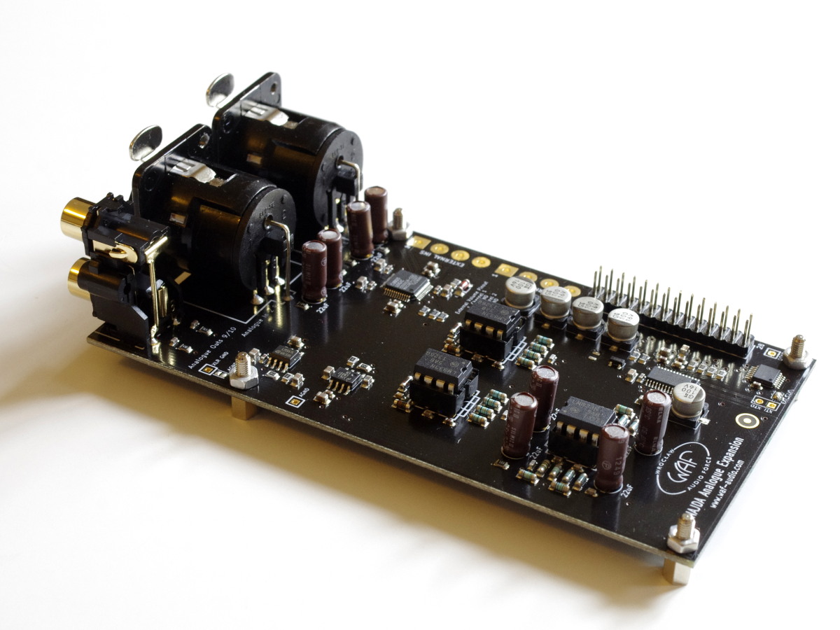

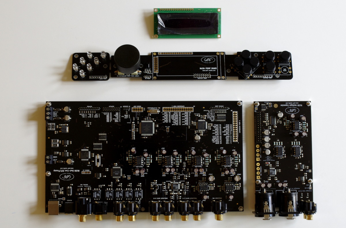

I've just received the assembled analogue expansion boards. Lots of hardware coming in lately, I can't wait until I can do some software again ;)
It's time for a family picture ;)
Hi Uwe,
Yes, the analogue expansion connects to Expansion Port 0. Expansion Port 1 is unaffected and the I2S input remains available.
So, to clarify, with the analogue expansion you have 5 input sources:
- Analogue unbalanced 1 Vrms
- Analogue balanced with adustable input level
- SPDIF coax
- SPDIF optical
- External I2S
In terms of outputs, you get in total 10 channels with analogue volume and adjustable output level.
There's also provision for controlling the volume on 2 external channels (no processing on those channels, all analogue path).

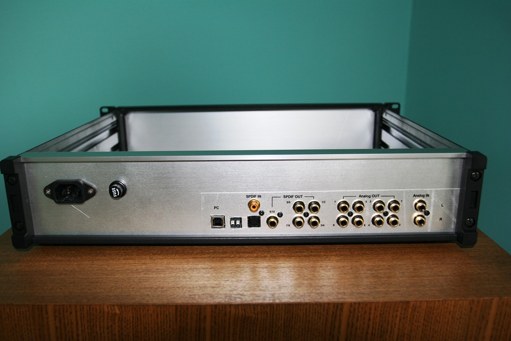

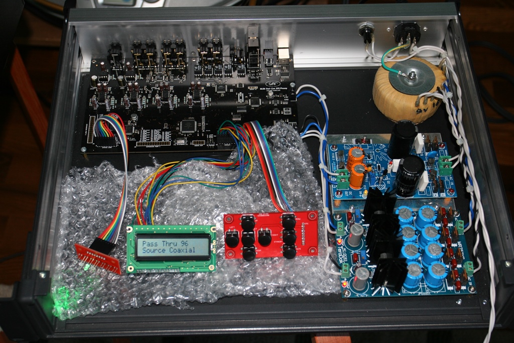

Hello all!
Today was my first sound check :) My first power on check was not OK because I've got bad display from China :( Then I bought new one made in Russia and also few days ago I received nice PCB for the front panel from Urban (aka UrSv) and I was able to turn my Najda ON. Everything is fine except MUTE button does not working (why?). I connected my CD player to analog input and I've got clipping :) OK, nothing to worry because my analog source (vinil) has volume control in phono stage. Then I connected SPDIF output of my CD player to SPDIF coax input - all OK! Now I have to finish my front panel and I will start big work with my 4-way speakers :)
Hi Mike!
That looks very nice and tidy! Can we also see the rear panel? :)
For the mute button, check continuity of your wiring, from the push to the capacitor just behind the pin headers on the Najda board. Then check also that this line is pulled to GND when you press the button.
(Turn power off and unplug the power chord before you do that :) )
Cheers and thanks for the pic
Nick

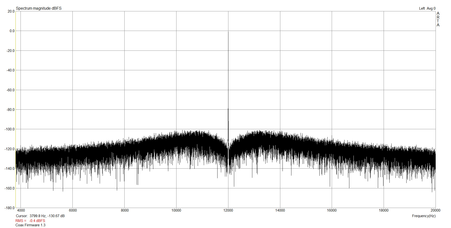

Jitter: I2S worse than coax
I experimented with a Raspberry Pi with Picoreplayer (https://sites.google.com/site/picoreplayer/home).
I have two Raspberrys, one I connected via I2S to Najda. For the other Raspberry, I have a Hifiberry Digi (HiFiBerry Digi - SPDIF/Toslink output for the Raspberry Pi | HiFiBerry - High quality Raspberry Pi Audio) add-on and connected it via coax to Najda.
For both, I did Jitter Tests. Surprising Result: The Hifiberry Pi connected with coax has considerably less jitter than the Raspberry connected via I2S.
My test setup:
- With ARTA I generated a 24bit/48kHz J-Test Jitter signal. (This is an undithered 12kHZ sine modulated with a 250Hz Square wave of amplitude 1 bit (only LSB changes).
- I copied the test signal file to my NAS/Logitech Media Server.
- Najda was set to 48KHz Passthrough
- 2 Najda analog outputs were connected to my RME Fireface soundcard (which has a noise floor of -140 dB)
- I streamed then the jitter signal file to the Pi
- With ARTA I did an FFT spectrum analysis of the signal.
So the Path is
NAS/LMS -> via Ethernet cable -> PI with Picoreplayer -> Najda -> analog RCA cable -> RME soundcard -> PC with ARTA.

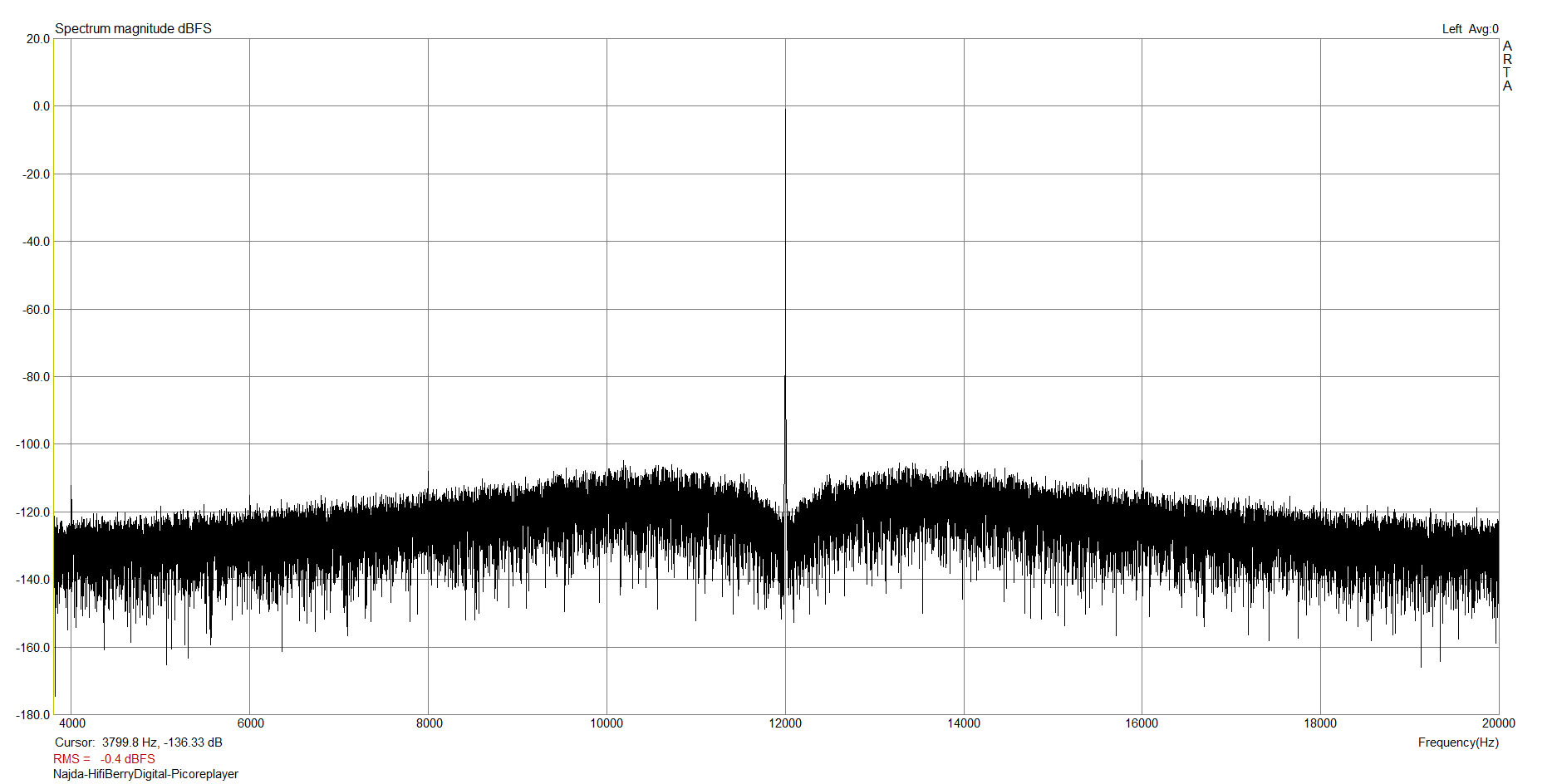

1. Raspberry Pi with PicorePlayer and Hifiberry Digi connected via SPDIF/coax to Najda
You can see the jitter spectrum in the picture. The jitter spectrum has almost no spikes and the noise floor is in the region of -110dB or below. That is a solid performance. Jitter should not be audible.

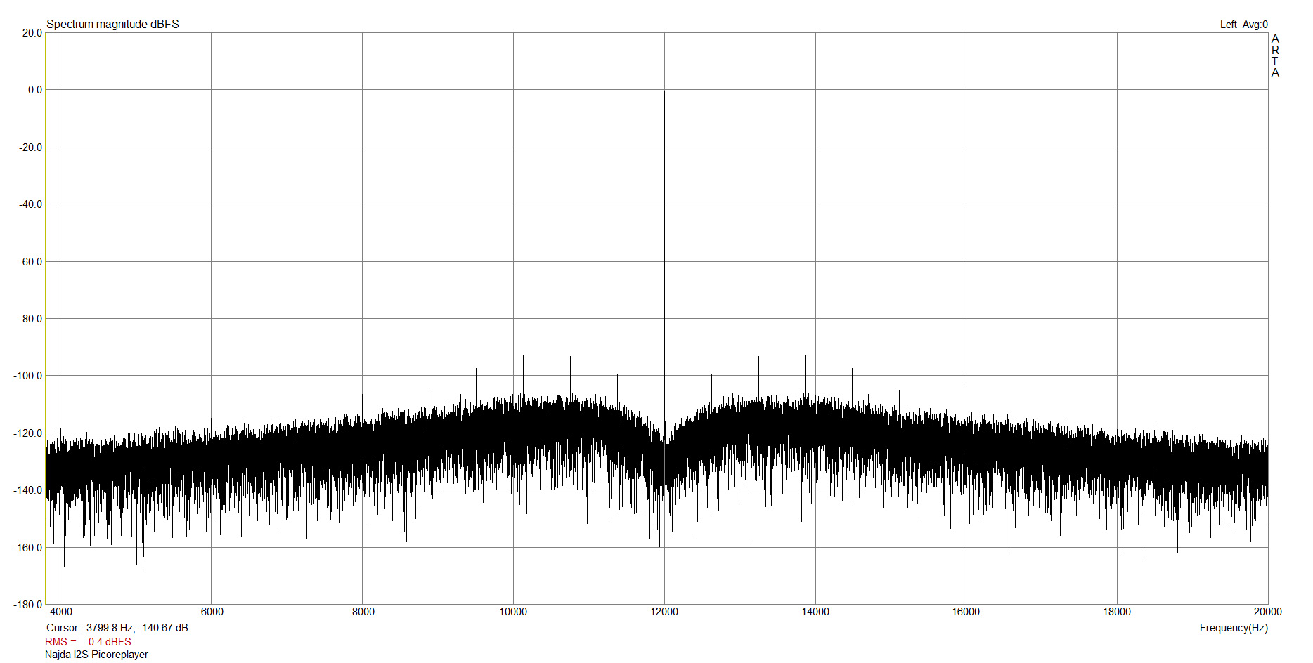

2. Raspberry Pi connected via I2S to Najda
The noise floor of the jitter spectrum is very similar to the previous. However, there are spikes going up to about -90dB. The spikes are equidistant and about 623Hz apart. Because of the spikes the jitter noise is about 20dB higher than with the PI/HifiBerryDigi.
I was surprised because I thought that the I2S connection was less jitter prone than an SPDIF coax.

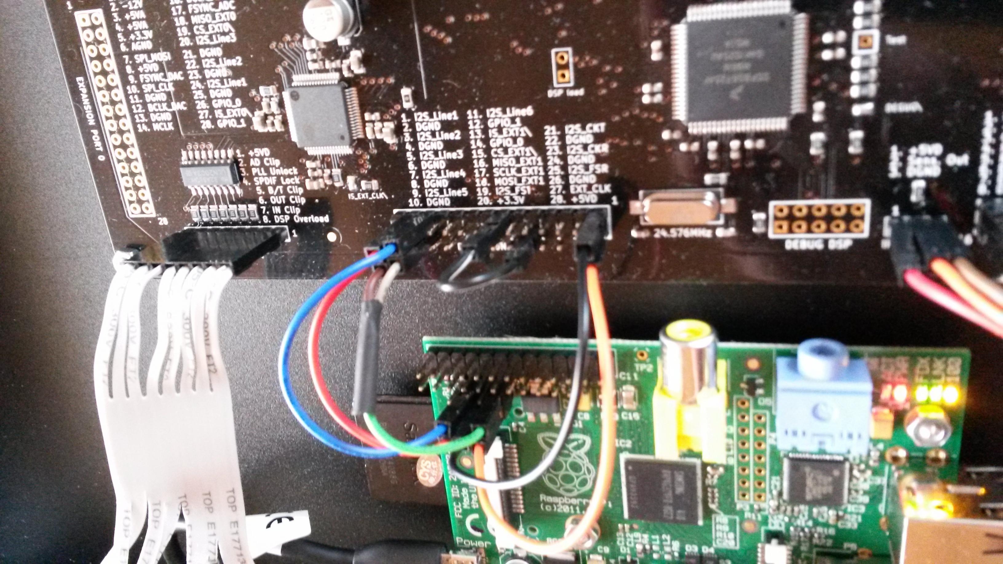

Here are some details on my I2S connections:
I use short cables (less than 10cm) for the I2S connections.
I connected
PI ---------------------------- Najda
pin 3 PCM_CLK=BCK_______________pin 23 I2S_CKR
pin 4 PCM_FS=LRCK_______________pin 25 I2S_FSR
pin 6 PCM_DOUT=DATA____________pin 1 I2S_Line1
pin 7 GND_______________________pin 24 and pin 26 for DGND (Y-cable)
pin 8 GND_______________________pin 2 for DGND
The power of the Pi I take from the +5V power of the Najda supply.

Anyone having an idea why in my case I2S jitter is higher than the SPDIF jitter?
Uwe

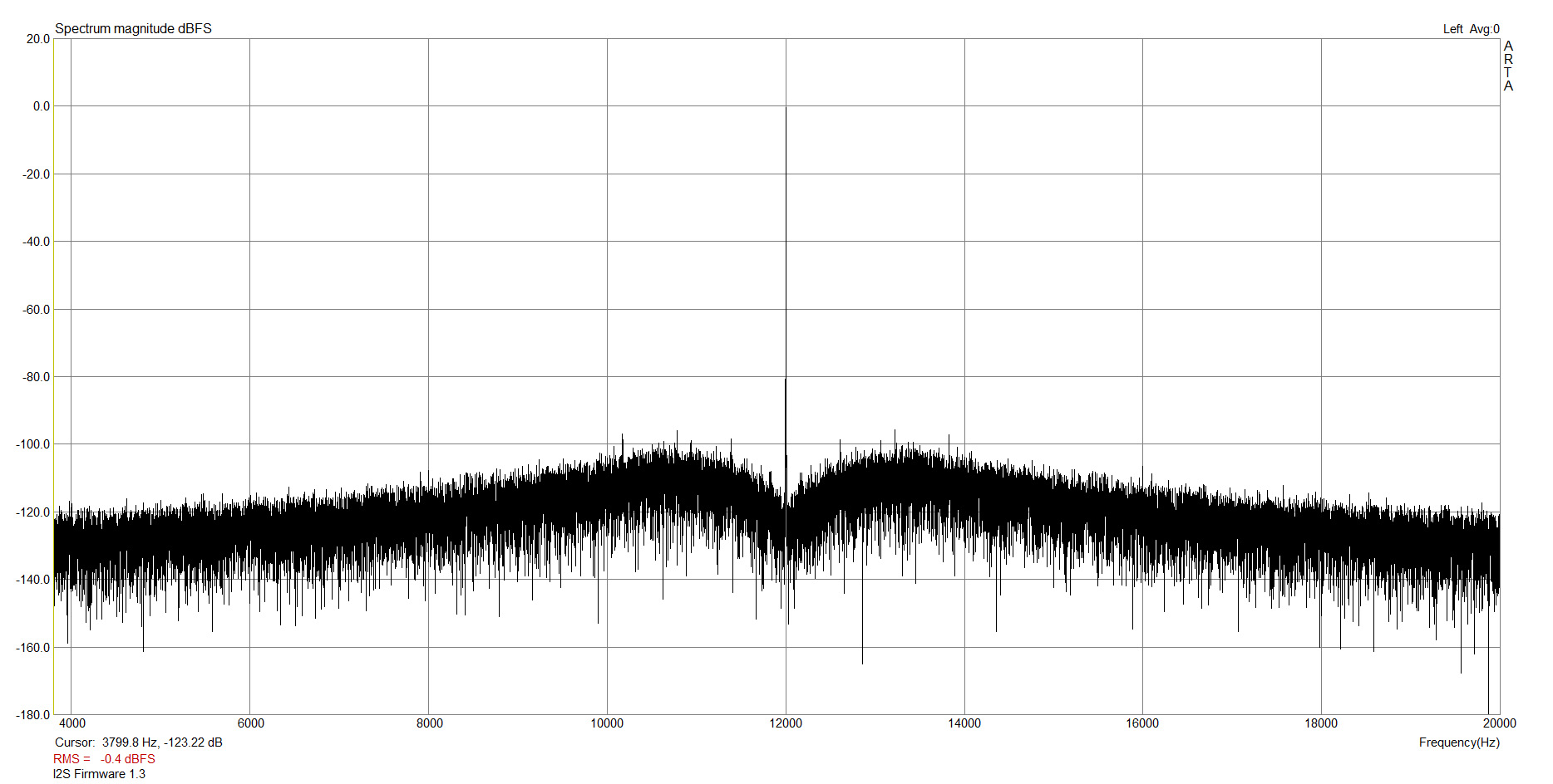

Strange things going on ...
I noticed that I still used NUC 1.1.0 with Firmware 1.2.
I upgraded to NUC 1.1.2 with Firmware 1.3.
I used the same setup, did the same measurements. The results changed.
1. The noise floor with Firmware 1.3 is a bit higher
2. The spikes of the I2S are lower.
I repeated the measurements with Firmware 1.2 several times with consistent results. Also with Firmware 1.3 I get reproducable results.
It seems that changes in the Firmware can easily have effects on the jitter.
Uwe

Hi Uwe,
Thanks for sharing your measurements.
The only difference between firmwares v.1.2 and v.1.3 is the display routine in the microcontroller code. DSP code is unchanged and the microcontroller doesn't see audio.
As a consequence you cannot assert that firmware update has impacted performance, that's totally impossible. I'm not questioning your measurements, but I'm refuting your conclusion.
Cheers
Nick

Hi Uwe,
No problem at all, your approach to measurements in order to optimize a system is a healthy approach. I was only noting that firmware upgrade cannot be the cause of a measured decrease in performance because there's no change on the signal path.
There could be side effects. For example, when you update firmware, you reset all hardware settings. This includes bass/treble and analogue output level. Hm, that's all I can think of for now.
Another cause could be a slightly different measurement setup. Have you pulled off the USB chord after you updated the firmware?
Coming back now to your original question. The SPDIF and the I2S are similar in the sense both incoming signals pass through identical sample rate converters with same configuration parameters. The main difference is that the SPDIF path includes additional SPDIF encoding and decoding stages.
What you can try on your side is to make as clean as possible connections between the Najda and the rPi. In particular, keep the ground return wire close to the signal wire.
On my side I'll check if we can increase the FIFO length of the sample rate converter.
