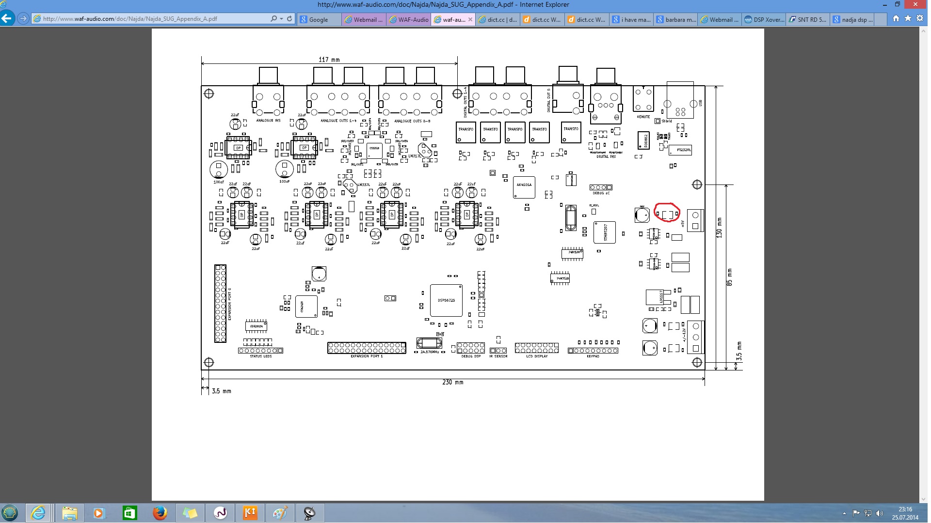

Hi Nick!Hi Mike!
For the mute button, check continuity of your wiring, from the push to the capacitor just behind the pin headers on the Najda board. Then check also that this line is pulled to GND when you press the button.
Nick
I checked all connections and all is fine. Also I checked capacitor with my LCR-meter. The capacitance is the same as the others. No idea what to check more.
Mike

The next step would be a bus isolator. One of those chips would do the job nicely: ADUM1310BWRZ or IL715 if you intend to play 192 kHz sample rate files on the rPi.
Don't worry about capacitors, they're here only for debouncing the push.
Well that leaves only one thing: the pin of the micro.
Please inspect visually pin 36 of the STM8S207, the Mute button is tied to that pin. See if there's a short with the surrounding pins or a bad contact to the pad on the PCB.
You can also do a continuity test to that pin: it must be pulled to GND when you press the Mute button (do that after you have switched the unit off and pulled off the power chord).
