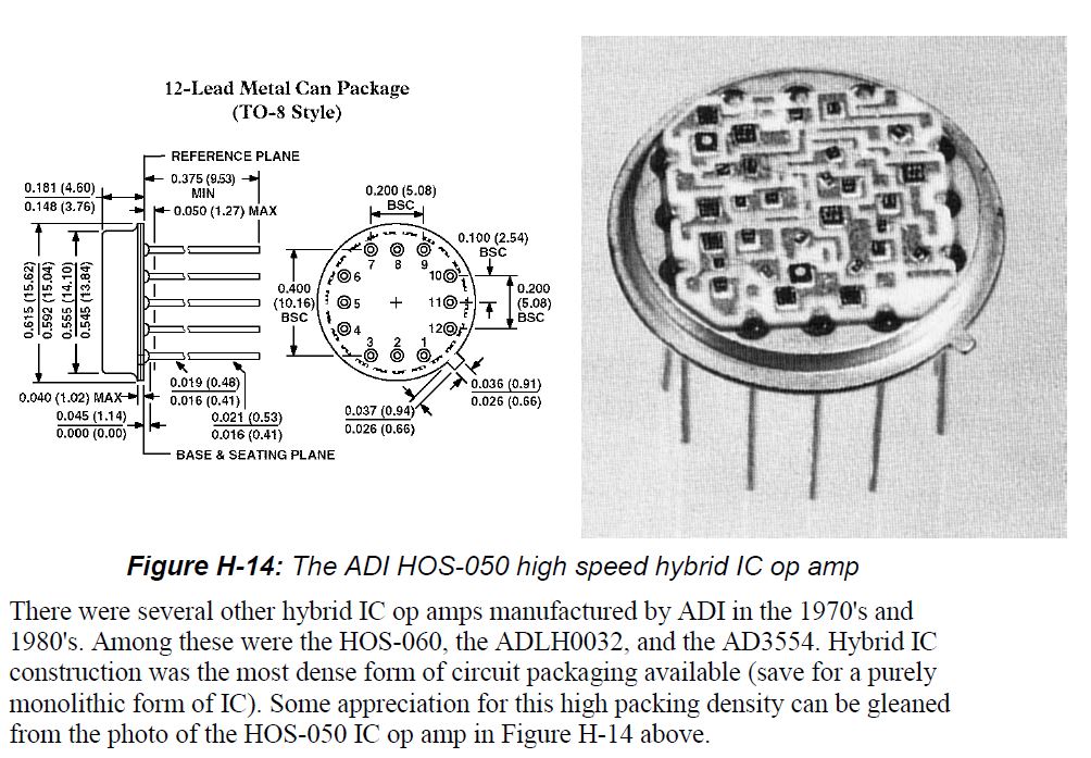

The NE5532 IC came out in 1979 & TL072 in 1978, so before that in HiFi audio low level signal chain one would need to use Hybrid IC or Discrete amps. Hybrid ICs were a big business in the 1970s and 1980s

Douglas Self, 2011..."For a period of at least 5 years, roughly from 1972 to 1977, the only way to obtain good performance in a preamp was to stick with discrete transistor Class-A circuitry, and this became recognized as a mark of high quality. The advent of the TL072 and the 5532 changed this situation completely, but there is still marketing cachet to be gained from a discrete design."
OpAmp History: www.analog.com/media/en/training-seminars/design-handbooks/Op-Amp-Applications/SectionH.pdf
