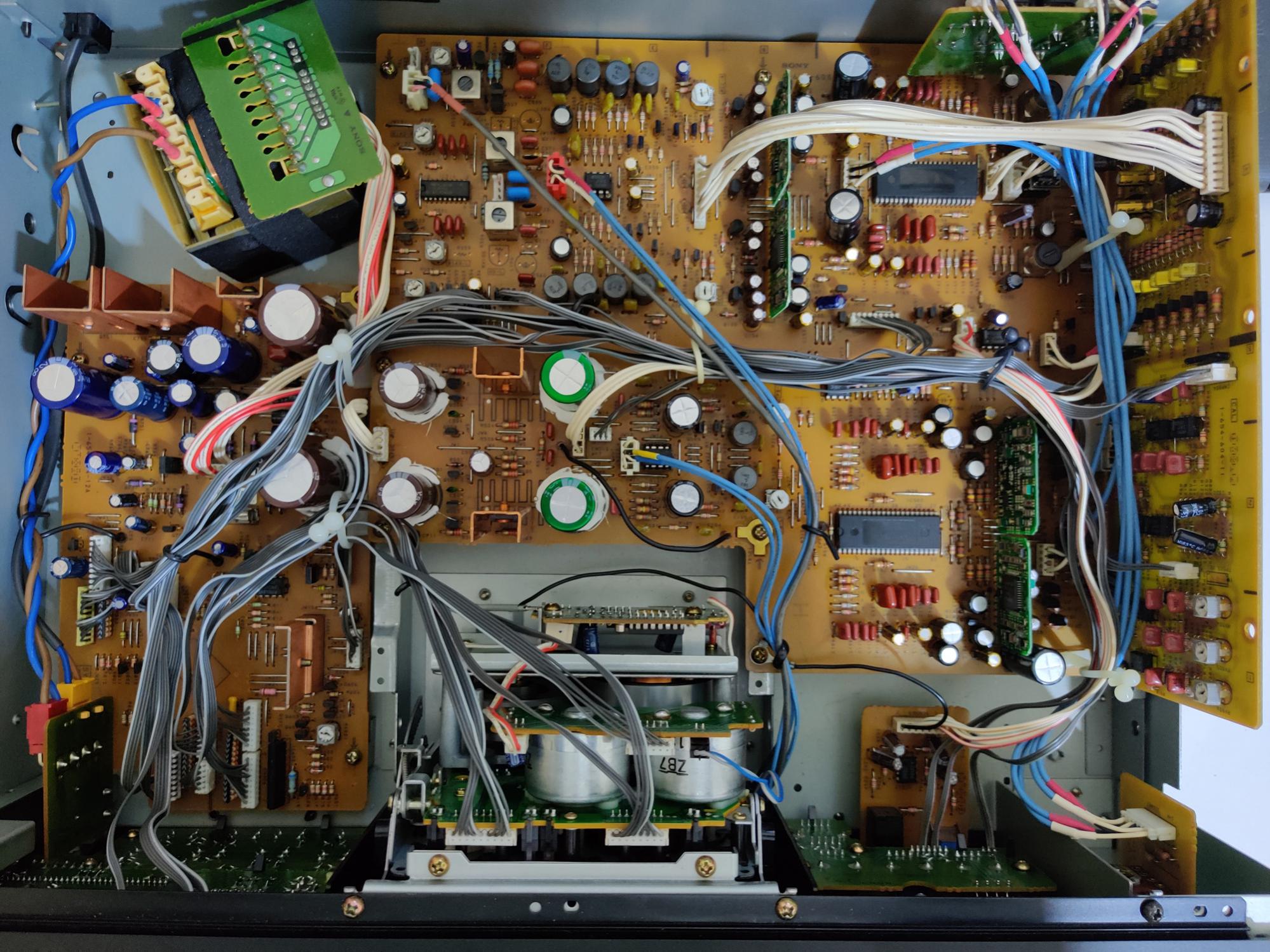

Was still holding for non intrusive hiss with the ADA4075-2 (1.2pArtHz), until with the ADA4898-2 (2.4pArtHz) it started to appear. Although with the OPA2228 (0.4pArtHz) things were quietest and tonally lush, there was also some lack of snap in the treble I thought. OPA2156 CMOS was doing a fine job also, although kind of dark in the pb position. But did a great job as rec input buffer. OPA1642 and ADA4625-2 JFET types were good in the pb head amp position too but kinda cold in details tone.
*0.1uF cross rails decoupling film caps were installed under all op-amp positions. All signal path back to back polar caps were replaced with modern Nichicon bipolars. Polar UKZ UFG used in other places too. Muting transistors negative bias headroom mod was also done.

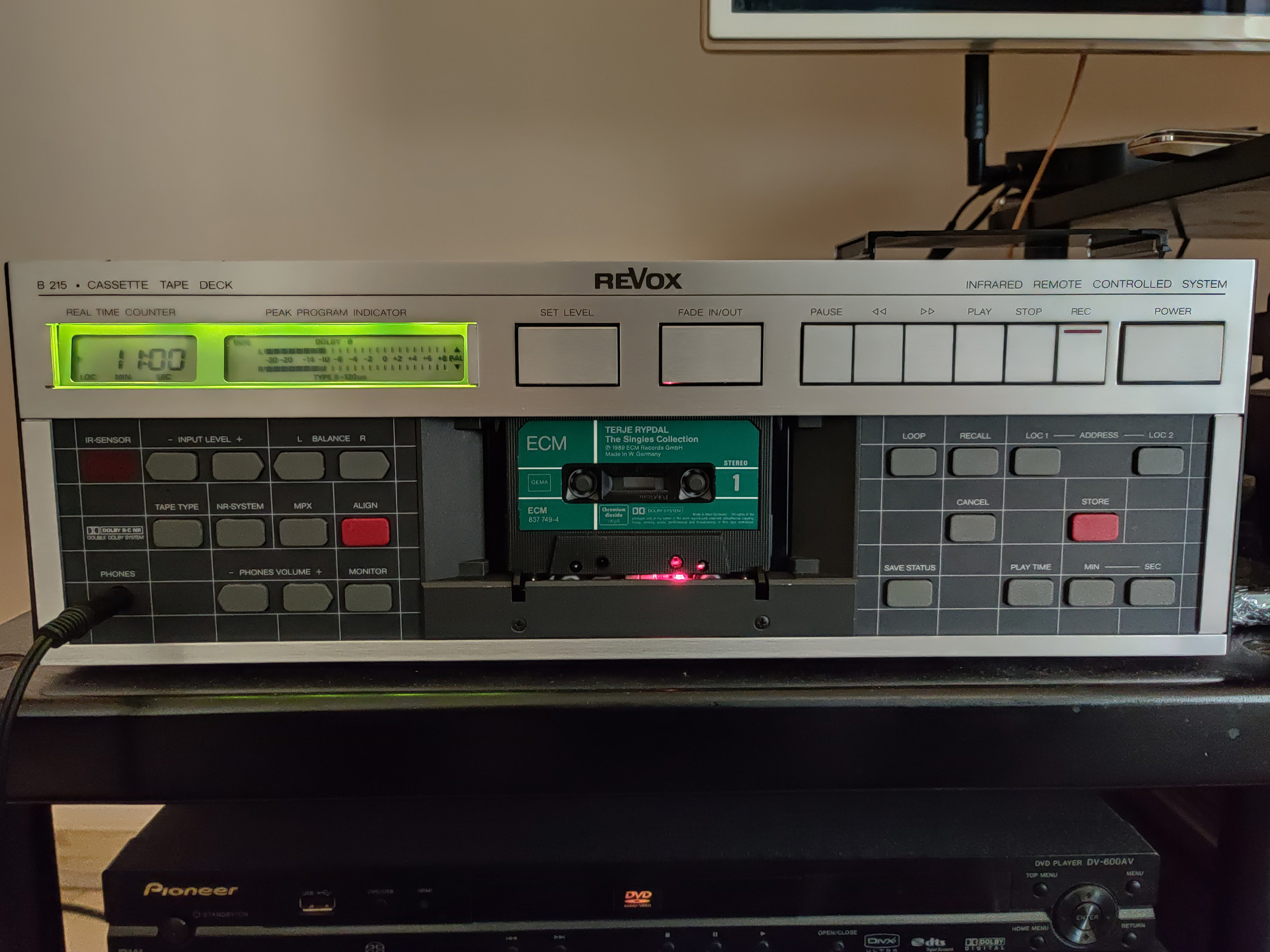

I used the OPA2227 as output amp in the KA6ES. Its doing a good job there. Decks are complex systems with many synergies and some surprise preferences may occur. Mechanical issues and alignment must be fully corrected before even going to the electronics. One of the more complex decks that I repaired is the B215. Was refusing to record. A logic circuits issue in the end. Surprisingly it manages a very good initial subjective result with stock slow RC4559 op amps on a recap only. The medium is not strictly demanding fast. Almost a hundred of new caps went in.
