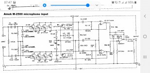

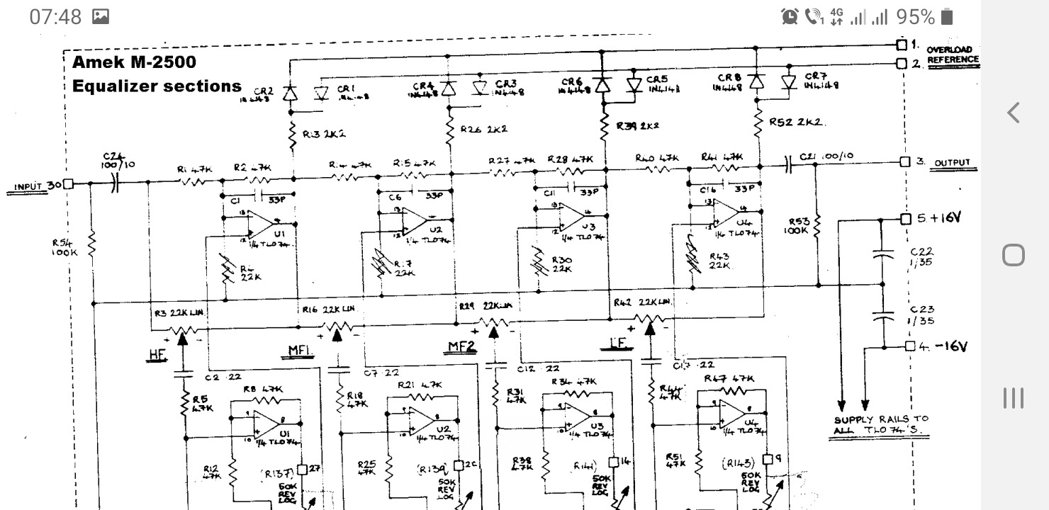

On a further note: it is very difficult to design a circuit where performance is limited by the opamp. In other words, virtually all audio gear measures identically with a wide array of opamps.
This is complete nonsense when noise is the measurement in question. You think an audio console based on NE5532 will measure the same noise-wise if those chips are swapped out for TL072s?
