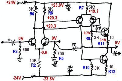

DIY JE-990 Discrete Operational Amplifier

That's complete nonsense. Why would this brick be better than an op amp from the manufacturer? It is always several magnitudes worse because it is bigger and you cannot do laser trimming, for example.Just found this, in the same JAES issue as Deane's paper on the 990.

Maybe because its discrete build and runs in class A while the 5532 has a PP output stage that runs in class B?That's complete nonsense. Why would this brick be better than an op amp from the manufacturer? It is always several magnitudes worse because it is bigger and you cannot do laser trimming, for example.
<The signal path consists of two consecutive differential stages, a single-ended common emitter voltage amplification stage, and a class B push-pull output follower with a current-sensing overload protection.>
