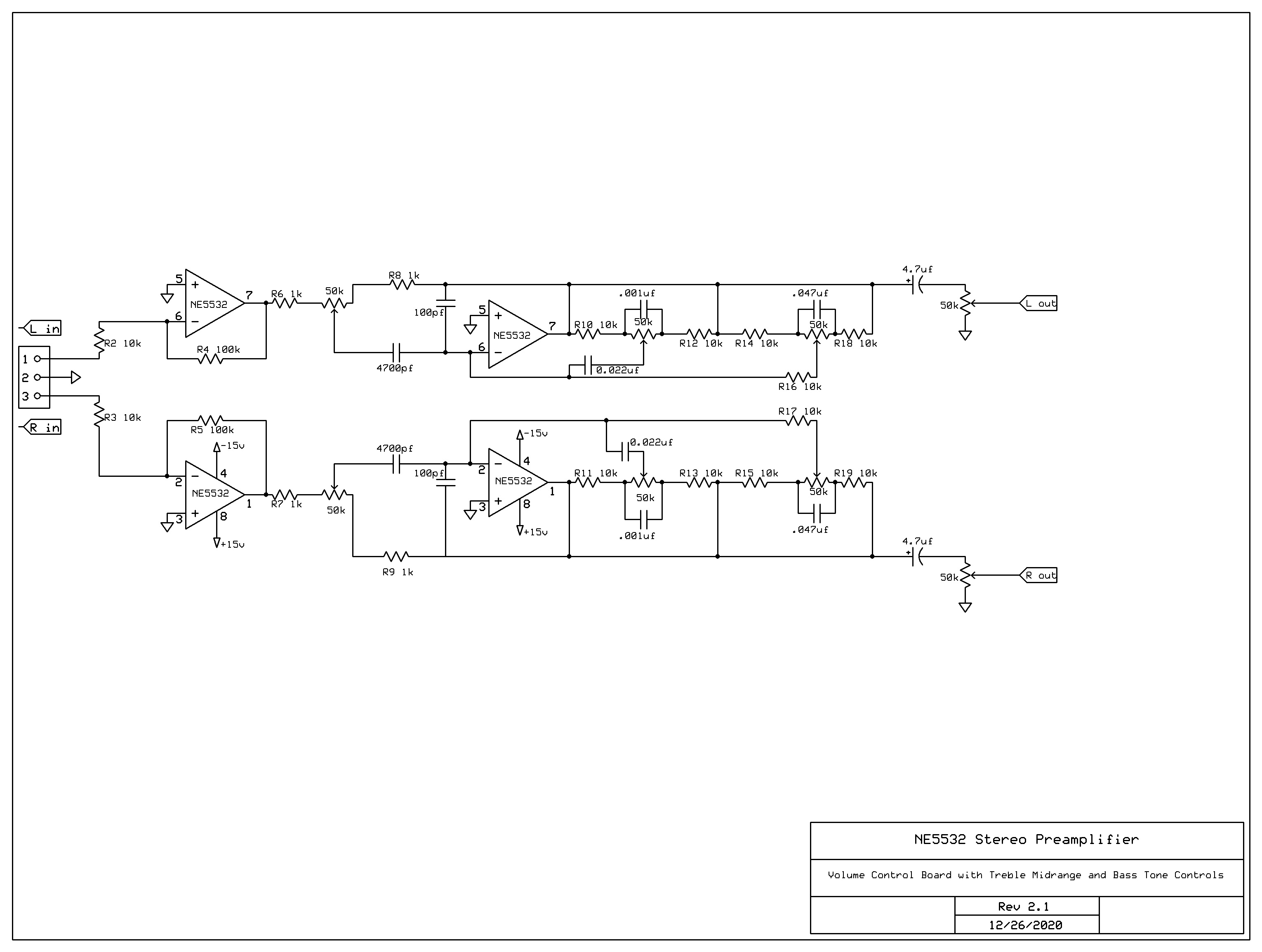

Thought I'd give one of these boards a try and for $15, 😱 . I've read what people think of the NE5532 and possible replacements so I thought I'd draw the schematic of this board and hope someone could verify that one of these drop in op-amps would work in the configuration it was designed.
Thanks all.

If a 5532 works OK then any of the more common unity gain suspects should be OK as well. If you want to go exotic with the opamp then I would suggest checking it is all stable with a scope at all possible settings of the control.
And tbh a genuine 5532 should be more than adequate anyway.
Thanks all.
I purchased on of these kits and it's decent... Puts out a little more that 8 vrms when it justs starts to clip on my O-Scope... Not bad for $15.

It seems you are just carelessly "rolling OpAmps" without much regards to the circuits they are used in. However your first sentence makes it seem like you do this professionally? But then again you "hear" distortions and oscillations but apparently didn't bother trying to verify or quantify them which somehow contradicts the previous assumption. I am left a bit confused after reading your post...
NJM8068 looks like an OpAmp for very cost sensitive applications with reasonably low source impedances. Not very interesting for DIY in my opinion, but for audio manufacturers it's a different story.
For us amateurs its a fun project to swap opamps in various audio equipment to hear the results. Its hit or miss. Since I discovered the OPA16xx family of opamps I don't need to swap anymore. I lucked out and got a bunch of free samples when they were still giving them away years ago. Although its good to have a scope to see what you're hearing
If your equipment is cheap enough go for it Paul 😉 I don't want to hook up my precious headphones to a potentially oscillating headphone amp if it can be avoided. Many popular headphones cost much more than a basic 50-100MHz USB scope with built in signal generator. Ever since I unintentionally built some oscillating circuits, I can't even enjoy listening tests unless I am fairly confident that everything is stable. That confidence either comes from the fact that the configuration is fairly standard and not prone to oscillation, or from actually testing.
