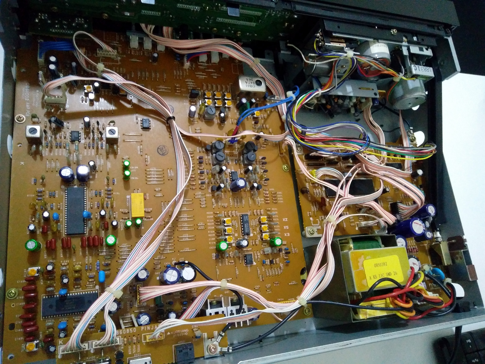

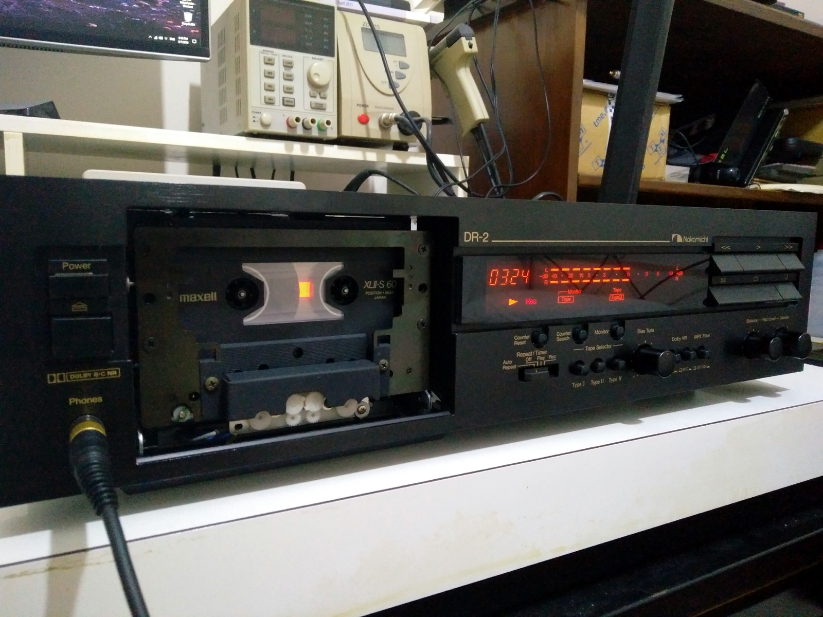

I explained "without any local decoupling caps" in the start of the post meaning no small value decoupling caps very close to the op-amps V+ V- rail pins. The DIP-8 JRC chips can be seen without such local caps in a Nakamichi DR-2 I have here on my bench for example. Its a late model in decks history, it was late enough to even have Nichicon Muse BP couplers (green ones). Very low THD signal electrolytics those.
DR2 playback input is discrete...

DR2 has discrete PB input indeed. The small PCB seen mounted at the back of the Sankyo mech in my picture. 2SK369GR & 2SA970BL/2SC2240BL used there. The JRC chips are in the line input, REC EQ, and REC amps. Also used as buffers & meter amps, when the HP amps are M5216 halves.
I have seen some low enough but still very obvious harmonic noise spikes in the FFT of this DR2 sample so ANT maybe has a point suggesting to move the chassis ref contact to the input side in this line of related Nak decks.
Seems realistic. That's what you get with shared signal and power ground returns. Two ways of addressing this issue:I built some tapeheads preamps last summer and winter and decoupling near the playback op-amp is a big problem.The only decoupling used in the industry is just one capacitor(either low esr, either no polarized between +- rails).That's all.You don't need any noisy ground around a tapehead preamp.They sometimes use a decoupling 1n...10nf cap between the input shielding ground and the ground but far from the op-amp.
a) Use dedicated, separate signal and power ground returns (Proper Star Grounding[tm]), thus keeping bypass capacitor current away from signal ground entirely. Designers in the 1980s would shy away from this as they had enough complexity to deal with on their single-layer boards as-is. It's much less of an issue if you can afford dual layer boards (or *gasp* a dedicated ground plane) or some flying leads. People have had good luck bringing noise down in vintage equipment by "reinforcing" grounds with external wires, thus bringing down shared return resistance... clearly a sign of injected noise.
b) Insert some series resistance in the power rails, preferably for each chip individually. Maybe 100-220 ohms or even more, depending on what you can afford. The bypass capacitor nets you a voltage divider between power supply source impedance and shared ground return resistance at high frequencies, potentially allowing a substantial amount of HF noise to drop over shared ground return resistance if power supply source impedance is low, and it can be as low as a fraction of an ohm after all. That extra resistance could easily make 40+ dB of difference.
Both approaches could also be combined, of course.
