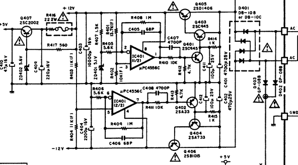

You could use local regulation like Nakamichi did. They used transistors to send the ground current of the regulator to the opposite rail before the other regulator. This reduced injected noise by the beta of the transistor used.
Pretty darned smart if you ask me.

Hi dreamth,
-Chris
I had 2 CR4...but bx300 was the smartest of them all .

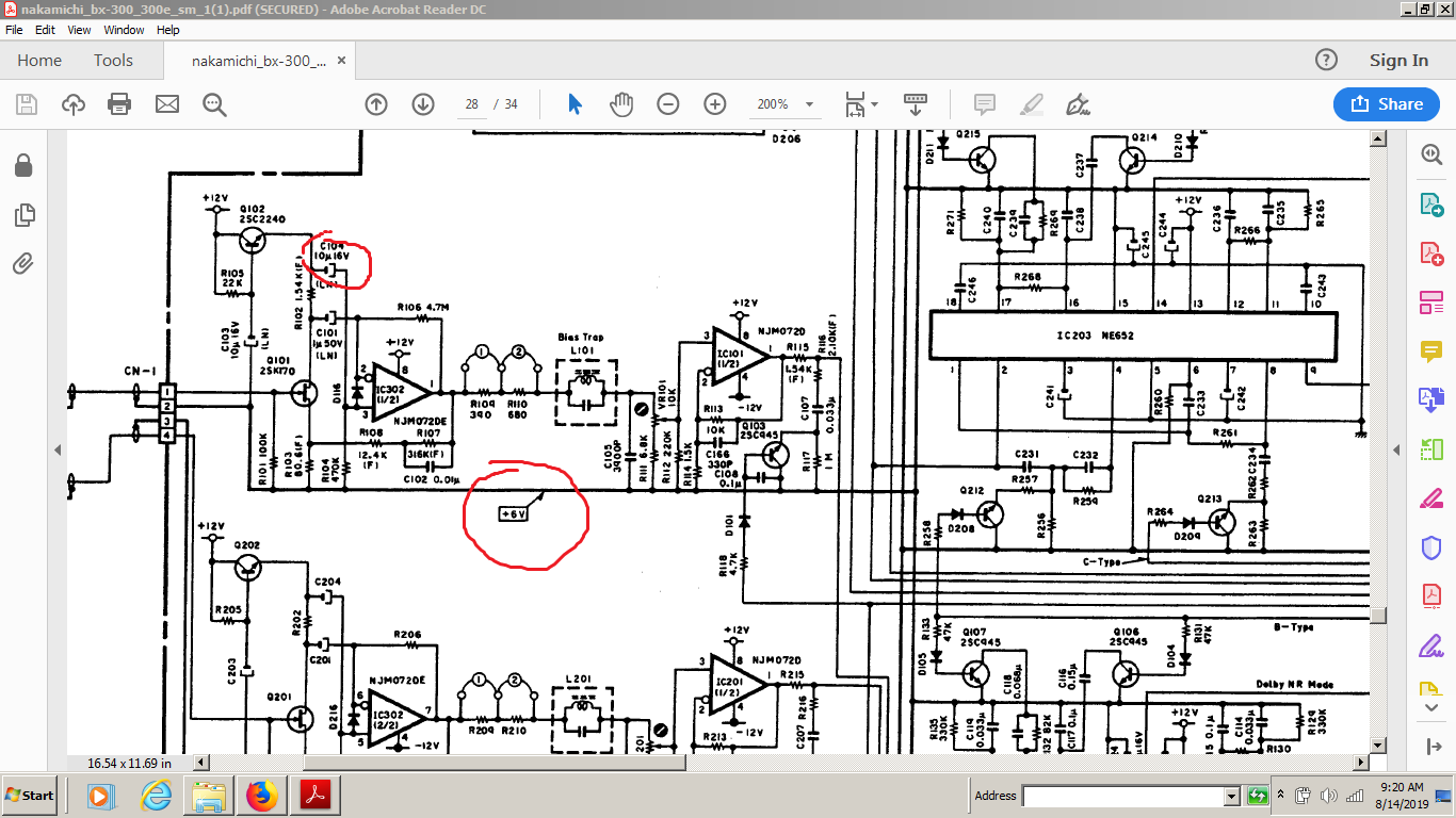

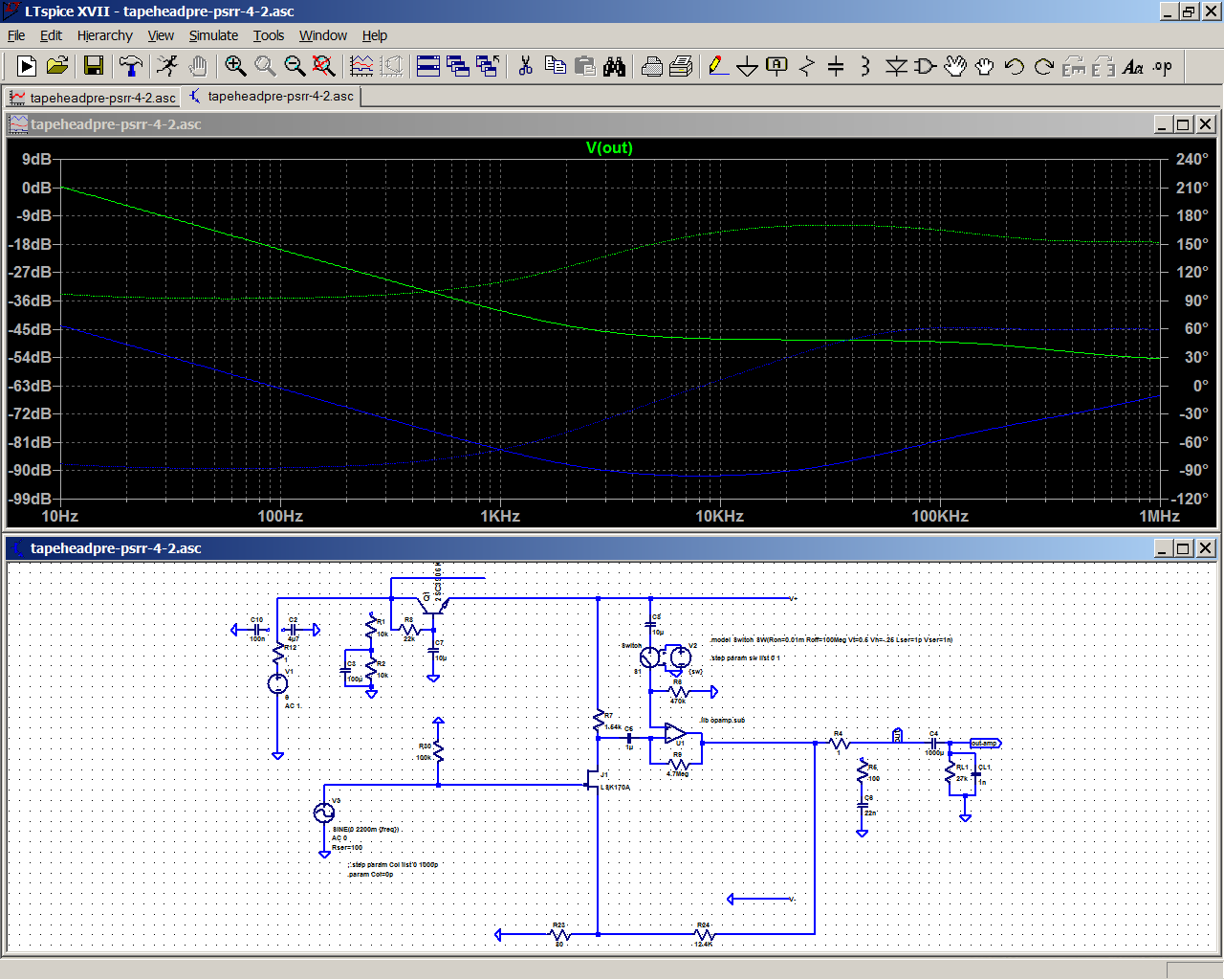

Neat, they're basically exploiting opamp CMRR by cap-coupling the +in to V+. Roughly 40 dB more PSRR at the cost of two inexpensive components per channel? Count me in. That's one to remember for whenever you have a singleton input low-noise preamp like that.
(Simulation attached.)
I can't say I get their +/-12V regs though.
attachment.php
Why didn't they bother to filter ZD401 when they did do the same for the +6V reference? Also, it seems like C411/412 would be making the regs rather slow, hence possibly why they have a boatload of capacitance on the outputs.
  • tapeheadpre-psrr-4-2.asc

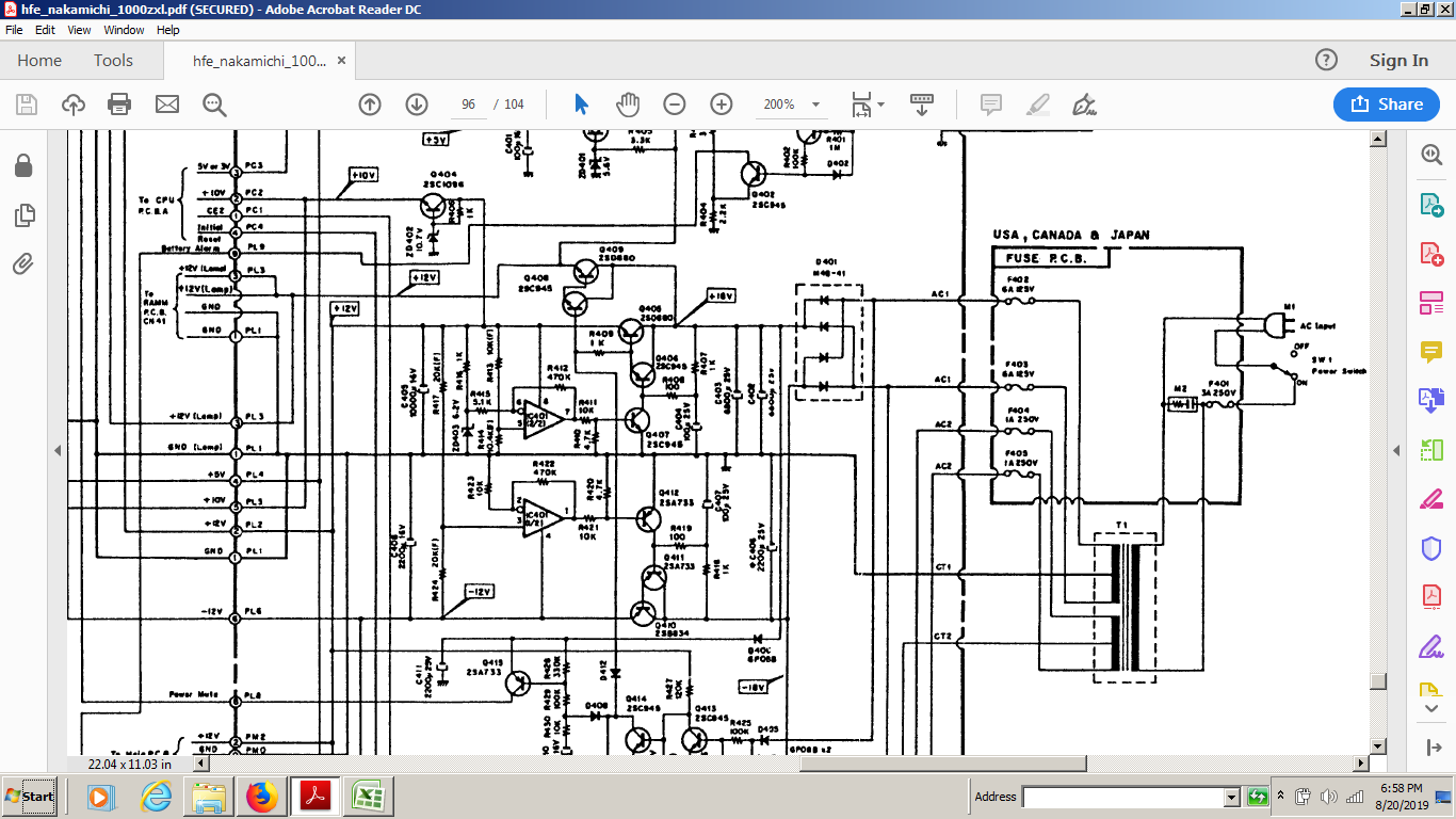

You're right, it's not that fast as i advertised it.I didn't analyze that circuit in depth.
I think that those c411-412 caps stayed there as a legacy form the more advanced models where they needed a high power, high hfe buffer to preserve the 4556(otherwise powerful enough) slew rate when driving two pairs of transistors in parallel.C407 speed it up a bit. It looks a bit oversized though.
On the other hand q401-402 need to have a steady voltage under input transients and the 100uf is charged through 1kohm and discharged through some mohms of the 2sc945 transistor so maybe it's not that slow either...it's fast at cutting the q403 current so that the output voltage won't rise dangerously, it's slower at charging q403 base when the input go low so its main purpose is to protect the output and keep enough current in those capacitors.
c401/r414/c411 is also a filter so that when there's not much action the output is fairly now noise too.
I'd say this regulator is a philosophy in itself...

both inputs of IC401-1 see the same noise so it's canceled at the output as in their PB input stage.IC301 is in unity gain so very poor psrr and cmrr already...
-v please :confused:
I have no idea what IC301 being a unity gain buffer for the zener-derived +6V reference has to do with PSRR and CMRR being poor.
Did you mean IC101 rather than IC401? Or IC302 which I was referring to earlier? IC401 is in the power supply.
If you did mean IC101 1/2, well yes, that is correct. Not only there but in fact almost the entire circuit, as +6V serves as the reference all over the place (this is commonly referred to as an "active ground"). I guess they may have done it because the NE652 needed it, otherwise much of the circuit with its +/-12 V split power supply would have worked just as well with a dedicated ground connection instead. (Typically Japanese, they like doing things a bit more convoluted than necessary.)
"Ground" always is an arbitrarily chosen potential. You say this is your reference and that's it. If your circuit is operating between +12V and +6V, you may just as well treat it as if it were running between +(12-6) V = +6 V (eff) and 0 V, with the +6 V (eff) supply bearing the noise of +(12-6) V. The circuit will not care one bit about any potential shared between +12V and +6V relative to "real ground", including noise. It's like a firmly attached camera inside a ship looking at an artificially lit internal room where everything is locked down - it will look the exact same no matter whether there is a storm raging outside or the sea is calm.
I exploited this in my simulation, since that conveniently also provided an ideal opamp which does not require any supply connections (the opamp only needed to be there and have approximately the small-signal bandwidth of a TL072, otherwise it was essentially irrelevant when it comes to demonstrating the effect since just about any half-decent opamp would provide enough CMRR).
I think the cd4066 , 4051, 4052...needed that half voltage too...i won't go back to that schematic.I thought high psrr and cmrr come with higher gain...which isn't the case with the unity gain circuit...
I think C411's job might be to slow the turn-on ramp so the pass transistor doesn't die trying to charge that boatload, giving the opamp and control loop a chance to come up and stabilize.

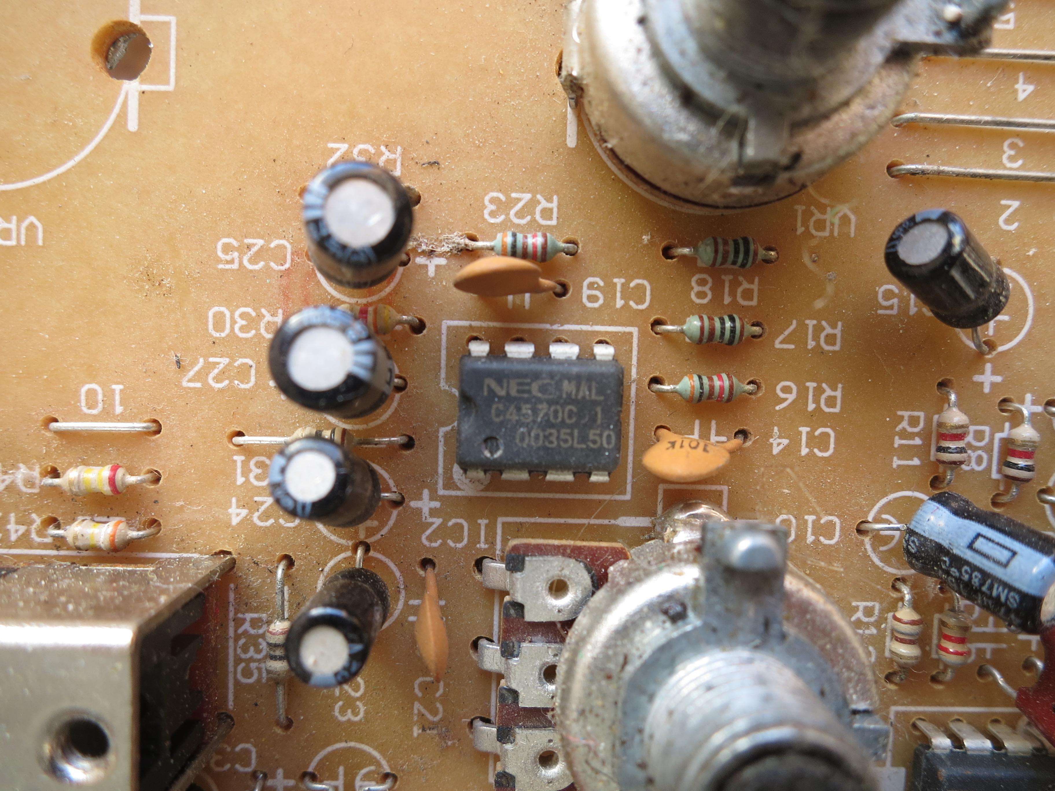

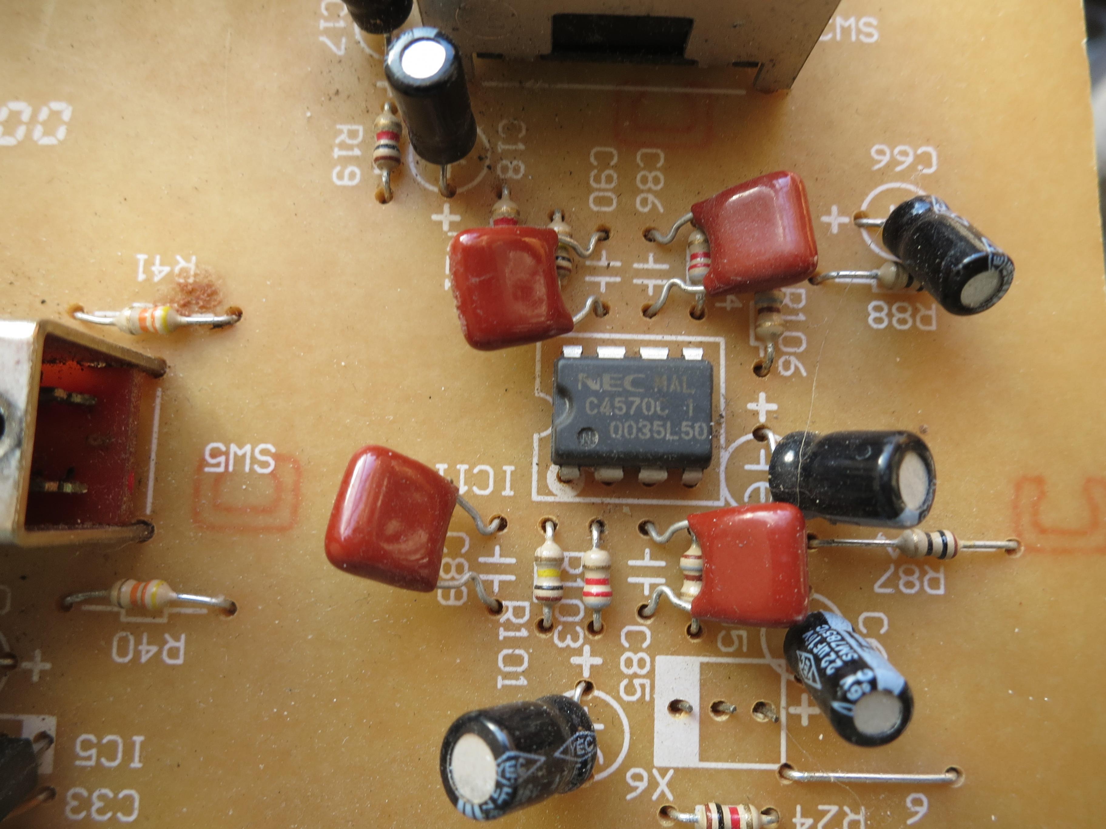

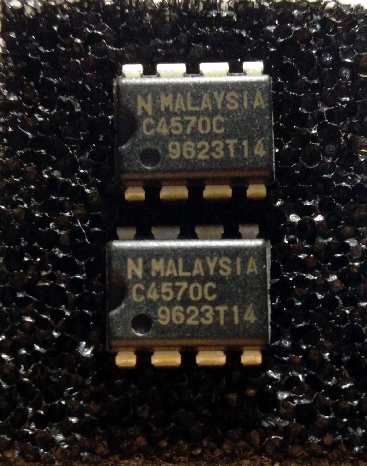

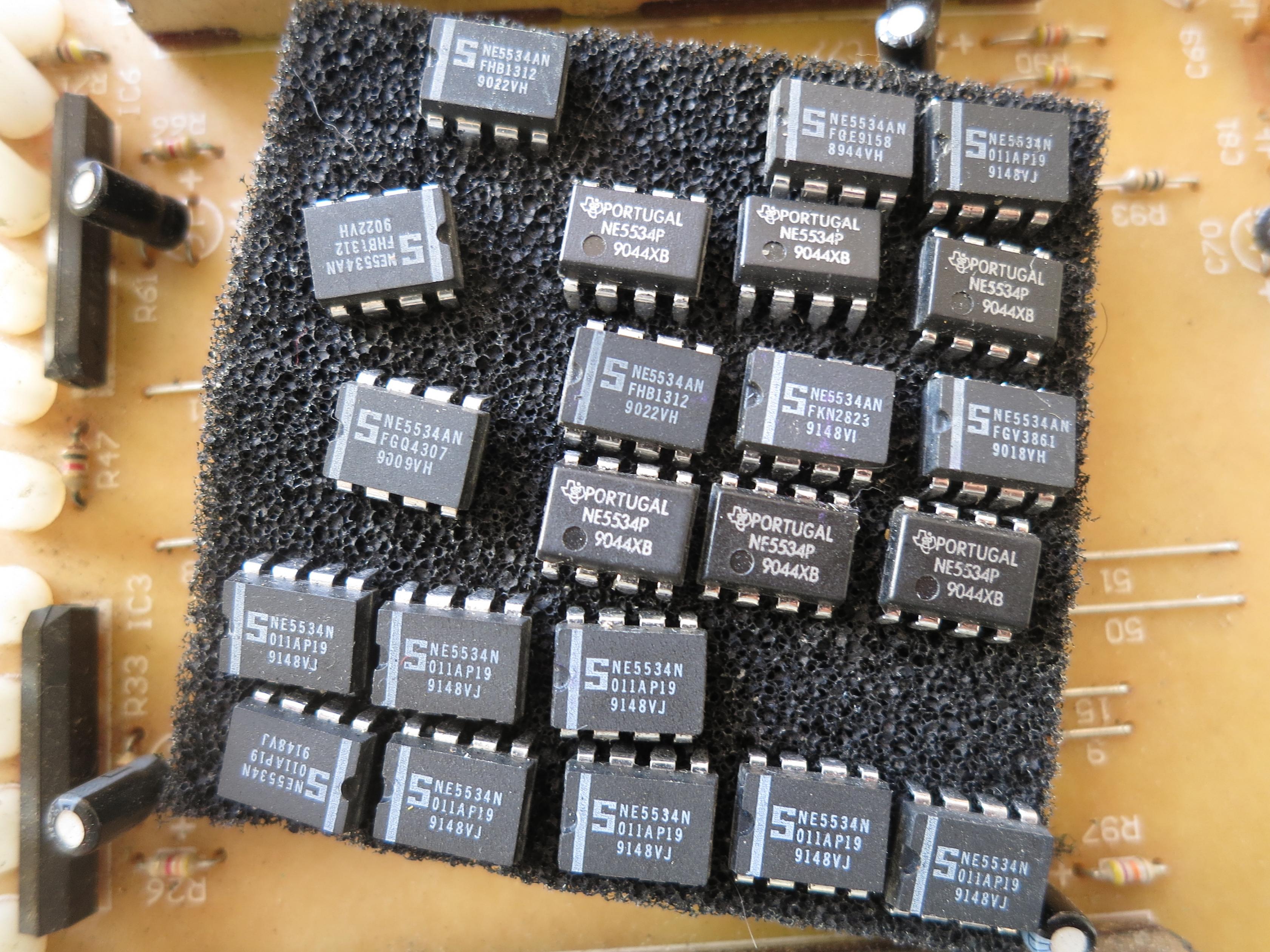

BTW here are my μPC4570C samples (the NEC similar low noise chip to the 5532 we talked about for a bit), do they look legit to those of you who met them in older Japanese audio machines?
Account Closed
Joined 2010

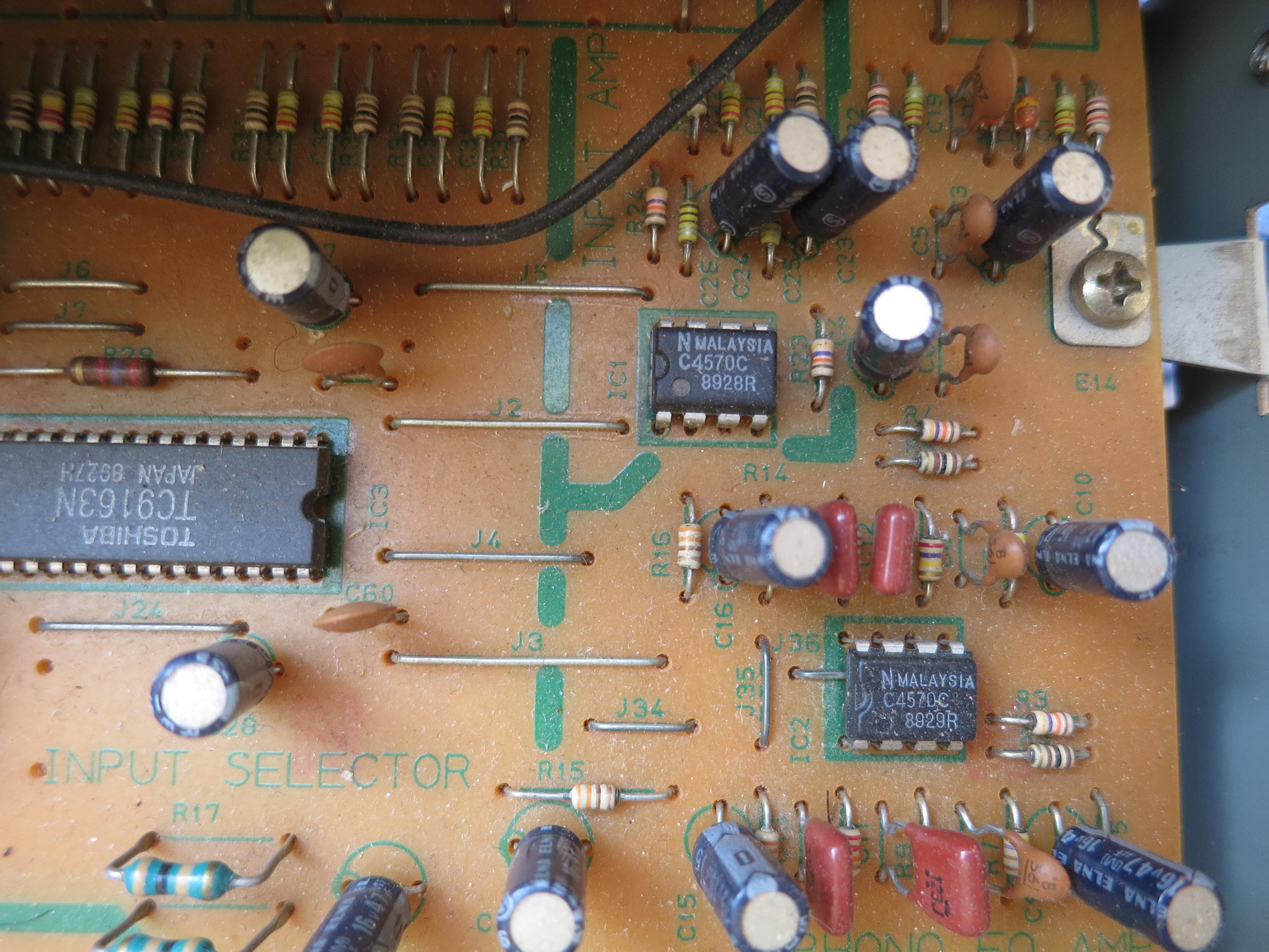

"They clearly don't look like indians to me :) Make Malaysia great again!"
Here are two versions, one from a Kenwood amp(a83), the other from a Gemini dj mixer, phono section
