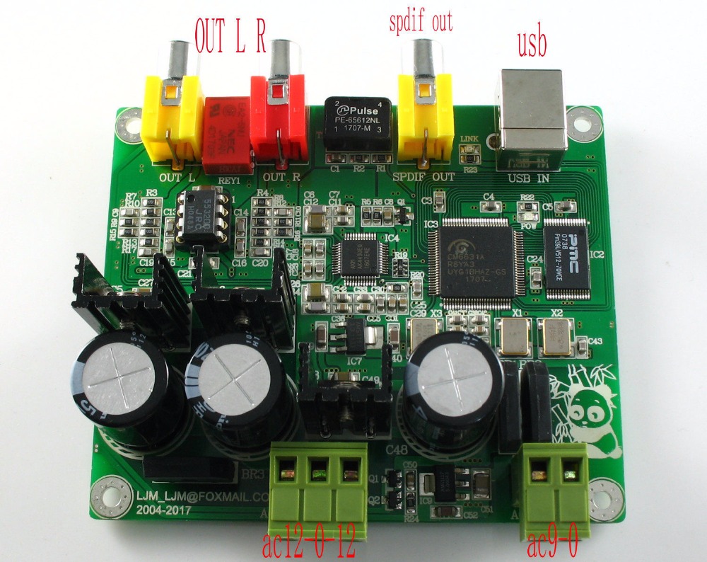

Many of the recent post forget the context of the 2011 original post. If you are like many DIYers, the chance of you ordering a DAC, preamp, line amp, crossover, headphone amp etc. from China through the bay or aliexpress is very high. The chance of getting fake active component, such as NE5532 from unknown foundry is also very high. The genuine NE5532 is a good choice for many audio applications. It has good bandwidth, slew rate and reasonable low noise to meet most challenge. But the performance of a fake NE5532 can be anything. Replacing the fake NE5532 is necessary to get good result. In most case, the rest of the PCB, passive components and workmanship are acceptable.
I ordered a bunch of LME49720 from DigiKey to be on hand. It is a lower noise, higher slew rate substitute for NE5532. Stability is NOT a problem in all case I did the substitution.
If you buy your opamp IC also from China, using fake part replacing fake part is not a smart move. Newark, DigiKey and Mouser are US electronic distributor who are willing to sell in smaller quantity.
When you receive the circuit board, if you see laser engraved marking on the IC, it is likely to be genuine. If the marking is a white paint stamp or no marking, you are most likely getting fake parts.

I have a AK4490 DAC with a 5523 in the output. What's the current favourite substitution? I see a lot of recommendations for LME49720, at a max of 17v and well shielded. Also OPA2604. Both supposed to be stable. Do you recommend these or something else? Need advice since I usually build with tubes.
Nothing wrong with NE553x.LM would be fine. You get lower distortion. A problem I see are the SMD resistors and caps. They produce a lot of distortion. WIMA ist here the solution. Don't use the OPA2604. It has much more distortion than LM.
Lm4652 is the common sub. Othersrrquire extensive PS decoupling that is probably not in the existing dac.
LM4562 = LME49720. They are the same chip exactly. These have much higher bandwidth and may misbehave where ann LM5532 was perfectly happy.
Nothing wrong with the NE5532, and yes. The surface mount components can be a much greater contributor to distortion. You can buy the right surface mount components, they aren't all bad ones. Even the PCB layout can mess things up. That you cannot change.
Make certain that there is enough power supply decoupling capacitors in there, be very careful which ground trace you use. (when is ground, not ground?)
