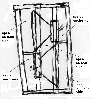

I have got some new idea about my version of W/Ripol. The idea is to trap exhaust from the pole vents into dedicated sealed eclosures. This construction will allow usage of somewhat noisier drivers.
Enclosures can be also used to house electronics. I am planing to mount the O Audio BASH 500W plate amp on the left side of the cabinet into bottom sealed enclosure.
In addition to that, reduction in radiating area of speaker drivers from the back side will make the sub radiation pattern somewhat more like cardoid.

Rudolf, Calvin,
What do you guys think of my proposed design? Are there any hidden issues? Will I have problem with voice coil overheating? Those sealed enclosures will be about 17 liters. And the woofers are 18" Russian Pro woofers with 4" voice coils.
Thanks in advance.
Thanks in advance.
Iliya,
there might be some hidden issues. But since nobody has tried your proposal yet, we don´t know how big those issues could be. Foremost I would see the area in the middle between the two drivers as a risk. There will be a high pressure gradient in that area, with forces that are far off the drivers design axis.
Dipoles typically don´t have issues with voice coil overheating first, but with the excursion limit!

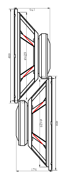

Thank you for your suggestions Rudolf. To tell you the truth I do not see that high pressure in between driver cones concern as a big issue. Let me explain why:
First of all the cones are much smaller than the driver frames. Please see the attached picture where I draw additional red lines as continuation for black lines that already were there on the original drawing showing the cone. I think that's where the cone is. See, that magnet is 220mm in diameter and the voice coil is 100mm.
The second thing is that cones are round and shown black/red lines are only the contour lines, and rest of cone surfaces will be even further away from each other.
But I am concerned about voice coil temperature because in my latest revision pole vents will be exhausting into fairly small sealed chambers. In this case the heat may be accumulating there over time.
Small point
Why isnt it pushpull design, which would be the obvious choise ?
Im not sure, but if theres significant noise from voicecoil, which is what you are trying to solve by closed chamber behind magnet, I would expect the noise to make its way forward through the dustcap, as well, maybe even "amplified"
Also the small closed chamber will have a ressonanse, using the magnet venting as a amplifying tube, playing through the dustcap
Just a homebrew theory 🙄

There are two reasons why it's not a push-pull:
1. The push-pull design as proposed by Linkwitz is supposed to suppress even order harmonics. And I am not so sure that it's particularly good thing to do. As I read just recently the level of second harmonic might be much higher than level of third harmonic before becomes detectable by listeners. And I am concerned that if we reduce the level of even order harmonics then odd order harmonics will become prevalent in the harmonics spectrum and sound will be less pleasurable. In addition to that I would like to mention that as far as I know the most of tube amps have even harmonics higher than odd ones and that seems to be the major reason for so called "tube sound" that many people like so much.
2. The second reason is the size of the speaker cabinet. My goal was to make is as compact as possible.
Regarding the noise from the vents and closed chambers:
I do not know yet for sure how noisy those particular drivers are. I just have been told on a forum that there is some noise from the vent and lead wires. I will get my drivers in about two weeks and check them out. However from this thread, Linkwitz research and other sources I understood that the major reason why many drivers will not suite for a dipole is a wind nose from their pole vents. So I thought that if we trap that noise into closed chambers that BTW should be filled with a sound absorbing material like synthetic wool then we can solve that noise problem. And in addition to that as I already mentioned above there is one positive side effect of reduced sound radiation to a rear. However I am not insisting on having closed chambers. They can be also open to the rear or variovented to the rear as well. The later might be in fact the best solution as it will allow the coils ventilation, noise reduction, will reduce a box resonance and will still provide a guarded space for the amplifier at the same time. That’s killing not just two but four birds with a same stone. 🙂
Since its a sub, ANY kind of reduced distortion would be welcome
The considerations you have about distortion relations would only be an issue further up in frequency
The closed magnet chamber
I will suggest you do the chamber, but make it open, so that it can breathe freely
Just heavily stuffed

What picture are you referring to? There two of them. The bottom one is mine the top one is from this website: http://www.lautsprechershop.de/hifi/index_en.htm?/hifi/ripol_en.htm.
I don't quite understand what you mean by "ripole summation". If you are concerned that my proposed design has two front outputs rather then one I think that it should not matter as front output slots are located within one foot from each other and the wave length even at 80Hz is more than 14'. So the phase shift between those two front outputs will be very minimal.
