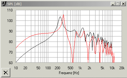

I did a simulation for one Dayton in a Ripole, using the data of Udo Wohlgemut.
Red is the simulation for the frontloaded horn (3 cm wide). The resonance peek is at 300 Hz. You can`t push it any higher with the Dayton. It mainly depends on the ripole size - which is given by the driver size. You need to be lucky to find a driver that can push the resonance much higher.
Black is the simulation for the backloaded horn (10 cm wide). It shows the dipole roll-off for the ripole. If you want to EQ for 40 Hz as the lower limit, sensitivity would be down to 75 dB for 2,83 V and 1 m. This is already including the floor backup.

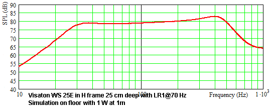

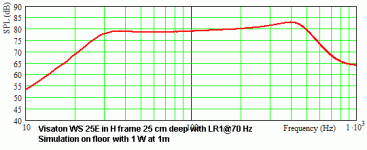

How about this cheap (30 Euro) Visaton WS25E in a H frame? Take two of them and you are almost there. You are heading for 88 dB with the Neo 10, right?
H frame would be 29 cm wide though.

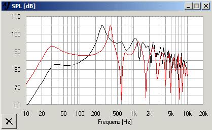

just as an illustration for all interested parties, and I am NOT starting to do these sims on an hourly basis 🙄😛.
This looks like a much better ripole driver. Front opening is 5 cm wide. Back opening is 10 cm wide, but could be wider without hurting much. Both chambers are 30 cm deep and 30 cm high inside.
This sim is for one driver only - AJ horn does not more. Just add another one for your efficiency calculations and make the common front opening 10 cm wide.
Notice how the output at the front is increasing from 150 to 30 Hz by 5 dB. This increase will be "eaten up" by the dipole loss. This loss is documented in the black line. At 33 Hz it is only about 6 dB below its value at 150 Hz. So you will only need a few dB EQ.
Resonances are well above 150 Hz too.
