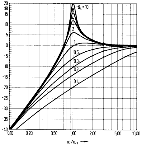

Rodolf mentioned the need to "compare Qts" in order to determine the spl of a driver below the manufacturers rated spl, which was done at 1000 hz. What is the proceedure to do this computation for 27 hz? Example: Uframe type dipole, per Martin King; using a 15" diameter driver, fs=25hz, SPL=95db at 1000 hz, Qts=0.927, Qes=1.081, Qms=6.498, Xmax=6.3mm, Vas=192.84L, Imp=8ohms, Re=7.2, Le=2.56, Bl=15.22.
Michael,
for calculating the real SPL for a driver in a cabinet (or an OB) you will need a simulation program. For the driver on IB (or IEEE baffle) you can calculate the SPL loss resulting from low Qts from this diagram:
The vertical axis is showing the relative SPL values compared to the 1 kHz standard.
Horizontal axis is for the Fs of the driver. 1.00 means Fs, 2.00 means 2x Fs, 0.50 means 0.5 x Fs etc.
spl vers Fs graph

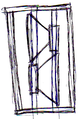

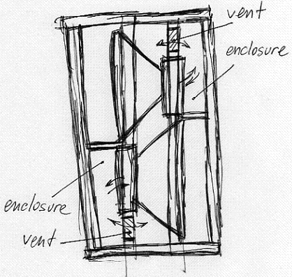

I just got one idea about construction of dual RiPol with two 18" Pro drivers. The location of drivers is shown on the picture. I guess that the width (depth?) of the side chambers could be only half of the middle one. It seems that these two 18" drivers with diameter 460mm and overall depth 176mm can be squeezed into fairly compact cabinet with outer dimensions H x W x D = 840 x 330 x 500 mm. Such cabinet can be used as a stand for a Mid-Hi section. What do you think? Could the height of the cabinet become a problem because of standing waves?
Then I have got another thought about depth of the chamber in front of the driver. Regarding the fact that narrow chamber provides an additional load to a driver, should we then make the condition when rear and front loads are symmetrical? I suggest to run driver with high amplitude at low frequency via resistor and then to check on the scope if current being consumed by a driver is the same in both directions. If not then size of front chamber should be adjusted accordingly. Any thoughts?
Some aspects to consider:
If calculating the front and rear loads of your drivers, the air bounded by the loudspekaker cones has to be added to the outer chambers and has to be subtracted from the inner chamber. Since the cones make up a large part of the volume of the inner chamber, it needs to be significantly larger.
If the drivers have vented pole pieces, these vents will work into chambers with opposite pressure relations. This could be an issue.
The height of the cabinet could not become a problem because of standing waves. The only standing wave (quarter wavelength) will develop along the depth of the cabinet.
Making the front and rear loads symmetrical looks like a good idea, but what about making the front and rear excursion from the idle position symmetrical? The second looks like an even better idea, but does not imply the first automatically IMHO.
Yes Rudolf, I would agree with you that exhaust from a pole vent goes in the wrong direction. BTW it looks that double-stocked RiPol has the same design: If stacked is the preferred method then the front cover (market blue in the picture) of the top Ripole needs to have a cut-out of 182 mm diameter (marked red in the picture) to accommodate the driver's magnet of the lower RiPole.
That sure doesn't make it right. However there seems to be fairly easy way of fixing that issue: rears of magnet assemblies need to be enclosed in separate chambers that vented into the center one. Please see the updated picture below. Also this design can allow using drives with pole vent noise issue as enclosures can be stuffed with sound absorbing materials.
