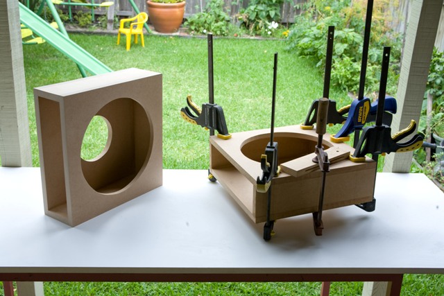

OK , first thing I notice, how simple a ripole is to build if you have a router and a circle cutting guide.
I just bought 4 Chipboard panels 450mm * 450mm * 16mm thick.
Sounds big until you cut a 390mm circle from the centre.
I am going to go now and assemble the bits and post a first subjective report, with happy snaps.
I intend to layer the chipboard with a second layer of MDF, which will give me a total thickness of 28mm.
Now all I have to do is find my camera.

Tight fit, have to buy different material for sides.
http://farm4.static.flickr.com/3103/3116825049_c2906cd918.jpg?v=0
http://farm4.static.flickr.com/3109/3117652820_c2c6ec1d39.jpg?v=0
http://farm4.static.flickr.com/3271/3117653816_38df27164c.jpg?v=0
I need to get thinner timber the 32mm dressed pine won't fit.
Other option is 19mmDAR and a second layer of 12mm MDF
