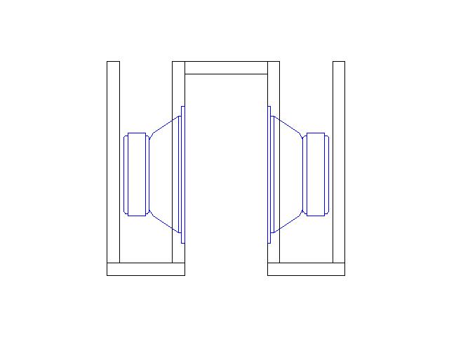

Is this for a N or W baffle? If it is for a N, then I am assuming that you would have to have a larger opening for a W baffle, is this correct?
Rudolf said:
The rule of thumb here is: If the drivers Xmax (peak-to-peak) is >10 mm, the opening area of the pipe should be not less than 1/3 Sd. If Xmax is less, the area might be reduced down to 1/4 Sd.
This may be dumb query so apologies in advance, but can a single driver be a Ri-pole??

It is for a single driver. To be doubled for a two-driver ripole.chrisb03 said:Is this for a N or W baffle?
Correct. Please see the W baffle simply as two mirrored N baffles.If it is for a N, then I am assuming that you would have to have a larger opening for a W baffle, is this correct?
Yes, of course. What you loose will be the impulse compensation of two drivers working push-push.Moondog55 said:This may be dumb query so apologies in advance, but can a single driver be a Ri-pole?
Horizontal N frame would be OK, but don´t try those narrow front and back openings. They will lower Fs even more and reduce efficiency too. The front opening for those drivers should at least be 1/2 Sd. If you need to raise Qts you should do it by raising Qe, not Qm!These drivers were reconed and had really stiff foam surrounds instead of the soft original surrounds, the Fs has dropped to 18Hz, Qts is 0.56 X-max is only 6mm, what are the thoughts on putting this driver horizontally in a single driver Ripole and running the 4 X 12's in parallel before it.

I guess you would model it as a "H" frame, with the average dimension front and back.

soundcheck said:
Those drivers look like the Peerless 12" SLS. I bought a pair today. I am just trying to get the size of the W type baffle sorted out.
Seems I will be going for the following size:
Using 18mm MDF
Baffle size - 360x360mm
Front opening - 80mm
Back opening - 85mm (the magnets would stick out about the same as the above project)
Hi.
The dimensions I applied for my 15'' BD15s are:
All in mm:
W:355*H:455*D:455
Center opening is 80
Wood: 18
The whole cabinet is obviously not vibrating.
Putting them on spikes though delivered much more refined sound.
The tricky thing was to get both holes (driver and magnets) on the same center-axis.
At the same time the gap between magnet and wood I didn't want to have greater then 2mm. This way I could use 2 layer of sealing tape to get it properly sealed.
As you can see the speaker-size for 2 * 15inch drivers is ridiculous small.
I'd always recommend to go for 15inch drivers.
Good luck.

to maybe clear things up a bit.
A Ripole is a small folded baffle dipole that is named as a reminiscense after one of its inventors Axel Ridtahler.
The originally symmetrically designed dipole (W-style) was named BMC.
The patent was granted in 2000 under the number DE 198 30 947 C2.
At a later time one of Axels´s business partners suggested to test a asymmetrical small folded baffle dipole, the here so called N-style (though it rather looks like an S-style to me). This concept was named DRS and prooved to function equally well as the BMC and so it was decided to apply for a second patent, which was granted in 2003 under the number DE 102 30 669 A1. Both patents decribe the use of passive (preferred) or active filtering and equalizing.
