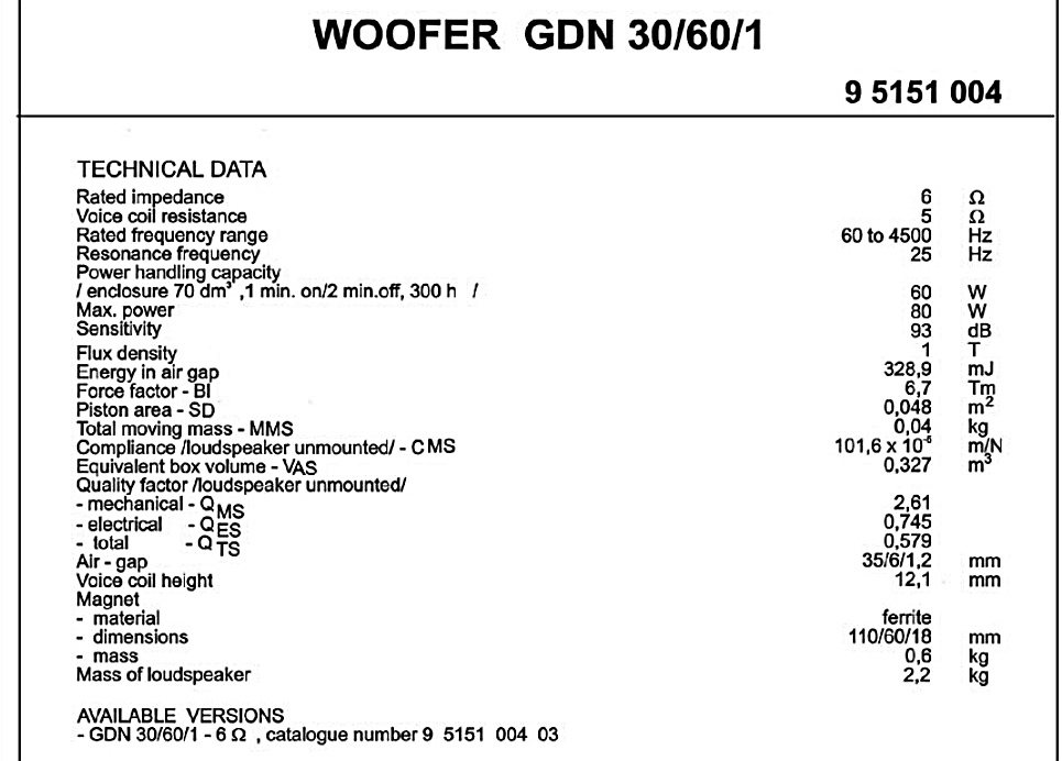

Friends,
First of all I would like to say I want to make similar construction as Jazzman did (Jazzman's DIY Electrostatic Loudspeaker Page: Ripole Subwoofers:)
Basic construction assumption is it will be bass part of 3 way system, all active. That said I would conclude that efficiency is not an issue as I can easily equalize it. The same regards crossover frequency change.
My question is if the speaker as below is suitable to use in ripole?
Thank you in advance for the answer

I´d say its a critical choice.
On the plus side are low mass, membrane area and Qt
On the minus side are soft suspension, low Fs and low excursion capability
The larger dimensioned Dipoles after Linkwitz or a open Baffle might be more suitable as the Fs doesn´t drop as much as in the smaller sized Dipoles after Ridthaler.
The low excursion limit rather asks for multiple driver setups, utilizing min.4 or more drivers per stereo channel.
Unknown remains the sonic behaviour of the driver.
Will it perform without, with low or with high noise?
The driver wouldn´t be my choice

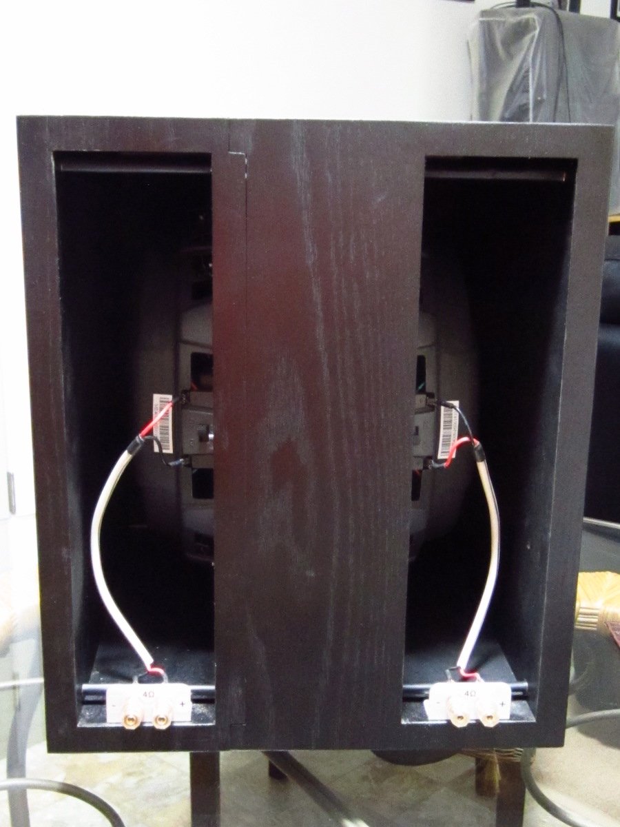

It's my understanding that a true "Ripole" design (short for Axel "Ridtahler's Dipole") uses dual subs in an opposing push/push configuration where the front of each sub fires into a common center chamber and the rear of each sub fires into it's own dedicate chamber. That's what I recently built using a pair of Infinity REF1200S Low-Profile subwoofers so I wouldn't have to see those ugly magnets sticking out the sides of the enclosures.
Why is it that high Mms is not good for Ripoles?
It pulls down sensitivity.

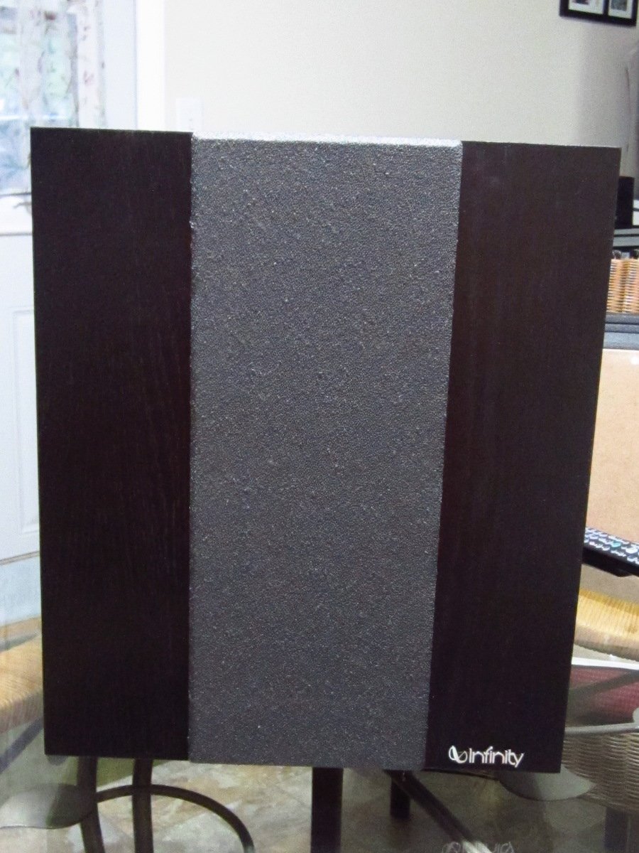

Any measurements?
I use a MiniDSP DDRC-24 in my setup for room correction. According to the frequency response from it a single Ripole sub (the 2nd is in it’s finishing stages) along with my Magnepan 1.5QRs are flat down to 27Hz. While this doesn’t go down into pipe organ territory (I don’t listen to that sort of thing anyway) it is a HUGE improvement over my Maggies alone. I agree with a statement made by “Jazzman” (Google “Jazzman’s Ripole") that you should not expect chest thumping, room shaking bass like you would hear at a movie theater from a Ripole. Taking that into consideration the added bass provided by the Ripole sub blends beautifully with my Maggies.
