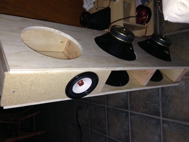

That's quite a stack there! Nice project. It seems like you would have an even shorter path, based on your picture, than the ripole would. I guessing better sensitivity though.
Well, as I said, the pic is without the wings. Imagine 1.5 ft wings at 90 degrees on either side of the manifold
