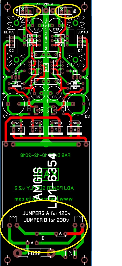

The bubbles at the top are the rail voltage adjustment pots and the large bubble at the bottom is where you select input AC voltage. Once assembled you will have a premium grade series regulated adjustable power supply
Hi Carl, i just plug all the part together for the first time today (PSU, Preamp, I/O, selector) no music yet, just oscilloscope with 1000Kz/150mV at the input.
I noticed after 10 minutes that the PSU is warm at the BD139 (61℃) and BD140 (50℃). I have 200mA (17V+) and 180mA (17V-) with the selector at 1er input (XLR).
With no load @ the PSU, i don't have this issue.
Hmm, did you put a dab of thermal grease under the BD139/BD140 devices and their heatsinks?
It sounds to me that you are not getting a good thermal couple between those transistors and their respective heatsinks.
Please note that some BD139/BD140s have an exposed metal mounting surface that must be electrically isolated from it's respective heatsink using a mica or silicon insulator.
Silicone insulator perhaps, not silicon!
Ha, ha ... Yes! I should proofread what write.

I changed the SK 104-2 ( External Length - Metric 25.4mm) with SK104-6 ( External Length - Metric 63.5mm) heatsinks and the temperature drops of 10℃ on each side. But now i am too hight for my 1U chassis....i am curious to now if they are any other option than to change the heatsinks.. Carl, did you check for any oscillation on your boards ?? ThanksHmm, did you put a dab of thermal grease under the BD139/BD140 devices and their heatsinks?
