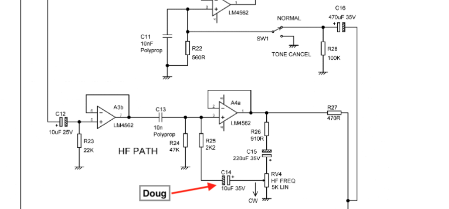

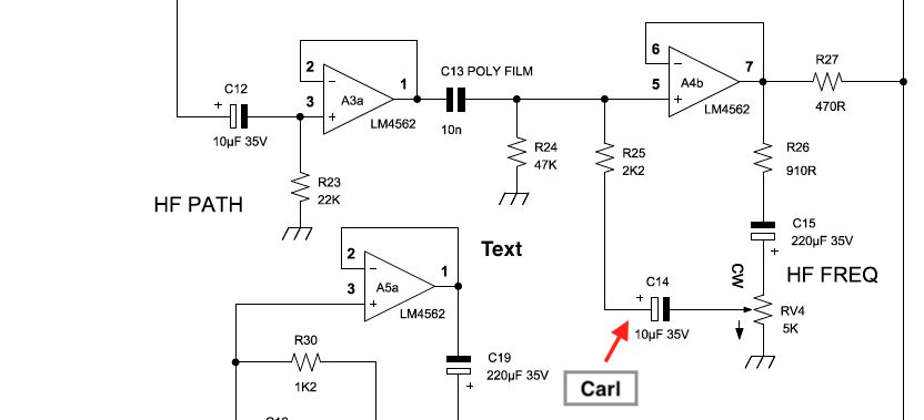

Hi Carl,
I use polarized electrolytic cap as recommended by Doug Self. i have 35V Elna Silmic II. C14 on your Schematic and PCB is reversed for same C14 in Linear Audio Vol 5 article page 150. Could you confirm that the schematic in Linear Audio Vol 5 article is the one that is correct? if yes i have to reverse C14 on your PCB. Thank
Hi Carl,
That's a really good question that has not been asked before! Orientation didn't matter with the caps that I used, but ...
if you are building with polarized Silmics, I would follow the direction as published in the Linear Audio article.
