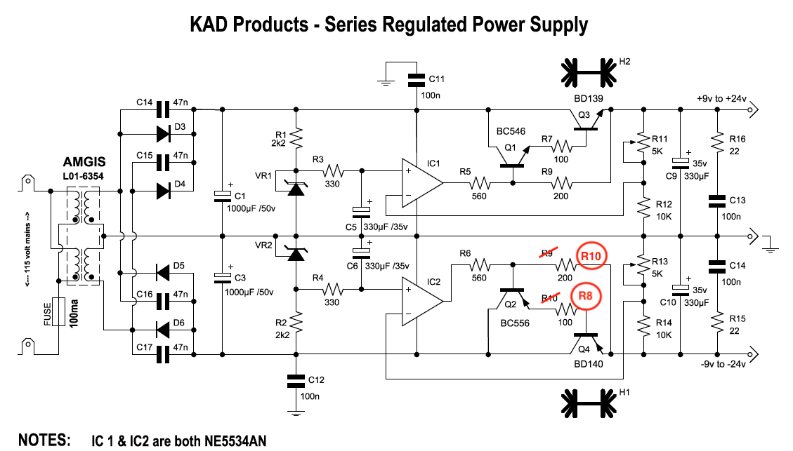

For the Series Regulated PS there seems to be some minor discrepancies between the schematic and the PCB silkscreen related to R7-R10. I've put an inquiry into Carl. Hicoco and others, how did you populate yours?

Yes, i noticed that there are a mistake on the negative rail for R10 and R8 when i populated my board with the schematique.. otherwise R7 and R9 in the positive rail are good.

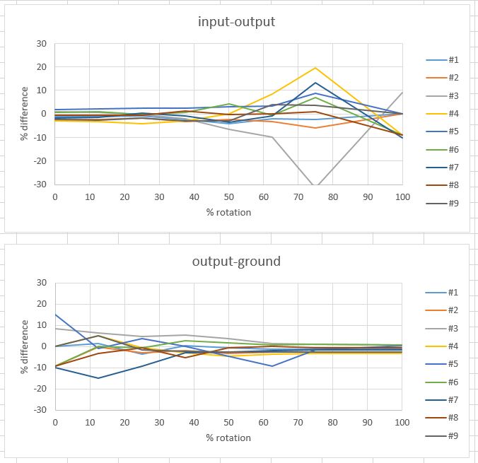

Just for giggles I measured the channel imbalance of 9 samples of the Alpha 5k linear pots from Tayda. A couple outliers, so I'll pick the best for the 6 positions and the flattest for the volume control.

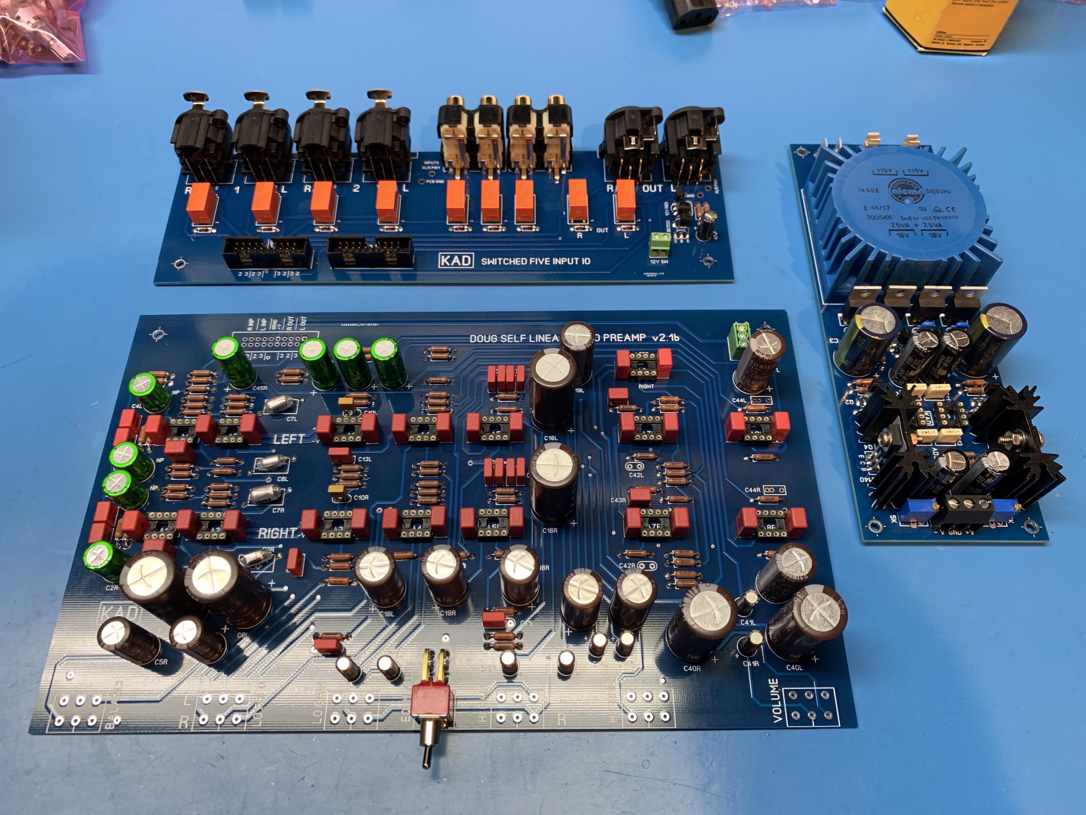

Look like i have a serious problem with this series Regulated PWR Supply.
I changed the Transfo for an +-15V 25VA
With no load i am able to adjust the output at +-17Vdc or more.
With 200mA load at the positive rail and 180 mA at the negative rail i have +-15 Vdc and not able anymore to adjust the voltage at a value higher than 15 Vdc when i turn the adjustable Pot.
I have at the primary 241Vac and after transfo 2x18,5Vac, after rectifiers +-25Vdc with no load and +-21,8 Vdc with the load.
Just a reminder i am able to adjust at +-17Vdc with a 2X18vac transfo but the BD139 is abnormally hot after 10 mns (61℃)(142ºF)
Carl your thought please.....

Yes, Carl agreed the schematic had an error as indicated. The image you posted is correct and that is how I built mine. I tested without load and everything seemed fine. Very smooth and wide adjustment via the trimmers, no excessive heat after 30min set to +/17V. I ordered some 100ohm power resistors to load test while I build the enclosure. I used MUR820 diodes and matched BC550/BC560 for hfe only because I have a large stash (note the BOM had these reversed!).

yes, that is fine also for me too with no load and +-17V after 2 hours, no heat. i used also BC550/BC560. I have excessive heat with load after 10 minutes.
There is no heat with no preamp PCB or no load.
That heat up after i connected the preamp PCB or any load ( i tried also with power resistors to load test)
What value load resistors are you using?
Do you get clean signals thru both preamp channels when connected to it?
There might be a problem on the preamp board. You could have a bad or backward op amp or solder bridge.
