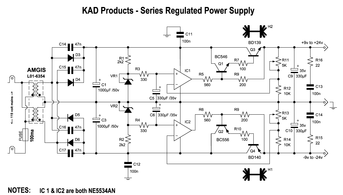

That is true, but the problem is that i have +-30Vdc after the rectifiers because of 240Vac here in France and 22Vac at the output of the Transformer for 18Vac with the AMGIS L01-6364.The NE limit is +-22V. +-15..20V is standard.

Thanks, with everything connected i have 21.5VAC at secondary and 27.3VCC after the rectifiers for 241VAC at primaryYea, that voltage is much too high. I had thought France had 220v mains. 240v is a surprise to me! Your simplest path would be to swap out the transformer for a lower voltage equivalent. The AMGIS L01-6363 at 15v secondaries or better yet the AMGIS L01-6362 at 12v secondaries would drop in and drop your voltage to the proper levels.
If i do the math with a 12VAC transformer, i should have 20VCC after the rectifiers.
I am surprise that anybody else have this problem..because with a 18Vac at secondary you should have around 23/24VCC after rectifiers, that is to much for the NE5534 !!!!!

I find this conversation puzzling. Surely the voltage after the rectifiers is being applied to the voltage regulators, not the opamps.

I think he's referring to the op amps in Carl's series regulator supply.

I think the op amps are powered rail to ground. NE5534 is rated for maximum 44V V+ to V-.

One solution is to put a couple of low V zener diodes or resistors in series with the opamp supply leads to eat up the voltage at worst case.
The opamp does not need symmetrical supplies.

Doug this is for the opamps of Carl's regulated power supply for your preamp Sorry for the confusion..I find this conversation puzzling. Surely the voltage after the rectifiers is being applied to the voltage regulators, not the opamps.
You are using a regulated supply, I assume?
The opamps voltage is the voltage after the rectifiers see attached..
That circuit uses NE5534A's with a gain of less than 3x and no compensation capacitor. Whoops.

The opamp is used single ended supplied and can easily take up to 40V. No problem with 24V.

Note NE5534A's will need 22pF or so between pins 5 and 8 to be stable. I would suggest also adding 22pF between pins 2 and 6 to ensure stable feedback. And of course the standard 100nF ceramic decoupling capacitor between pins 4 and 7.
I suspect that circuit was not designed with the NE5534A in mind at all!

You wonder why people use such sub-optimal circuits with superreg boards available in the diyaudio store ...
Ah, light dawns. Thanks for the info.
My policy is never to operate 5534/2s above +/-17V for the sake of reliability.
However, as has been pointed out, the opamps in the PSU are working from rail to 0V, not rail-to-rail.

My origin problem is that the BD139/140 overheat (60ºC) with the load (200mA) and who is that is not normal.
I will try with an 12V-0-12V transformator, i am waiting for one 70052K from Talema. Whith 240V i should have 20Vcc after rectifiers.
