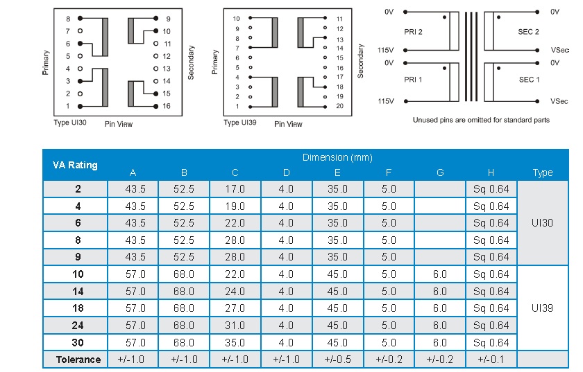

I had been told by others that this transformer (or it's pinout equivalent) was easily available in the EU/UK ... No???

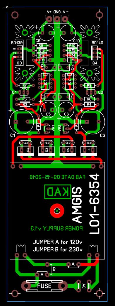

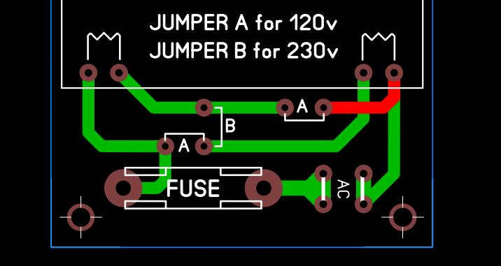

If there is enough interest I can easily add the 114/230v jumper mod to the PCB.
I looked at several types but couldn't find one that fitted so bought the recommended one.
If you do the 115/230 mod, I'll buy a couple more pcbs for other projects.
Attached Vigortronix data - mains pins and pin spacing generally all completely different.

What do you think of this?? Does that work for you?
That was quick! Yes it works and I have now found a UK supplier of Amgis transformers, although I've never heard of them, so no need to allow for other brands.
Put me down for 4pcbs when you have some for sale.
Many thanks.
