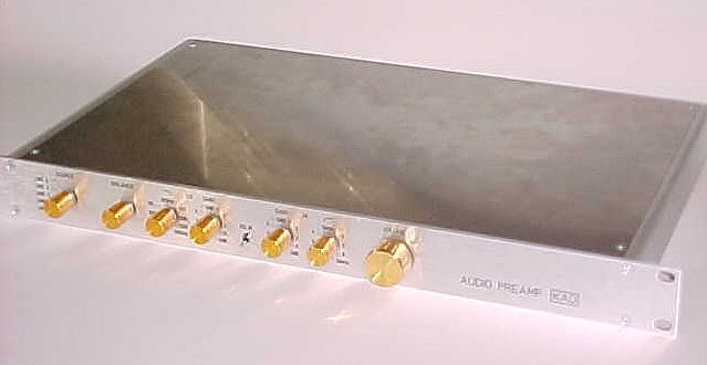

Hey Carl Huff beautiful build! I just got my boards and am looking for casing. Is that a front panel design? Can you give me details on your case? Would you be willing to share if it is a front panel design?
Hi. I'm sure that there is a correct way to measure the imbalance. However what I did was check the resistance of both tracks at full rotation and found a 120R difference.
I the did readings at various positions of rotation. I then expressed these readings as percentage of that tracks total resistance. The difference between the tracks for each position is what I quoted.
Ps could you let me know the correct method

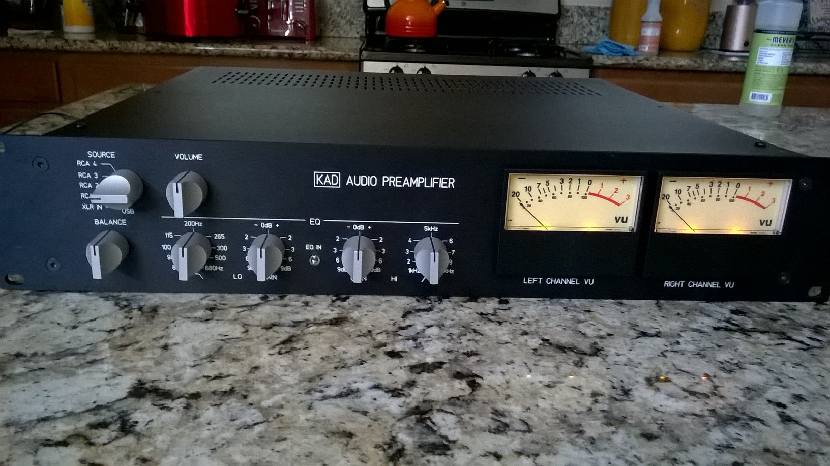

If you are looking at the PICs in my recent post, that is Ashley's build. And you are right, he did an excellent job. Attached below are a couple of examples of ones that I have built.
The FPD files for their front panels are here: Dropbox - FRONT_PANEL_EXPRESS.zip
So do you know anything about Ashleys build? Possibly a front panel design that we could share?
I invite Ashley to verify, but I think that he took the FPD file that I provide, modified it a bit for his purposes using the 'Front Panel Designer' editor that the service provides and (as my British friends would say ...) 'Bob's your uncle!'

Carl you are absolutely right, I did use your design.
I checked with some of our local island businesses to see who would be prepared to take on laser engraving. (its not a big island ) One company was enthusiastic and immediately took your design and my rough sketches of the changes and set it all up. A bit lazy on my part, but it turns out that he is planning to join us with a guitar amp build.

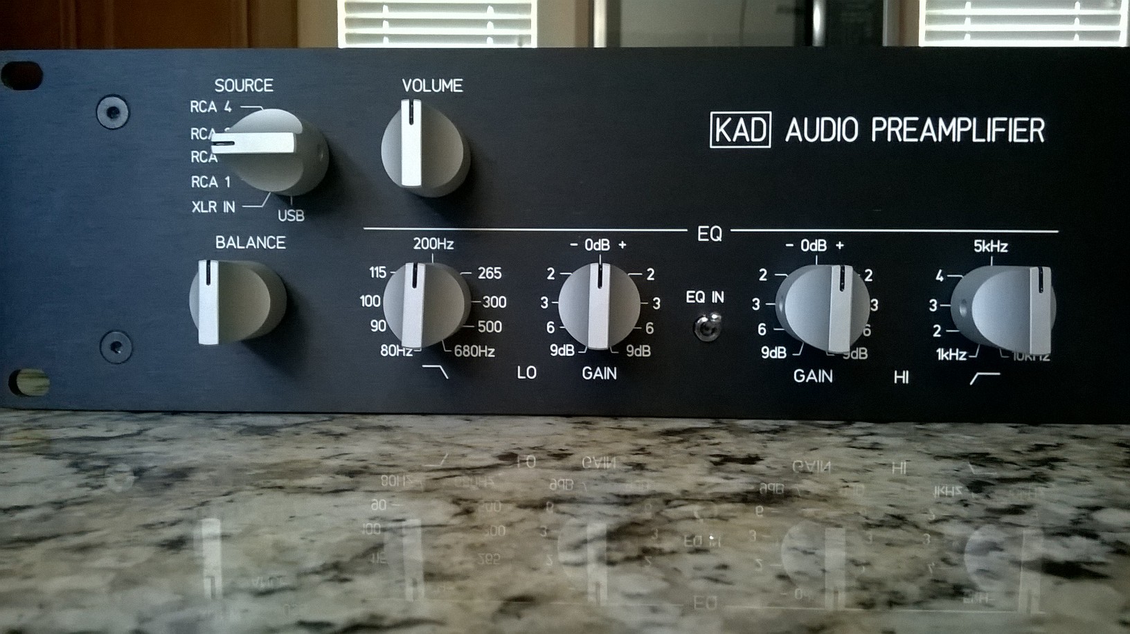

Here is a PIC of what I propose to be the front panel layout. The 'gold colored' circles are 15mm diameter control knobs.
Note the centrally located toggle switch that when operated to the down position bypasses the tone controls.

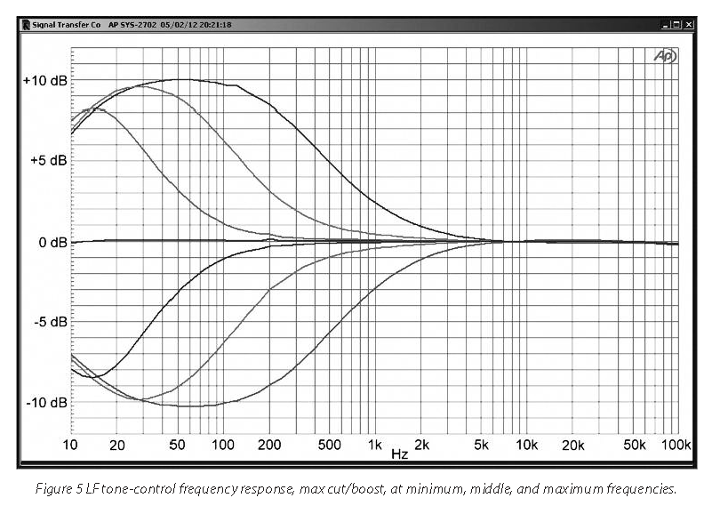

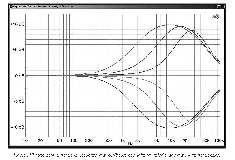

Carl,
I think the frequency control range does not match with DS curves in the LA5 article. Correct me if wrong.
Best Regards
Farooq
Carl,
Best Regards
Farooq
Farooq,
The panel markings are subject to debate but the circuit performance should be identical to what is plotted, as it is identical to what Doug published in his article.
Farooq,
yes that is correct. In my case frequency control is working correctly as per article and I prefer Max. for LF and Min. for HF.

nice front panel ! is there also a design (FPD files) for the back-panel you can share on this forum ?
Well ...
Unfortunately I never got around to making any but expect others have. I invite them to post those to this thread.
