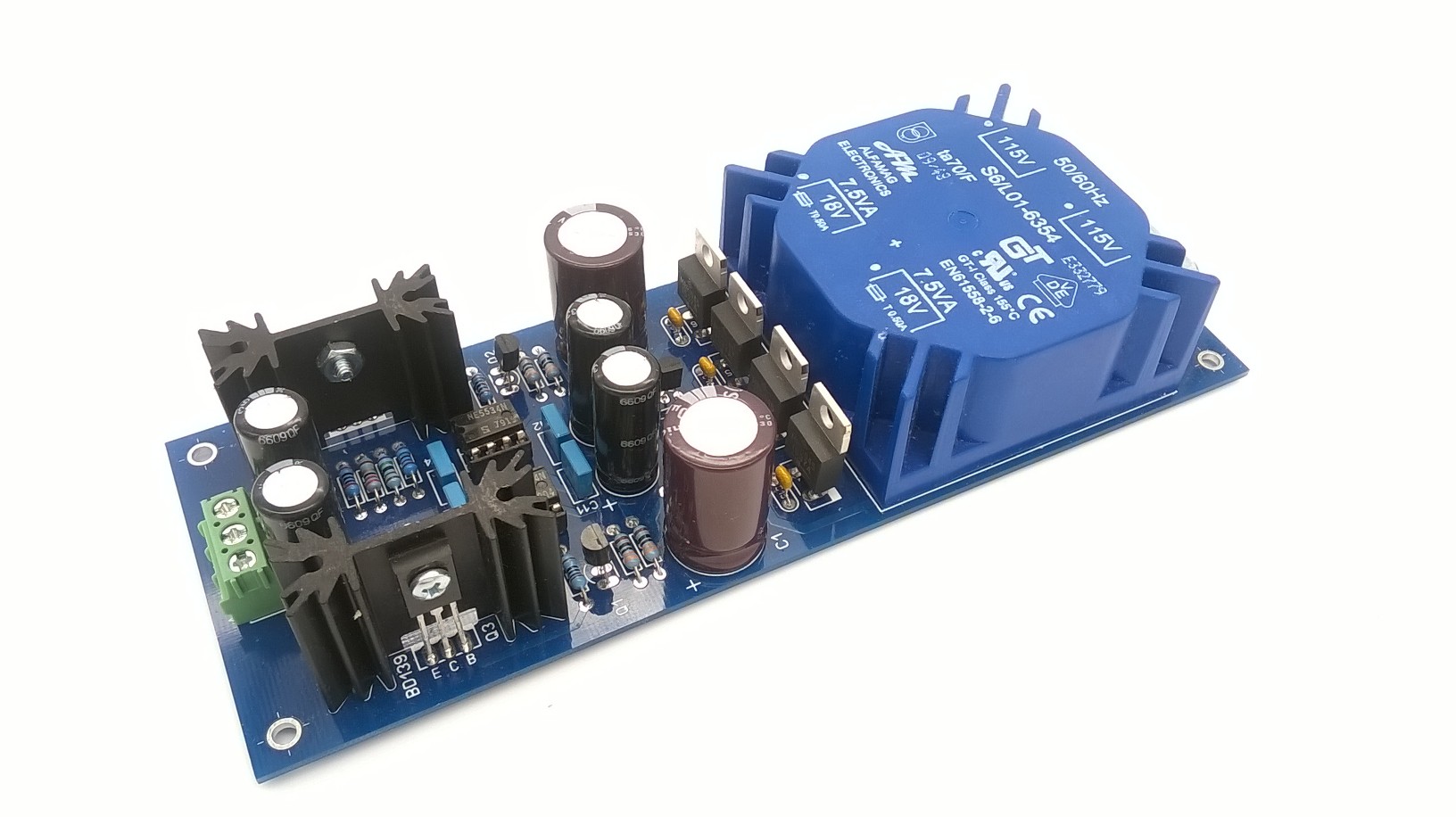

OK promise I'll stop asking so many ?'s. Is the BOM 13_02 the latest up to date for boards that I received last week? There must be a later version of the power supply from the look of my PS board.
The latest BOM is v13.03 and is here: Dropbox - DSelf_PREAMP_BOM_v13_03.zip
The power supply is here: Dropbox - SERIES VREG_FIXED_PWR_SUPPLY.zip
Hi Mr. Huff,
interesting power supply. Do you know how many ripple and noise is at the output with 300mA load?
Hi Mr. Huff,
I don't know but it's got to be low. The described power supply is an adaptation of a long proven series regulated design. Over the years it has become my 'go to' power supply for my analog audio projects.
I always have these PCBs on hand and would be glad to share should you be interested.
Nice board but not useable with my preamp kit with EU/UK 230v mains without some crude mods. Could you perhaps allow for connecting the primaries in series as well as parallel?
Also, the pin outs of the transformer don't correspond with any similar ones commonly available over here (eg Vigortronix). It should be possible to add additional holes to allow for this and increase the appeal to EU/UK buyers.
Have you considered the LT3015 / LT1965 low noise linear regs from Texas?They are 5pin TO220 and adjustable so here's the opportunity to update your design, allow for other transformers and 115/230v ac input!
I had been told by others that this transformer (or it's pinout equivalent) was easily available in the EU/UK ... No???
If there is enough interest I can easily add the 114/230v jumper mod to the PCB.
