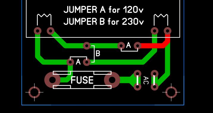

https://www.diyaudio.com/forums/att...elf-preamp-linear-audio-5-a-ac_jumpers_00-jpgWhat do you think of this?? Does that work for you?
Carl, again thank for your help, i would like also check with you about this PCB and be sure that you will sent this one with 230V, yes we have also 230V/240V here in France
Aah, okay. That will delay your order 10 to 14 days as I will need to send that out for fab. I have no problem with that as I had planned on stocking them anyway. Just note that your shipment will be delayed.
this is fine, no rush thanksAah, okay. That will delay your order 10 to 14 days as I will need to send that out for fab. I have no problem with that as I had planned on stocking them anyway. Just note that your shipment will be delayed.
