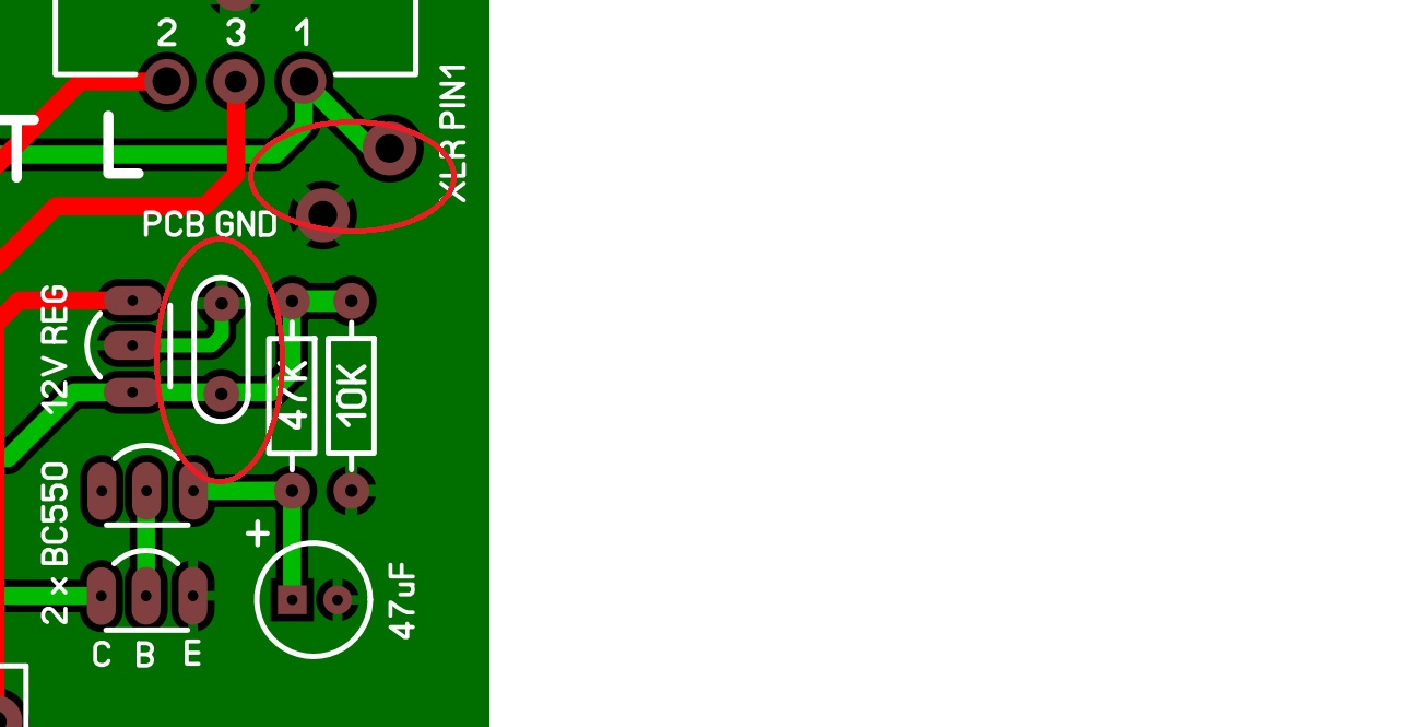

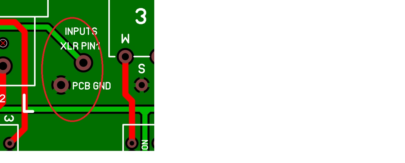

IO PCB: Per my previous commitment I have added a capacitor pad to output of the 12v regulator that powers the relays. I have also added support for alternate grounding schemes for the XLR connectors. As a builder you must now either add a wire jumper to the system ground or to the chassis as is pro audio practice. The inputs are grounded separate from the outputs. You must properly terminate both the input XLRs and the output XLRs. If you fail to do that ground will float unterminated.

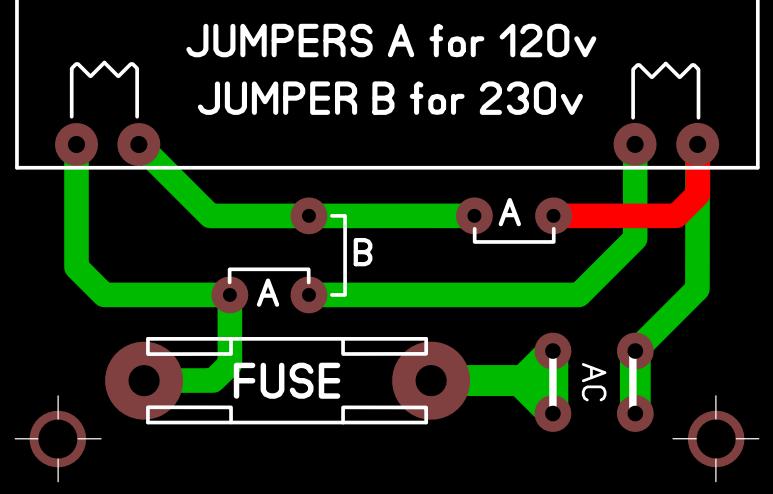

Pwr Supply PCB: I am now shipping the revised boards that include jumpers allowing the builder to configure for either 120v or 230v AC systems.

Hi Carl,
Just got my boards today, looks very nice... i saw that you have added a diode pad for each relay...cool do not have to solder it behind the PCB.
By the way what is the suggest capacitor and is value that you have added to output of the 12v regulator that powers the relays.

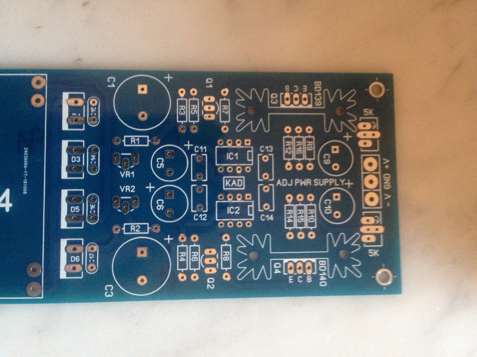

Hi Carl,
I just saw that you did not send the Adjust Power Supply board but the Fixed Power supply PCB, but i do not understand because there are the label "ADJ PWR SUPPLY" printed on it, see pictures
The pad added to the output of the 12v regulator is intended to accept a tantalum 10uF to 22uF capacitor. It most likely will not be required but is harmless in any case. Enjoy!
NOTE: Don't forget to ground the XLRs on the revised IO board.

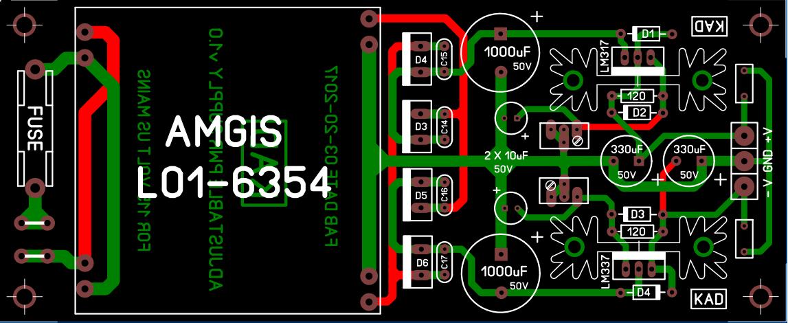

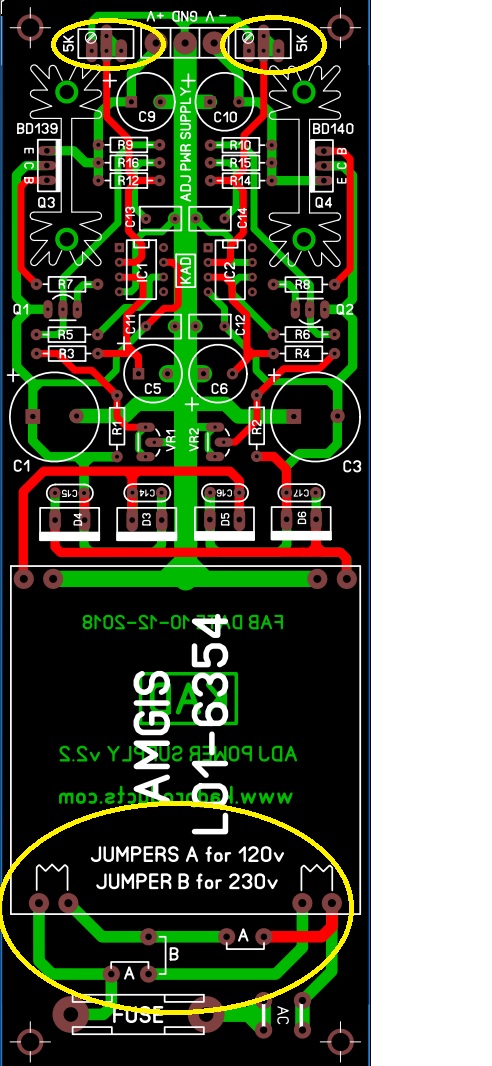

Hi Carl,
The bubbles at the top are the rail voltage adjustment pots and the large bubble at the bottom is where you select input AC voltage. Once assembled you will have a premium grade series regulated adjustable power supply

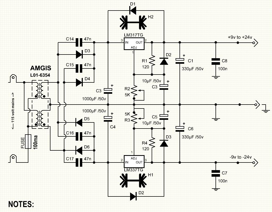

Yes i got this PCB, but unfortunately i got all my component for the other one.....i followed this adjust power supply schematic.
Could you post the new schematic and boom list thanks

Aah, okay. That is because per your request, we sent you our power supply PCB that easily adjusts from 120v to 230v inputs. The version that you were expecting does not support that easy change. In any case the good news is that they share many parts in common.
Here is the schematic and BOM for the power supply that we shipped you.
Be aware. These op amp supplies are not short circuit protected.
