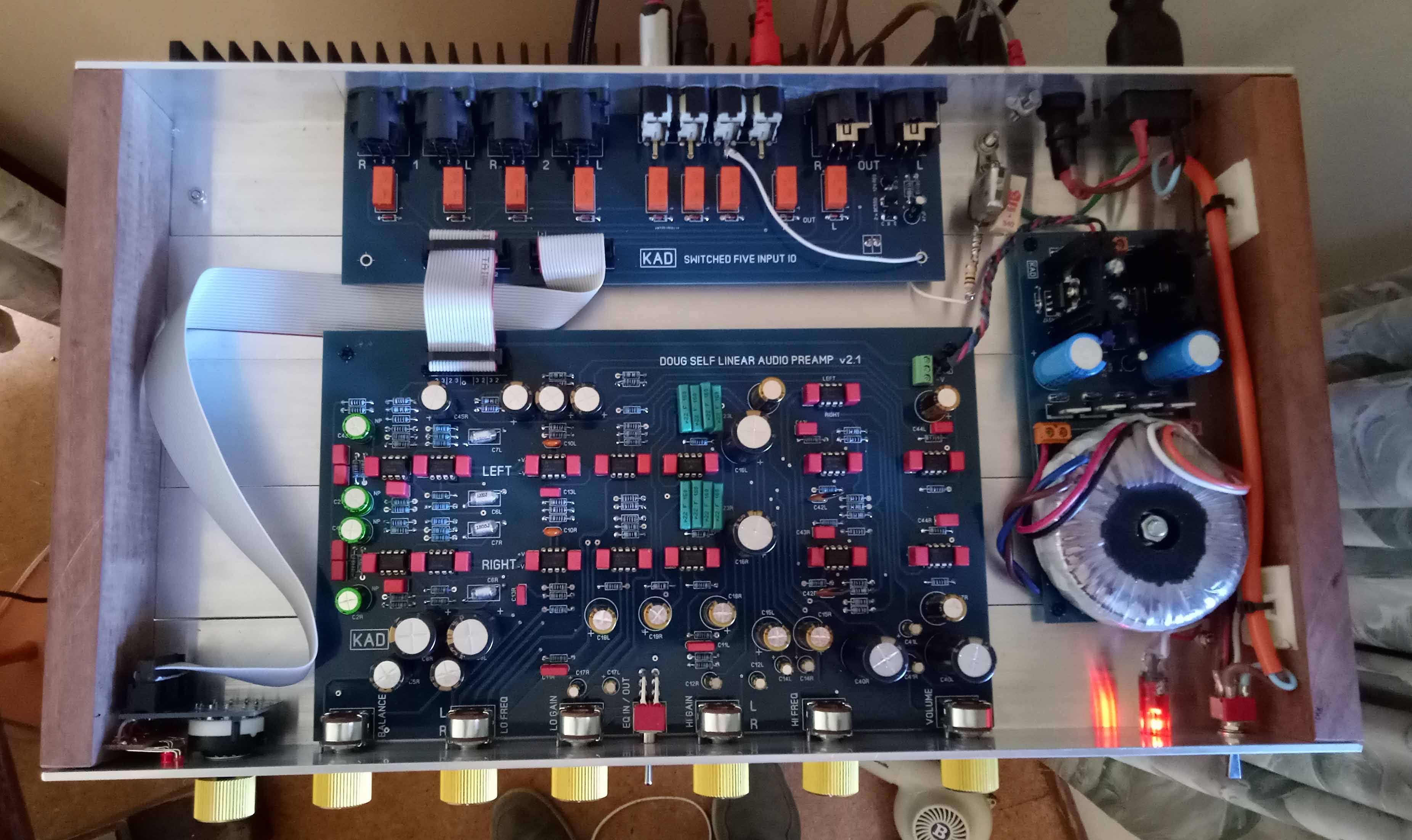

Completed LA5 Self Preamp V2
I am so happy with the performance of this preamp! 🙂
