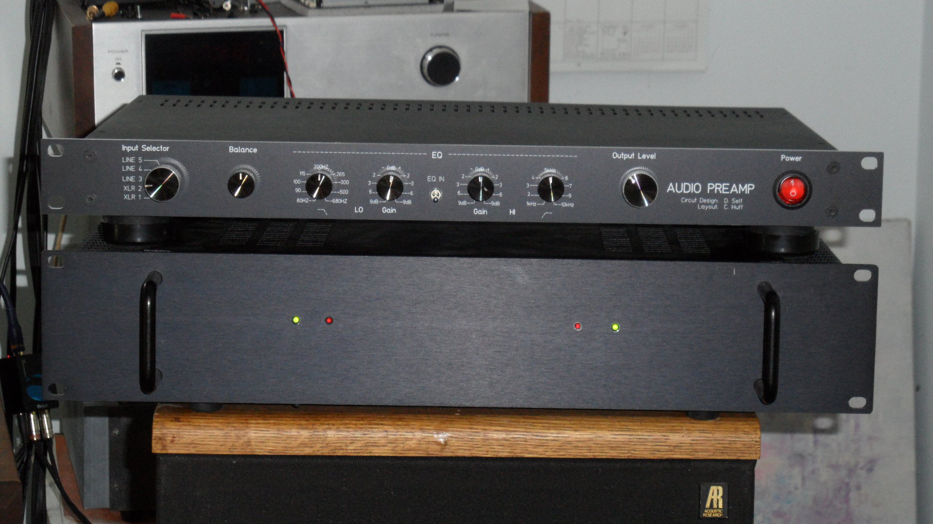

Final Preamp
Doug Self & Carl Huff, i hope you don't mind your names on this. If so, i will remove them. Sounds GREAT. Thank you to Both of you.
Rick
Finished Project PICs
Thanks to our good friends at Photobucket my previously posted PICs of the finished builds have disappeared. As result I have posted them again. Both builds are in regular use and a pleasure to listen to.
The build in brushed natural aluminum is a 1U package.
My black brushed aluminum build with meters is a 2U solution
