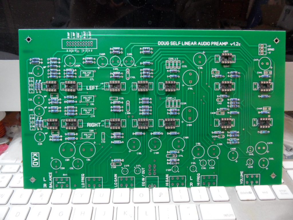

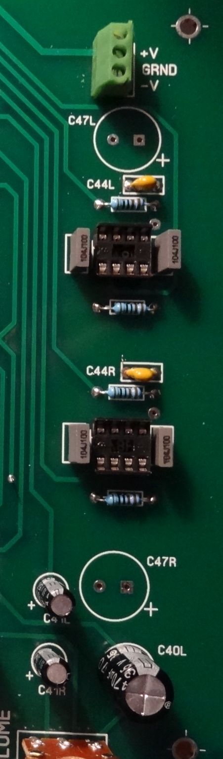

I don't remember seeing any R47L/R47R on my board. can u post a pic of the area on the board. Here was my board with all Resistors installed.

Hi guys,
Populating the boards and i came across R47L/47R.I can't find them in the BOM or schematic. Can someone tell me what it is?
Thanks, Terry
Terry,
If your PCB is marked v1.2 and not v1.2c you were inadvertently shipped a first generation PCB. I had not intended to do that, but it's no big deal if that is the case. The first PCB had two resistors (R47 & R48) that were decided to not be needed. Other than that the PCBs are identical. The fix is easy. Put a jumper in place of R48R & R48L and don't put anything in the R47R & R47L locations.
The details are shown here ...
You want to end up with only R49R & R49L resistors south of the A8 op amps.

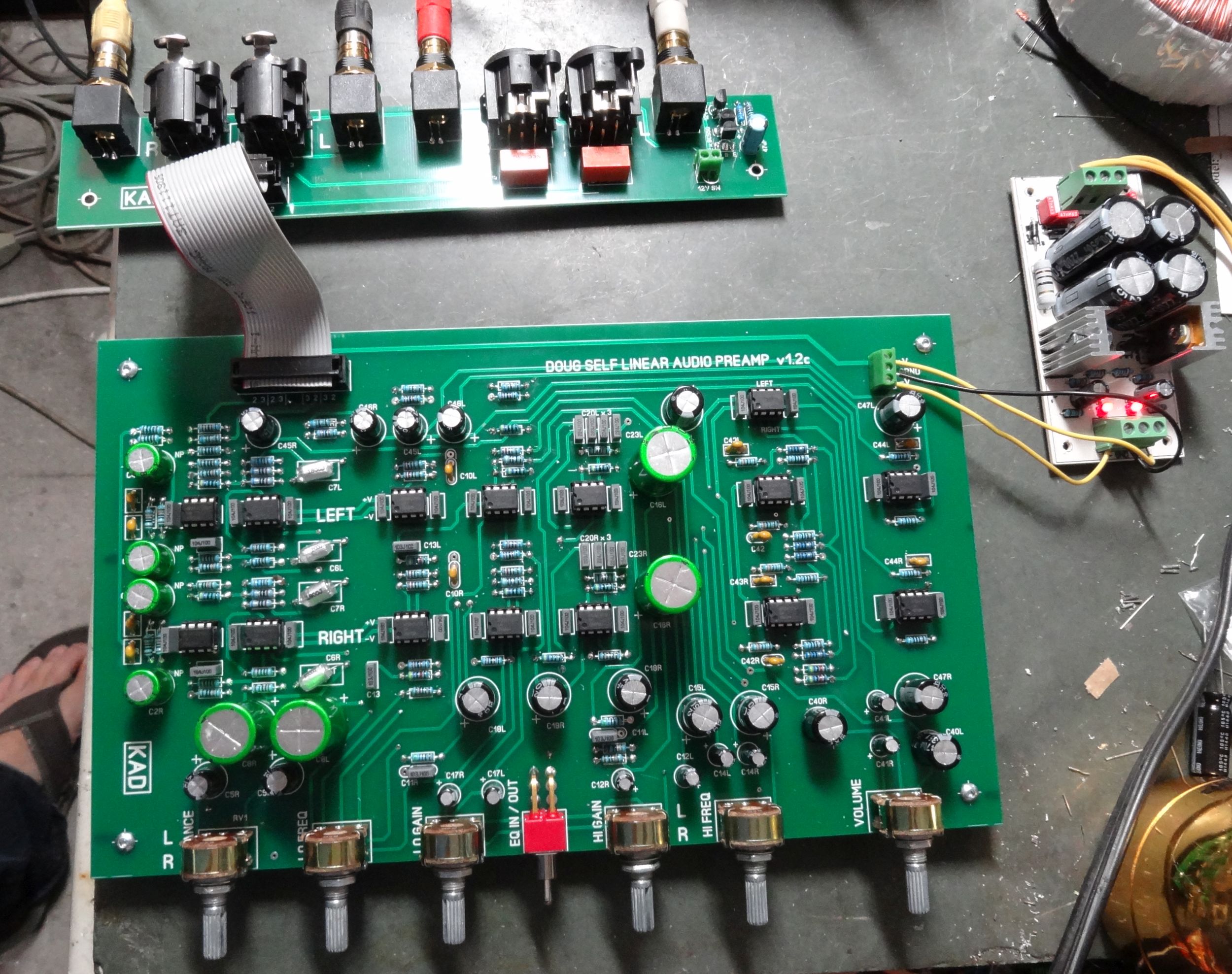

It Sings!! Thank You Carl for putting this together. It sounds Great & i assume it can only get better as the caps wear in. 🙂
Now for some kind of cabinet, & more I/O choices.

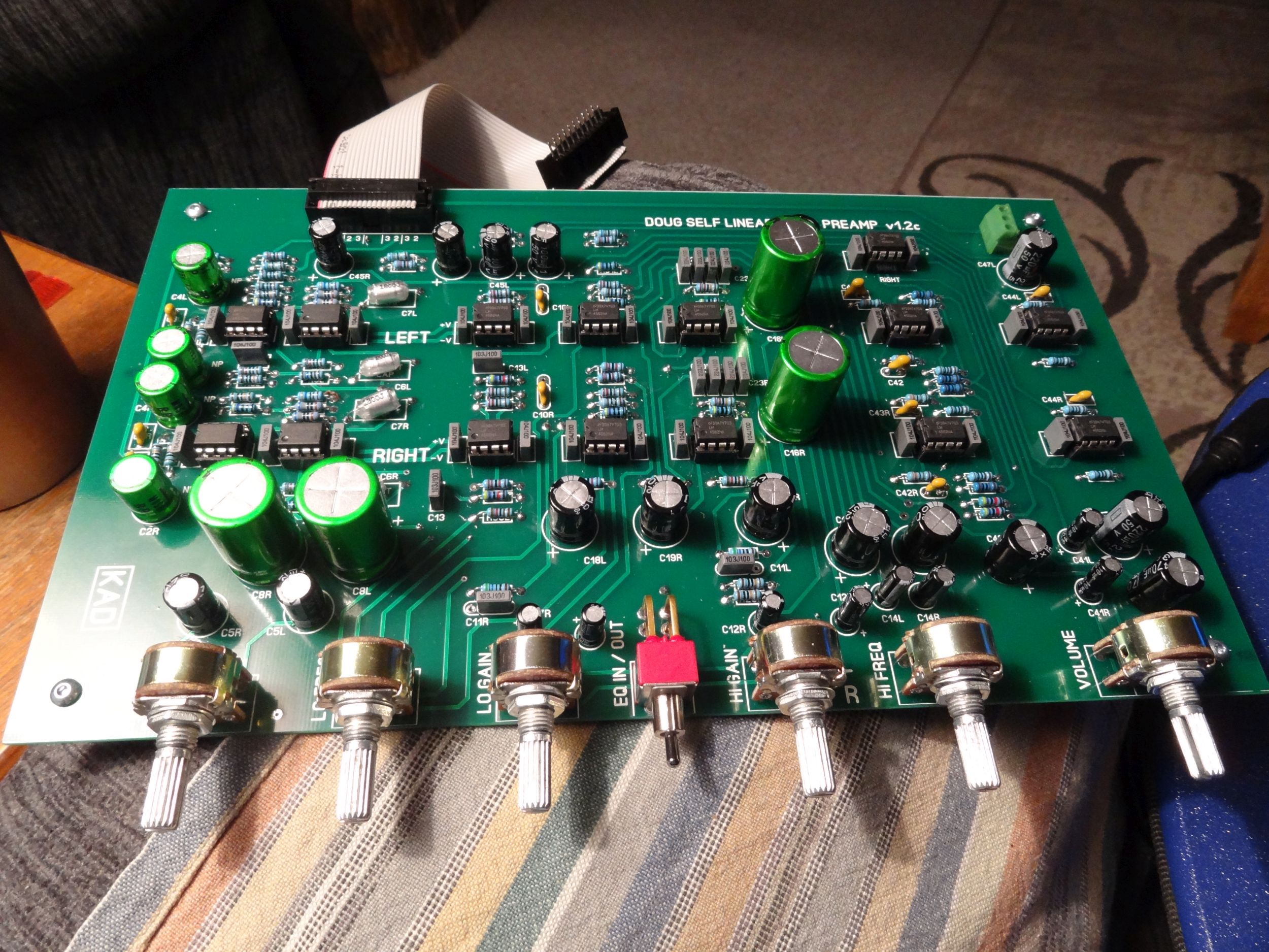

I have my main board populated. As you can see I built most of it from my parts bin and only ordered what I needed so I don't have all those pretty green caps. As soon as the I/O boards arrive I be testing mine too. 😀
Blessings, Terry

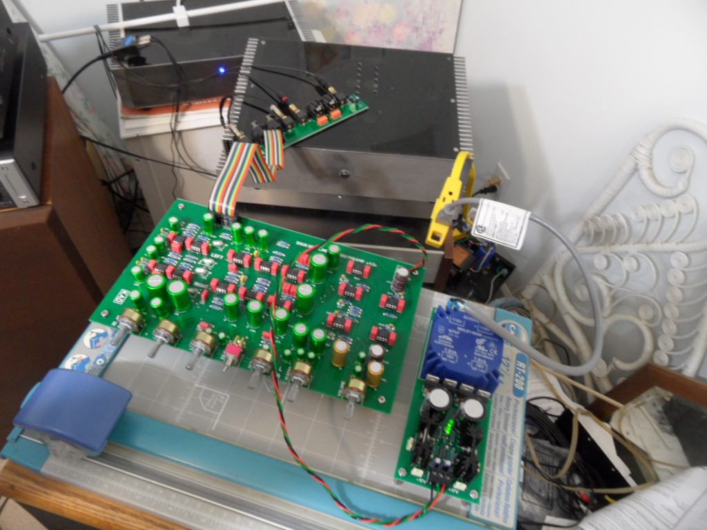

PSU heatsinks are 53C for neg & 51C for pos. Neg V=-16.88 and Pos = 16.36 These measurements made while playing over 1.5hrs now. That more or less normal?

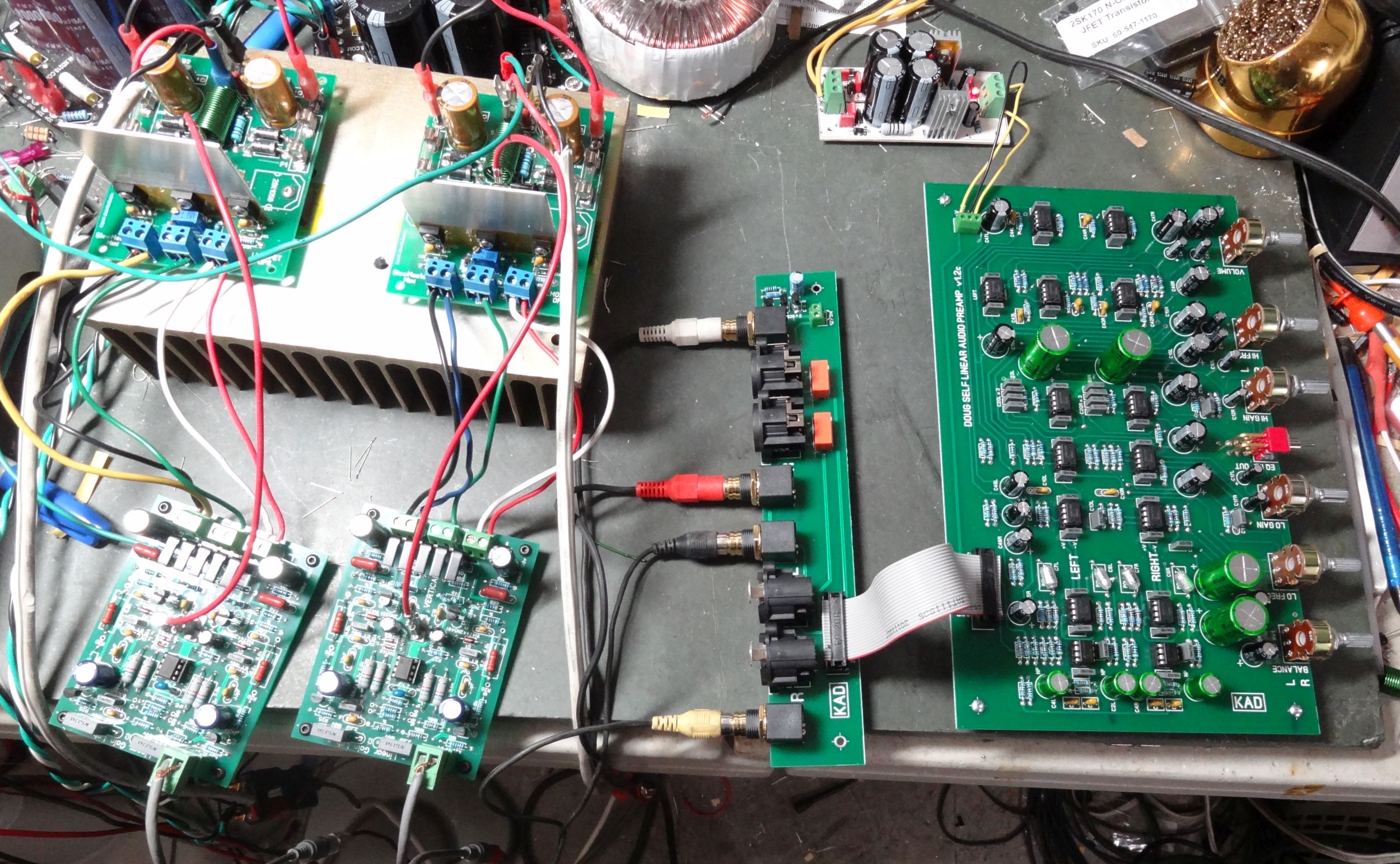

OK it is singing!
Scared me at first when I didn't have an output. A little searching with the scope probe revealed it was the little relays. I didn't realize I needed to jumper the 12v SW. Once I did that all is well. Kind of fun playing around with the tone controls. I'm not sure about the ref points. Almost seems backward acting but might just be the material I'm listening to. It was a fun project. I will likely fit a chassis for this since I don't need big heatsinks. This is my 5th DIY preamp but the first to have tone controls.
I running it on +-15V right now because my 20V transformer hasn't arrived yet. The little PSU I built is putting out +-15v using a 12.6V-0-12.6v 2A transformer. Working fine from what I can tell so far. It's driving a Slewmaster mini OPS and Vertical IPS that I just finished last week. Sounds lovely.
Blessings, Terry
