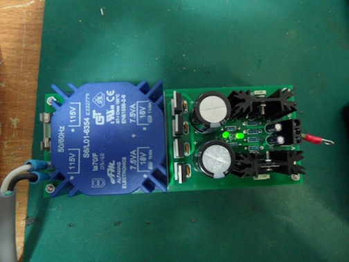

Power Supply up & running. Awaiting rest of the parts. :)

Q1 -BC560CTACT-ND for the power supply is out of stock at mouser and digikey. are there any other transistors that could be subbed?
BC 557, 558, 559 and 560 look to be the same PNP but sorted for voltage and gain. I would think any of them would work equally well in this circuit. Mouser shows that they have a bazillion of the BC559CTA parts in stock.
