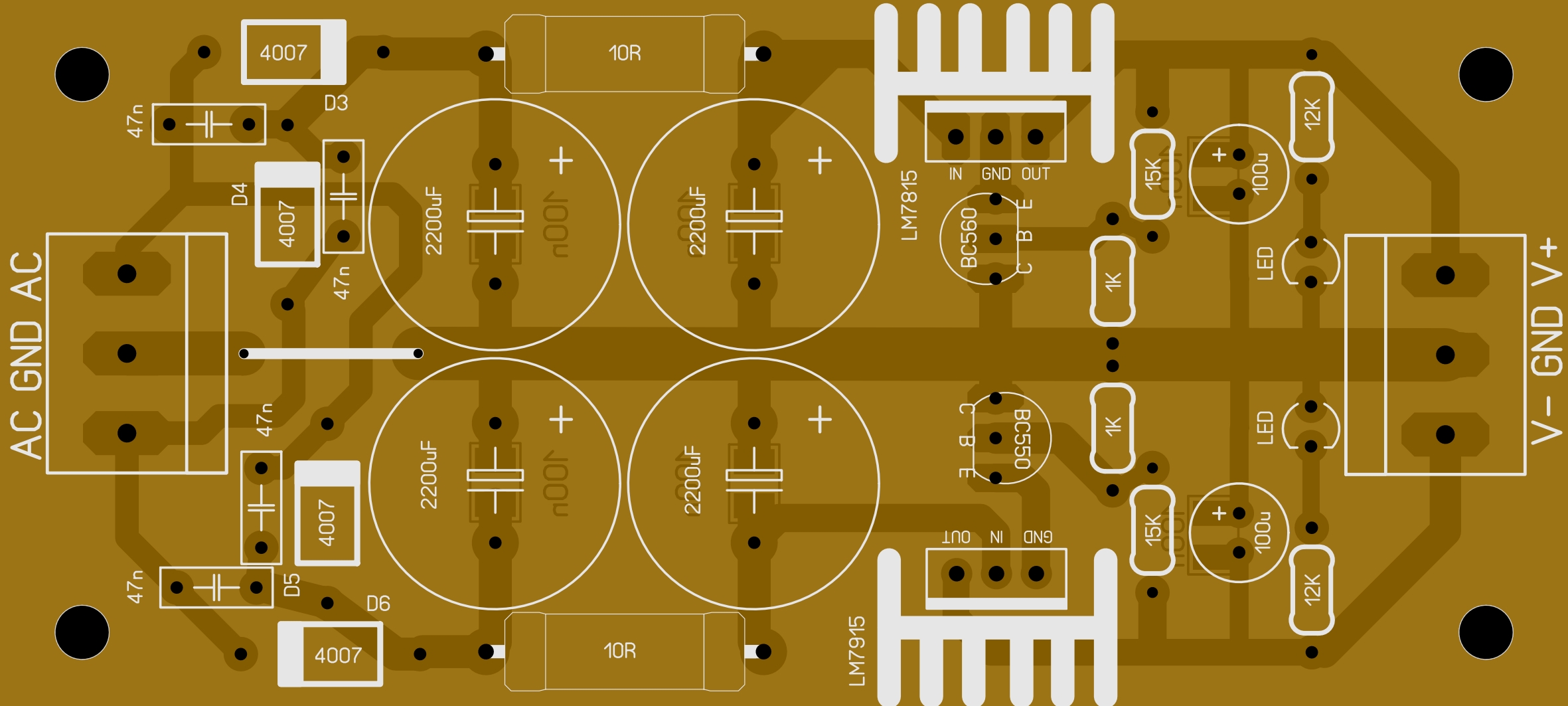

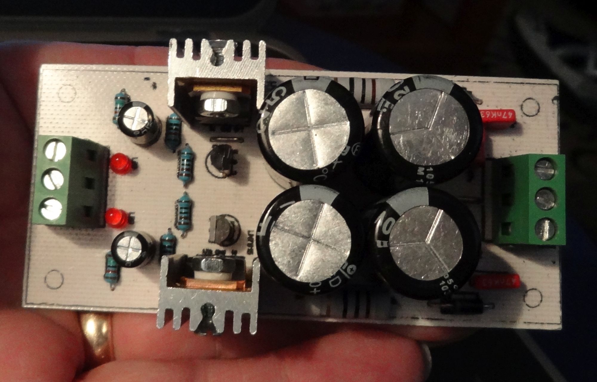

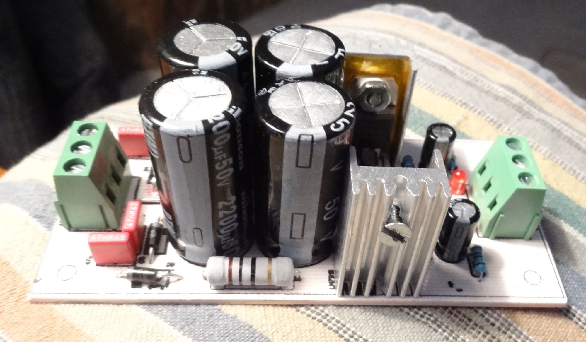

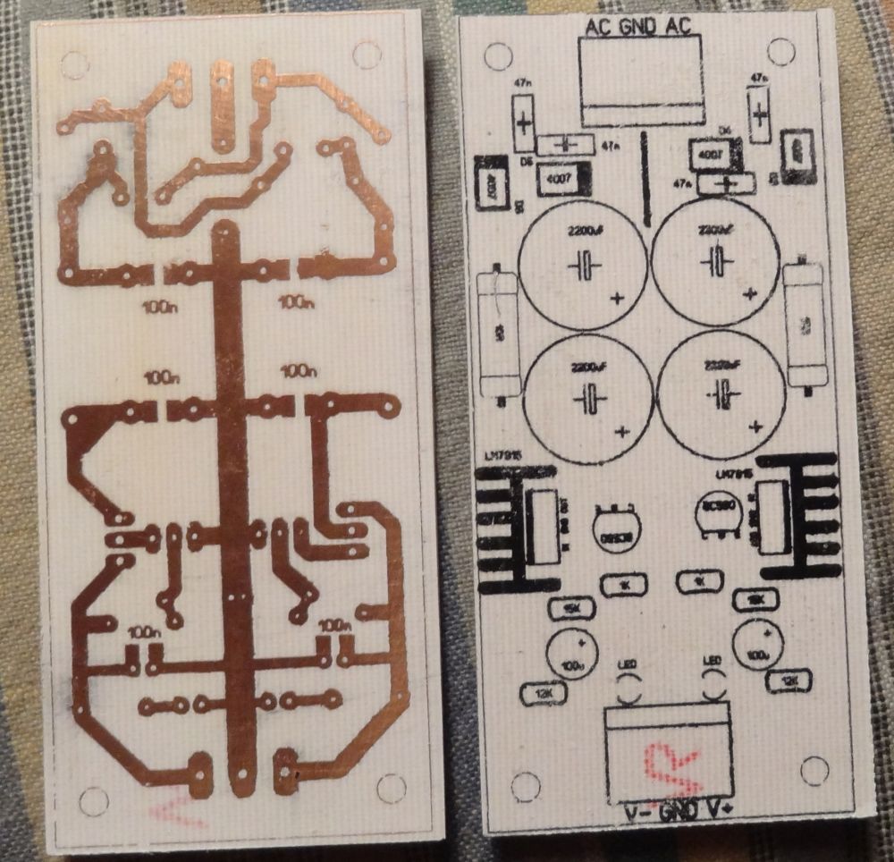

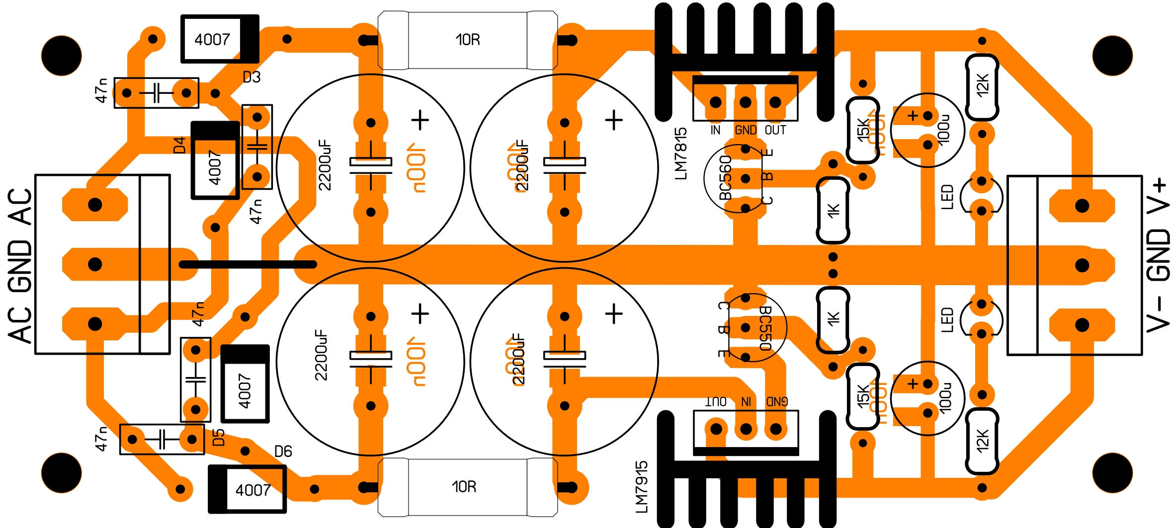

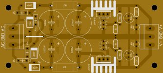

I almost have my boards finished. Just waiting on some parts. I wanted to build a PSU while I was waiting. I drew a layout in Sprint by sort of following my ESP board but using most of the circuit from the Self PSU. It puts out +-16.66vac with a 100 ohm load to simulate 170mA load. Takes 17Vac input to get hold the 16.6v. Anything more doesn't change it. I'm attaching pics. Let me know what you think.
As you can see, I used 4 2200uF caps with a 10R resistor for a CRC front ala ESP. I didn't have any 3300uF cap on hand.
Blessings, Terry
Blessings, Terry
Nice work terry. Looking Good. You seem to be getting the hang of Sprint very fast. 😀

Thanks, I'm having fun with it. The boards are 45 x 93mm. I put the 100n caps on the bottom with SMD's. I can provide PDF's for etching if anyone is interested.
