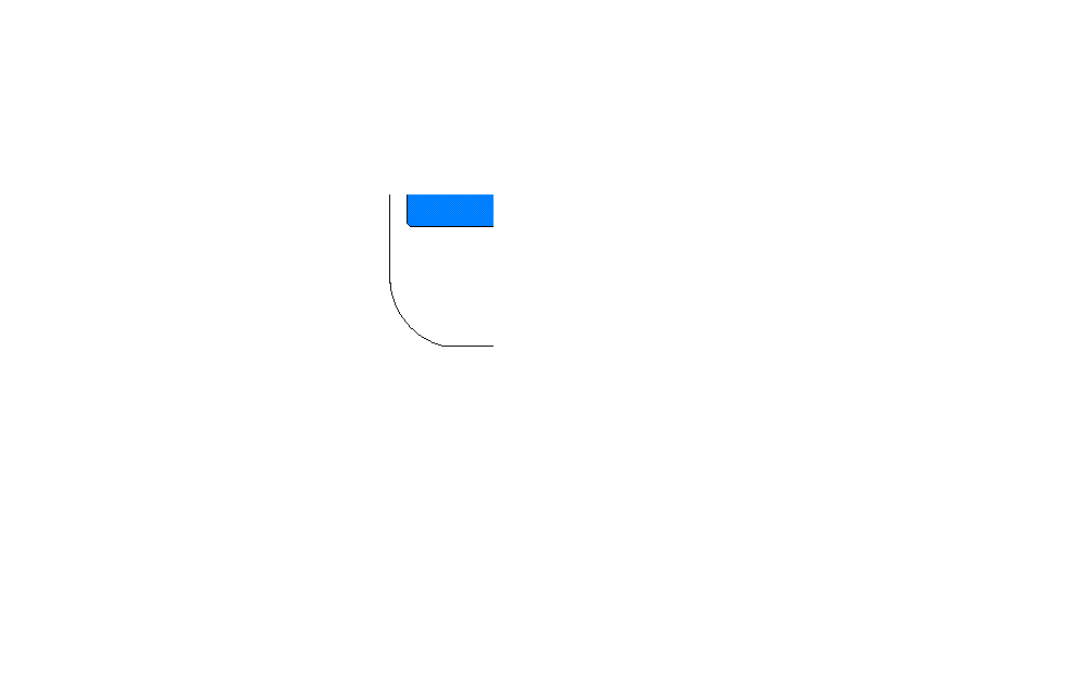

Can you expand your explaination a bit. For example, I butt-jointed two 3/4" plywood at 90 degree to each other. Are you saying that there is a way for me to use one continuous piece of veneer to cover the two surfaces that are jointed together at 90 degree?
Do I need to use a router and router a radius at the joint?
With the right touch on the sanding before hand and a good technique you can wrap a corner that is really a small radius. Looks a lot better than pieced corners.
THere are more than one ways to skin a cat!
Poor cats.
OK how to do this. Check out the crude drawing. THe blue is the speaker or whatever you are going to veneer. Note that on the corner there is a small chamfer ( small as in less than a 1/8th radius ) or even a rounding of the corner. This allows the thicker veneer to wrap around the corner with less of a tendencie to break. The underlying idea is to allow for the more or less double thickness of the veneer some room to bend without the cracking that would normally occur. There are other ways as well:

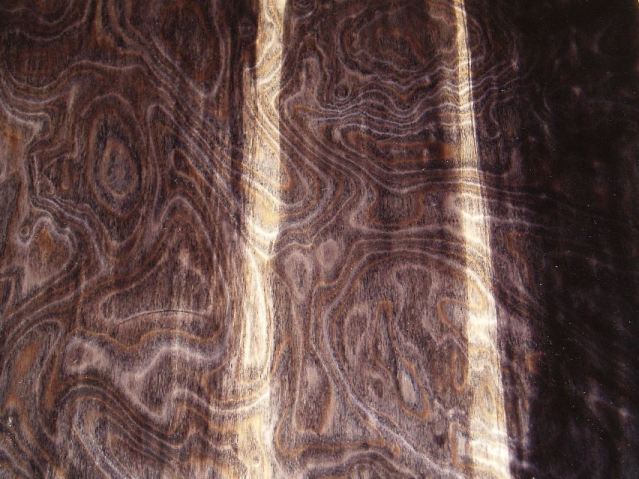

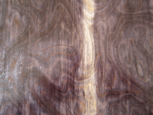

PICTURES!
OK, so these pictures are from my first run at it. I'm not really satisfied with the result so I plan on ordering some more samples and trying again.
My process was as follows:
1) Brush with H20 to lift the grain
2) Plaster of Paris mixed with black RIT dye.
3) Sand back with 200 grit to expose the grain
4) Zinzer seal all wax free shellac sealer (2 coats)
5) Brushing lacquer mixed with transtint black dye (2 coats)
The different bands are different concentrations of dye in the lacquer. And the grain isn't quite that prominent, but is brought out more by the camera flash.

Ok, now come the questions! (I know you're excited 😀 )
1) I want to get more contrast between the black background and the lighter wood grains. How might this be accomplished? (I was thinking of three options... 1) Putting another application of dyed plaster and sanding again or 2) Brushing alcohol/dye after the pore filling, but before the shellac and then sanding it back again. Although I tried mixing the dye directly with the plaster and it did not work at all. So I don't think this would work. 3) Maybe some tung oil before the shellac? As you can see from the pictures, There was OK contrast after the shellac, but the tinted lacquer just turned everything darker... Unfortunatly, without it, there was no depth to the colors. Basically, the black needs to be blacker and the gold needs to be golder.
2) As you can see from the pictures, the filled areas still look rather "grainy". Is there a way to make them more uniform... perhaps not sanding back as much?
3) I don't know how they do this, but the B&W speakers have a quality of looking almost completely black until direct light is shined on them. Then the grains really "pop" like the tigers eye stones. Is there anyway to get this effect?

Well, you could try using an amber stain in your top coat, that would help the highlights. For a darker background, try more coats of black stain, with or without the plaster. Different brands of black stain also give different results, some work better with certain woods. I can't really advise on a particular type, as you have different types in the US to what we have in the UK.
The fun begins!
Hello oh wise one!
Now you have a taste for what can be done but can't quite get there.
Welcome to the whacky world of wood finishing.
The open pores that you see are areas that are not properly filled.
Some questions. How thick and how black did you mix the plaster. Did you just pour it on or did you trowel it on like you would plaster on a wall to push it in and down into the wood. Better yet squeeze it on with a spatula and then rub it in with a rag.
An idea ( now remember this I'm not there and have not seen the veneer in person but I'm guessing that it is a quilted maple knockoff that you are using. Try sealing the surface and then sanding it lightly. You may even tint the sealer a bit. Then try a fill with the plaster. This is definitely an experimental process. When you get to where you wan to be you will know.
The idea is to setup a contrast in the grain of the veneer. Your close to that now. You just have to refine the process a bit untill you get what you want.
SOme thing that I can do is visit the B&W dealer that is close to me and see in person exactlly what you are trying to emulate. ( if he has it in stock )
How much is the veneer? Maybe I could get some and do some hands on and really see what you are up against.

Hi Mark,
Sorry, I didn't fully read your previous post. The stuff I got from Constantines looks almost identical to the link you posted when seen in person. I'm thinking that its probably the same stuff?
Anyway, I fully intend to finish these darn things once I get a little bit of time. I think that pretreating by spraying on a dilute dye/alcohol mixture and then sanding back prior to (or instead of) filling the pores with dyed plaster should hopefully give the effect we are looking for. I'll keep you posted.
-Wes
-Wes
- Does anybody know how to get this finish?
