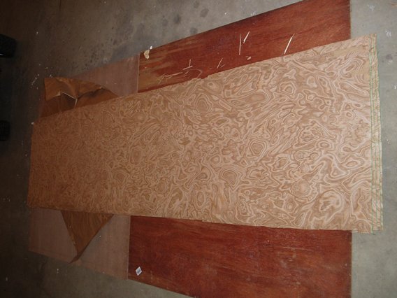

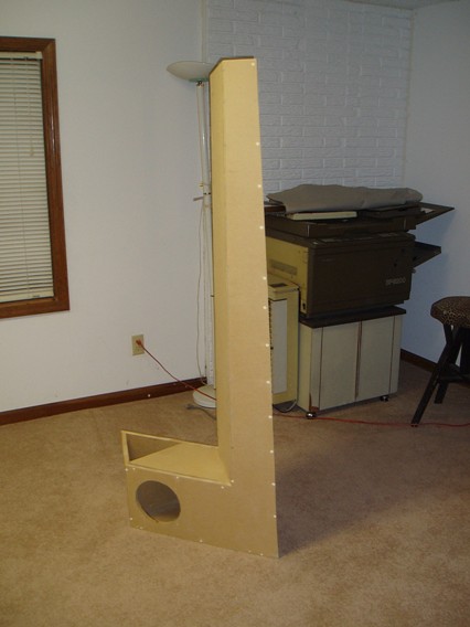

Pics Pics and yay veneer
Ok, I think that angle is somewhere between 30 and 60 degress anyway. Here is a pic of the cabinet, along with the fresh sheets of veneer. This stuff is too expensive, I really hope I don't screw it up. Can you explain further/give suggestions about how to get those corners not to look like crap??
Thanks,
-Wes
Thanks,
-Wes
Re: Pics Pics and yay veneer
NICE wood- where did ya get it? $$ huh
DC
wrl said:Ok, I think that angle is somewhere between 30 and 60 degress anyway. Here is a pic of the cabinet, along with the fresh sheets of veneer. This stuff is too expensive, I really hope I don't screw it up. Can you explain further/give suggestions about how to get those corners not to look like crap??
Thanks,
-Wes
DC

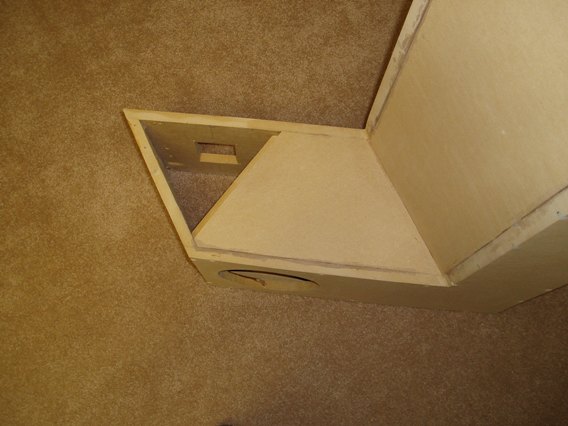

While I'm on a role here. I have triangular pieces that fit in the top and bottom to allow access to the electronics. Does anyone have suggestions about how to attach those?
I want them to be removable, but stable. I was thinking screws, but that might not be convenient enough to remove, and I don't want hinges on the outside.
Any suggestions??
THANKS,
Wes
Any suggestions??
THANKS,
Wes
grrr. Yes, too expensive.
I got it from constantines and it was about $80 a sheet (24'' X 96'') But its MUCH cheaper than quilted maple, birds eye, tamo ash etc etc...
-Wes
-Wes
