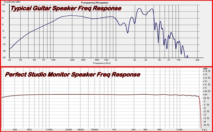

That is also what I am wondering about. The low end heard from a distance in a room will have the open back cancel much of the bass. Recording by near field mic doesn't give the real sound heard.
Such amps [powered speakers], often called "FRFR" (full range frequency response), are meant to be the amp and speaker for the super-fancy modelers which emulate the frequency response of a guitar driver and cabinet as well as a tube amp. The sound going through a "guitar speaker" twice (once through the simulator and once through an actual guitar speaker cab) would be too much, and not "sound good." This also lets the simulator be switched between the responses of several amps/drivers/cabinets without going through the same physical cabinet every time. The Fender Tone Pro is the latest plug-and-play unit, but there are several guitar modellers that can record and save "profiles" of an amplifier/cabinet and recall them as presets later. People swear they sound the same or "similar enough" that many big names are doing tours without carrying the stacks of big guitar amps around.Not so far. There's an amplified speaker combo, meant for guitar, current selling product, that - guaranteed - sounds different than other guitar amplifiers. Because all it does is amplify without adding any character of its own - if that's even possible. All the tone being generated in the accompanying studio-pedal.
I suppose it could be argued that only in the case of the two taken together...would be a valid comparison.
Which arises trhe question "what is the real sound".

@benb agreed, I am convinced this can be achieved to a great extent. At the end a guitar amp is some piece of technical stuff that can be emulated by modern technique. Not emulated will be the directivity pattern of the oldies with their ear bleeding treble focusing on axis - and that is fine for me.
So the modern way will be the venue has the PA, perhaps stage monitors already in place. All the guitarist needs is his instrument and pedal board with the fancy modeler. Direct to the house mix, "gimme a bit more monitor if you've got it" to hear him/herself play.Such amps [powered speakers], often called "FRFR" (full range frequency response), are meant to be the amp and speaker for the super-fancy modelers which emulate the frequency response of a guitar driver and cabinet as well as a tube amp.
The stage monitor being the local FRFR, while the rest of the sound goes out the house FRFRs.

The real sound is whatever the guitarist decides it is. Always was. Doesnt really matter how he / she / they / it* generates it.Which arises trhe question "what is the real sound".
Honestly I think this is more subjective than expected from most of us,
and for that reason the answer will remain vague.

If you look at a plot of a typical Fender / Marshall Treble / Mid / Bass tone stack, ypu'll see that it is anything but flat at control mid-points! Its a terrible tone stack compared to.say a traditional Baxandall, yet that same crappy tone stack appears on many, if not most, half decent valve guitar amps. Something about it that just works for guitar players?There's no objectively correct middle clicking point for a "neutral" tone -- you just have to let all that go and only adjust the volume on a particular dial when your ears tell you to.

Similarly, the hifi community pretends that a flat "on axis" response constitutes some kind of standard, but then everyone arbitrarily toes/tilts their speakers as a kind-of mechanical EQ. Or the polar response "heat maps" have any EQ slope you want, based on speaker size / XO points etc.
The guitar / instrument approach to distortion, I mean tone, is a breath of fresh air in a way, and a reminder that the colourations never really disappear, so they may as well be adjustable.

Exactly. Otherwise tone tacks wouldn't be as ubiquitous as they are. Tone stacks tend to put a dip in the FR were electric guitars may have a less pleasant or overbearing sound, and make the frequencies that may sound better or more balanced for electric guitar more easily adjusted to find a good tone.Something about it that just works for guitar players?

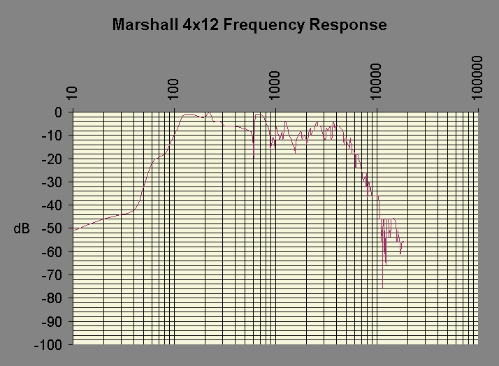

According to this Celestion speaker expert from a Guitar amp manufacturer, the EVM12L is a PA speaker as is the Celestion neo250. It is instructive from his explanation how from 50 to 90 the guitar sound evolved through speakers.Hayk many of the best guitar speakers are just PA middletones that someone has tried and found good for Guitar

Wow. Thanks! I've been educated.According to this Celestion speaker expert from a Guitar amp manufacturer, the EVM12L is a PA speaker as is the Celestion neo250. It is instructive from his explanation how from 50 to 90 the guitar sound evolved through speakers.
I can't judge if he is right about every single thing in the video, but it should be mandatory for every beginner upgrading from, or choosing their first amp to watch that.
