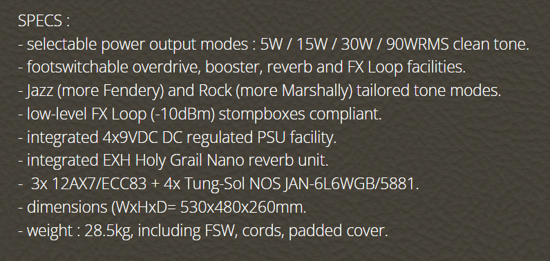

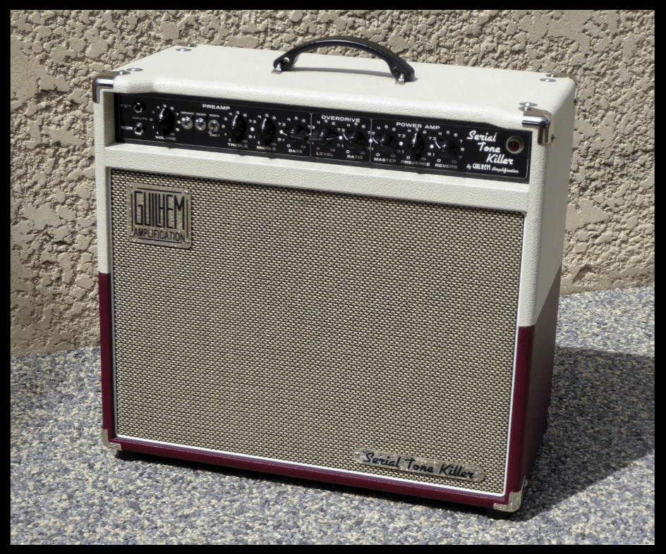

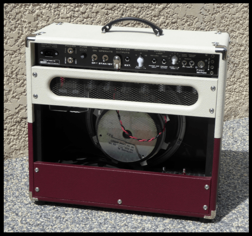

- The EVM12L is a huge, loud, heavy and straight speaker, it stay straight even presented with overdrive, can handle a lot of power, produce high loudness, and still stay straight no matter. I use it in my Serial Tone Killer amp, which is a dual channel amplifier :
The EVM12L give that amp THE big tone I expected to meet his specs, but the amp by itself must be good sounding - if I can say so - because the EVM12L is straight, and so will restore the sound as it is, at any loudness... That's why it's not a very favored speaker to the guitarists, in addition to its anvil weight of 9kg ! 😱

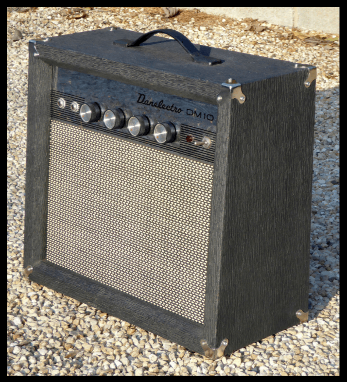

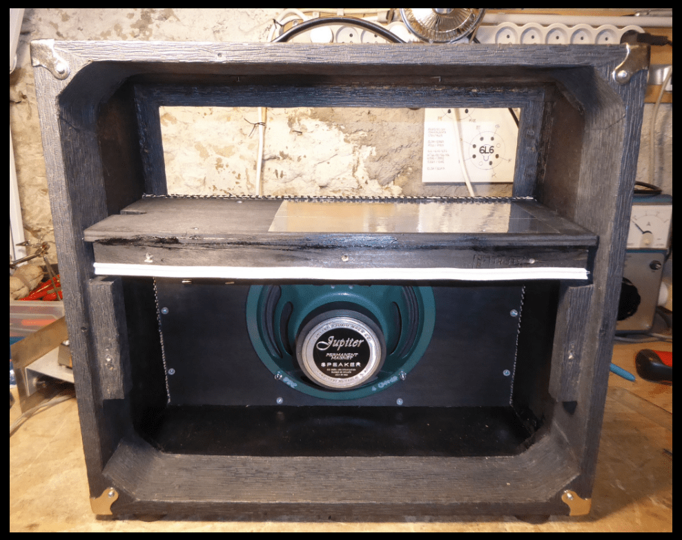

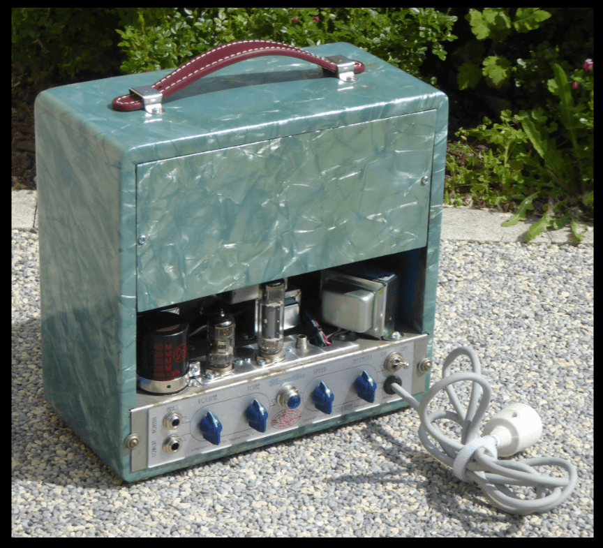

- For the restoration of my little Danelectro DM-10 from 1964, I went for a 8" Jupiter AlNiCo speaker, which gives this amp the cool / nasty / dirty tone it deserves...

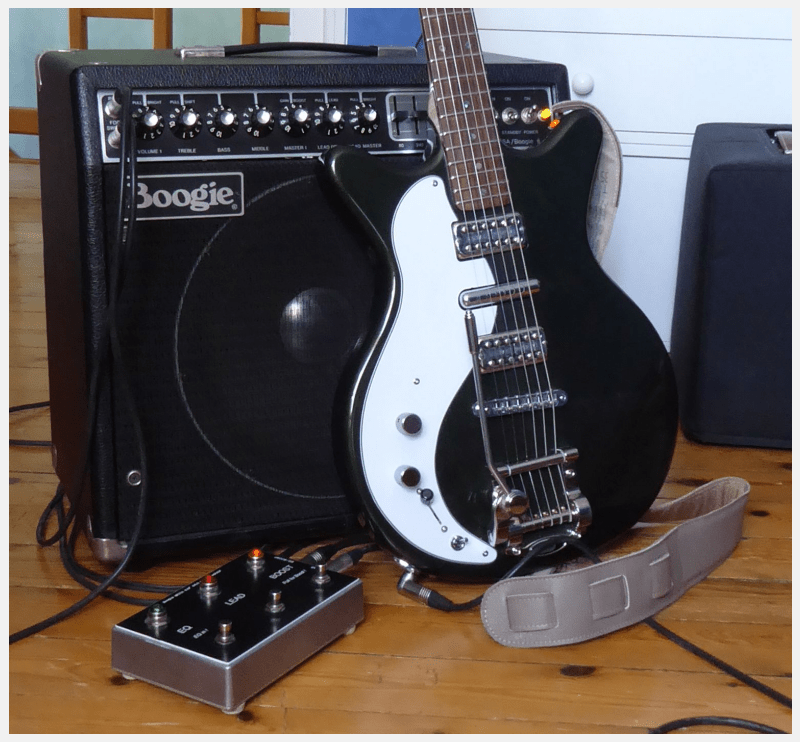

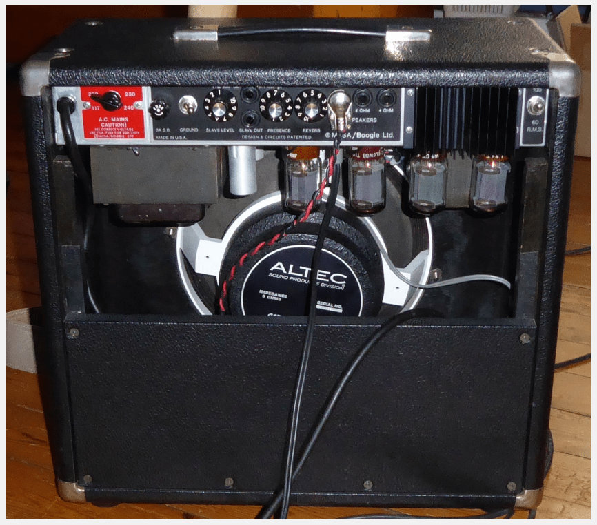

- For my Boogie MKIIA from 1980, I choose the ALTEC 417-8H loudspeaker, for its violin tone when presented to overdrive, often associated to Carlos Santana (the 417-8H is reputedly his favourite speaker) :

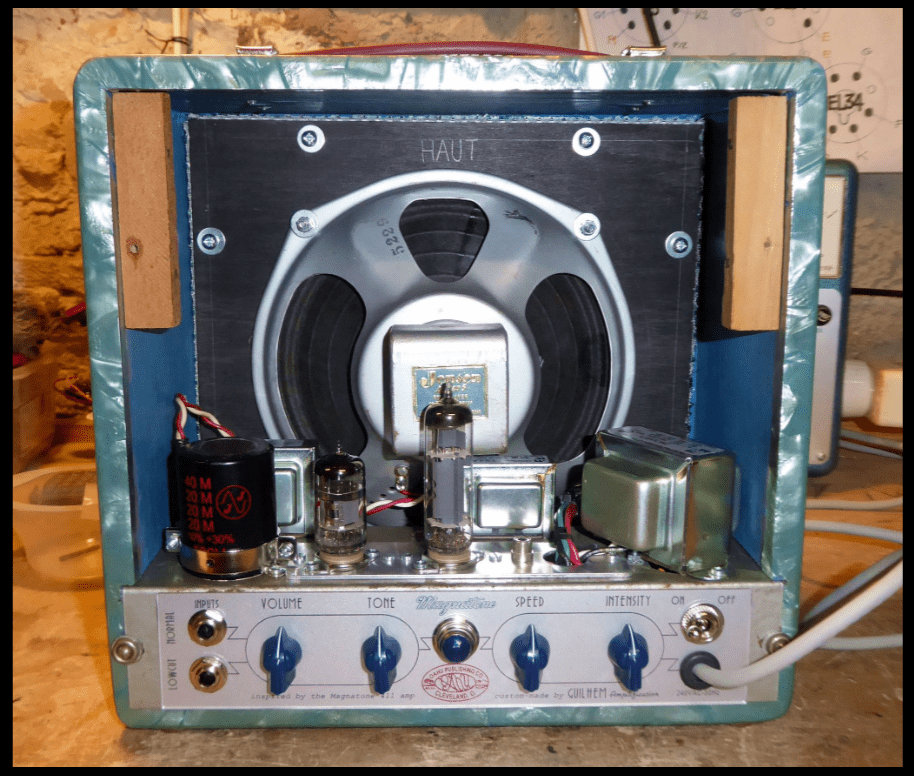

- The Jensen speakers (Ceramic or AlNiCo) are often considered scooped, bassless and trebly - and this can vary from one sample to another... But they are marvelous notably in the 40s-50s amplifiers (Valco and Gibson, etc...), which had simplistic tone correctors, and often lack brilliance, while offering a bassy-midrangey tone which can turn to a muddy-farty overdrive tone . The Jensen P10R or P12R can reveal then an excellent good guitar tone with this kind of amps - below on a 1948 Magnatone restoration / modification, with its original 8" Jensen P8T speaker :

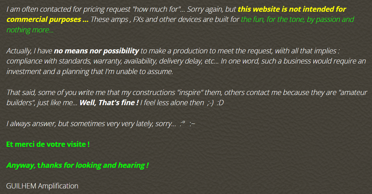

Actually, none of my amps are "commercial products" per se : I am only an amateur builder (audiophile and player), and do part-time servicing, repairs and restoration works for local music and luthier shops friends, and also customers who own valuable items, who come by "word of mouth" or recommendations.
Below, three restorations : two Fender Bassman 6G6 and one Marshall JTM45, from 1964-65.
In the past, yes I had numerous demands for orders, so I had to state the situation clearly on my little website ( https://guilhemamplification.jimdofree.com/ ) :

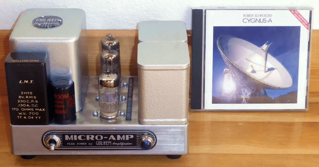

I had several MIllerioux OPT in the past : AH50B, AH26B, H34BN, BH5B, HH25B... Some traded but most bought from the Millerioux factory (I always had Mr Pierre Millerioux on the phone when placing my orders...)
My Micro-Amp uses a pair of BH5B :

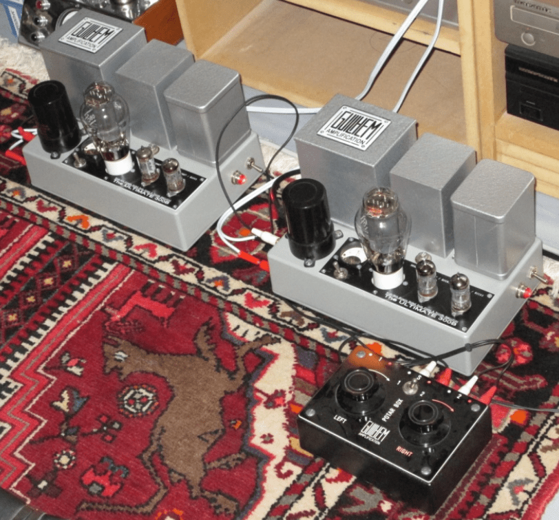

My U-300B uses a pair of HH25B :

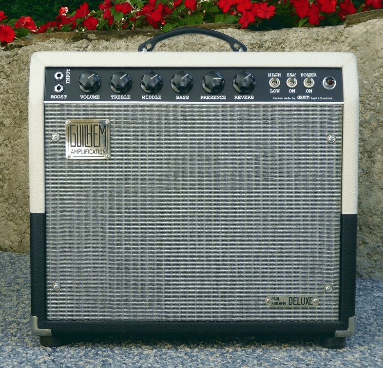

My Paul GUILHEM Deluxe uses a H34BN :
