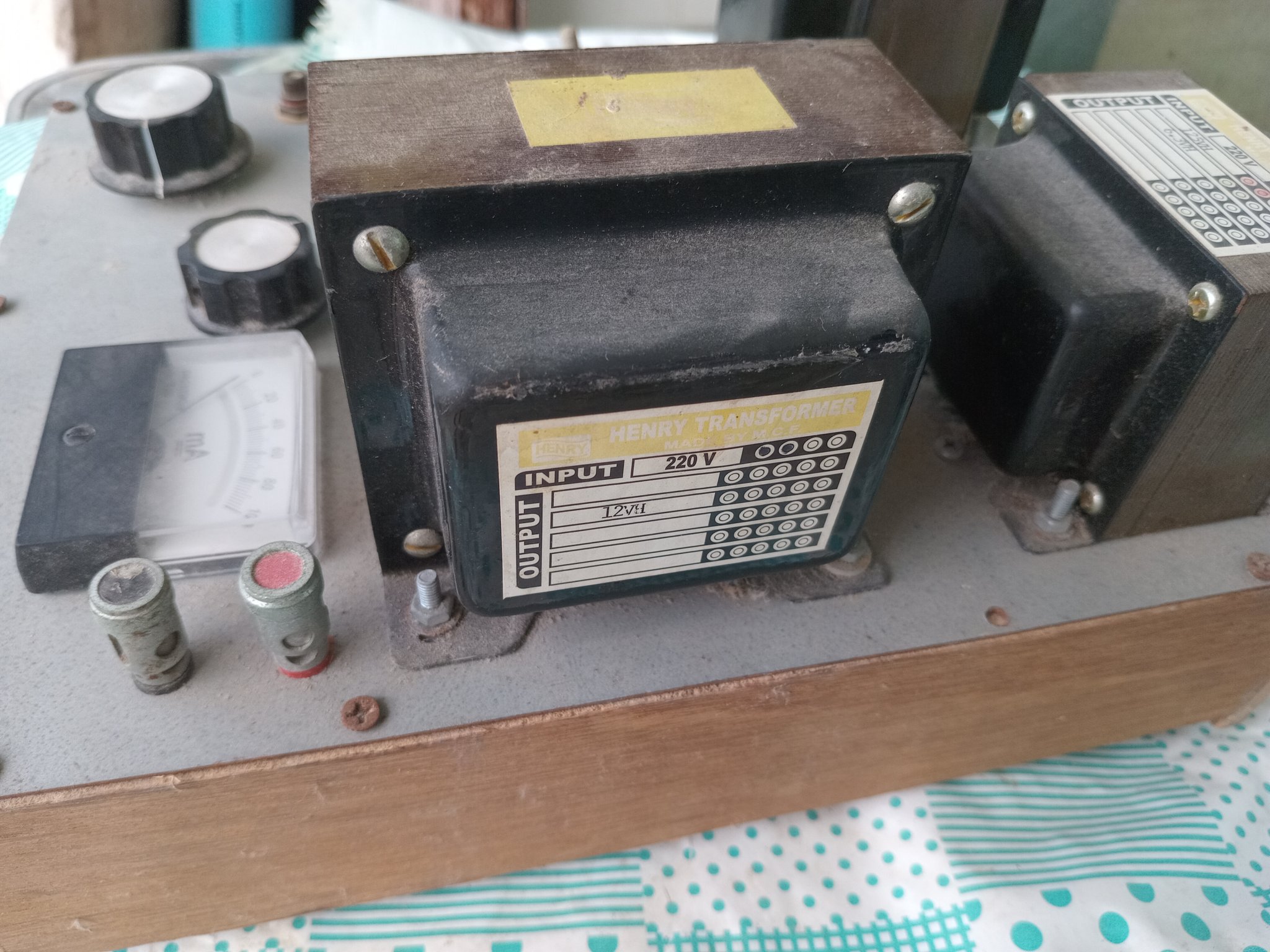

I have done a single ended 6L6GC 70ma bias with 80VA 220/12V transfo, I could get full power down to 40Hz. Why 50VA wouldn't be sufficient for 80hz?
As I will parallel two to drive 8 ohms I need 220/9V.

For 80 to 5khz, why 220v50hz 50W transformer can't be used for single ended 6L6 ? The irons need to be rearranged to make an airgap. 220/10v can work as 4k/8 ohm.
Your 50 watt transformer barely has enough inductance to avoid saturation with 220 volts RMS (620 V Peak to Peak) applied to the primary. In my experiments you will lose a lot of that inductance when you restack the core to create a gap. Power (mains) transformers rarely work well for SE use. A universal (2 X 120 volt) power transformer can be used as an OPT in some push pull applications WITH some derating that will vary from transformer to transformer, so It needs to be tested.

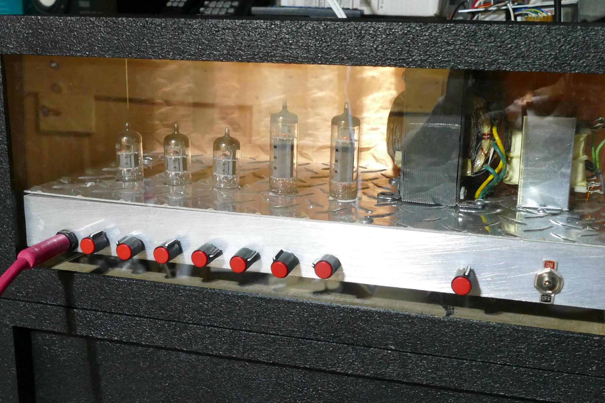

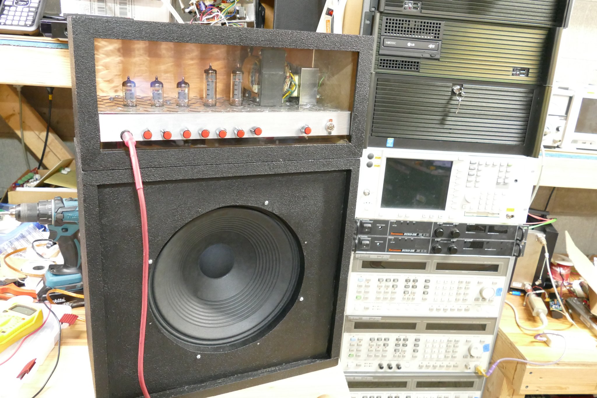

I built this guitar amp as my "lets see what I can make for $99.99" in the Hundred Buck Amp Challenge. In order to squeeze in at just under $100 I used an Antek AN-0509 50 VA 2 X 115 (230 VCT) to 2 X 9V (wired in parallel) to make a 2600 ohm to 4 ohm OPT. The amp worked and made about 17 watts running a pair of UL84's on 335 volts. The UL84 is a 45 volt 100 mA heater variant of the 6CW5.
Now that the HBAC is just a memory and a long forum thread, I ripped the power toroid out of the amp and installed a real "80 VA 6600 to 0-4-8-16 ohm" OPT used as a 3300 ohm to 0-2-4-8 ohm OPT in its place. The OPT is the larger of the two transformers seen in the amp. Power output went up to 22 watts and the sound quality improved greatly, especially in that irrelevant first octave. The low E string sounds crystal clear with for real bass to it You can play full six note chords at a rather loud volume level without IMD........until you roll into the volume knobs.

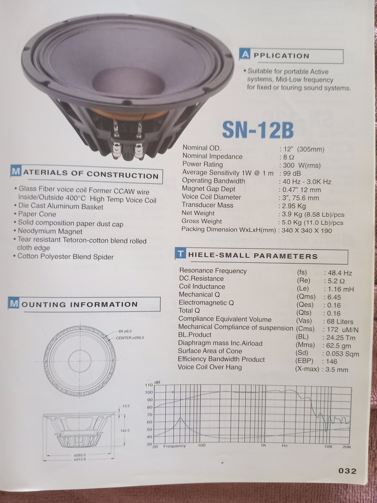

I looked for local speaker manufacturers, I found only one model intended for guitar sold for $18. This brand sells the diaphragms as replacement part that might interest to those like @JMFahey manufacturer their own speakers.
I have 9 PAudio SN12B in array that I might try one. It is intended to be used in large outdoor PA systems in multiple for 80-800 hz. If I drive in current mode, the impedance at 5khz is 3x that of 200 hz giving 10db extra level but it is not expressive above 500hz. Not good for guitar unless I add a reflecting parabola. I bought 12 years ago for $80 a piece. It is used in occidental world in pairs with front horn loaded for very high efficiency woofer.

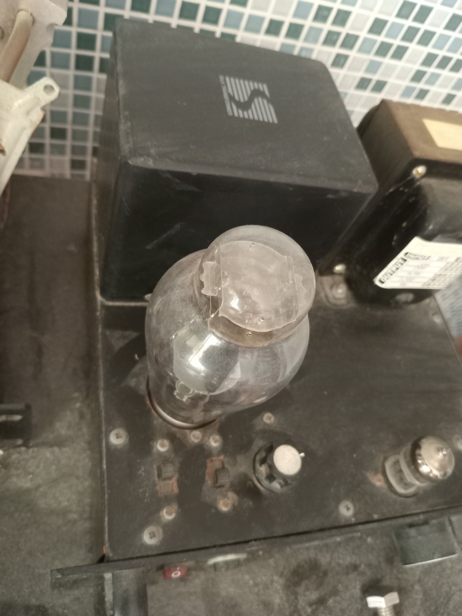

@tubelab, I had inverse adventure with power supply transformer.
While conceiving my 300B/2A3C SET, to determine the correct load, I ordered beforehand from a local power supply transformer winder a 48VA 270v/ several outputs. I chose the right ratio and ordered an expensive 5hz to 100khz 20W single ended OPT.
Of course the bass and high frequencies got improved but the voice range lost most of its presence.

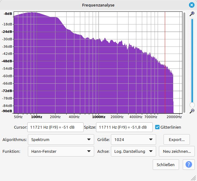

I analyzed the spectrum of the sound sample. It shows indeed a max around 100Hz.
Keep in mind the record includes the bass drum as well.
Anyway for that style of guitar playing 80Hz cutoff maybe feasable
