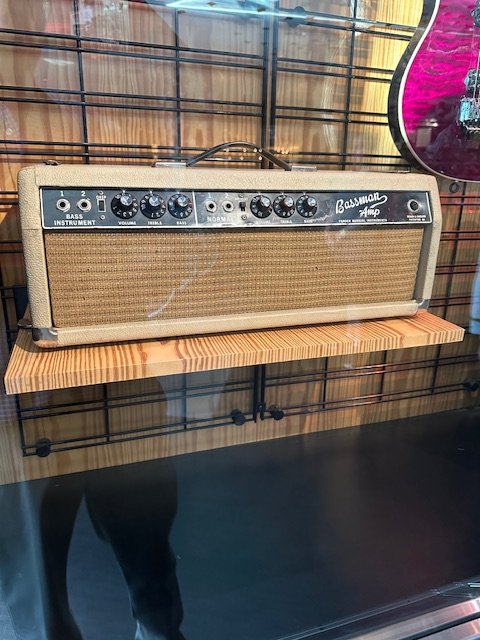

The original 1952 Bassman was the 5F6-A. It is true that the Marshall JTM45 was essentially a copy of the Bassman circuit of the time, but with changes in parts like tubes, transformers, capacitors, etc.
However, before anyone reading the rather hyperbolic statement above seriously, you can find many, many different approaches to guitar amp design, tube selection, operating points, voltages, filtering, tone stacks, and other features. There are plenty of schematics available for you to verify this.
That Dumble used Fender designs as a launching point, and later in his life pretty much stopped building his own amps and just gutted and modified Fender amps for clients, does not mean they are copies of the Bassman. In fact, many of Fender's own amps are not copies of the Bassman.
Just happened to be at the Rock and Roll Hall of Fame yesterday:
