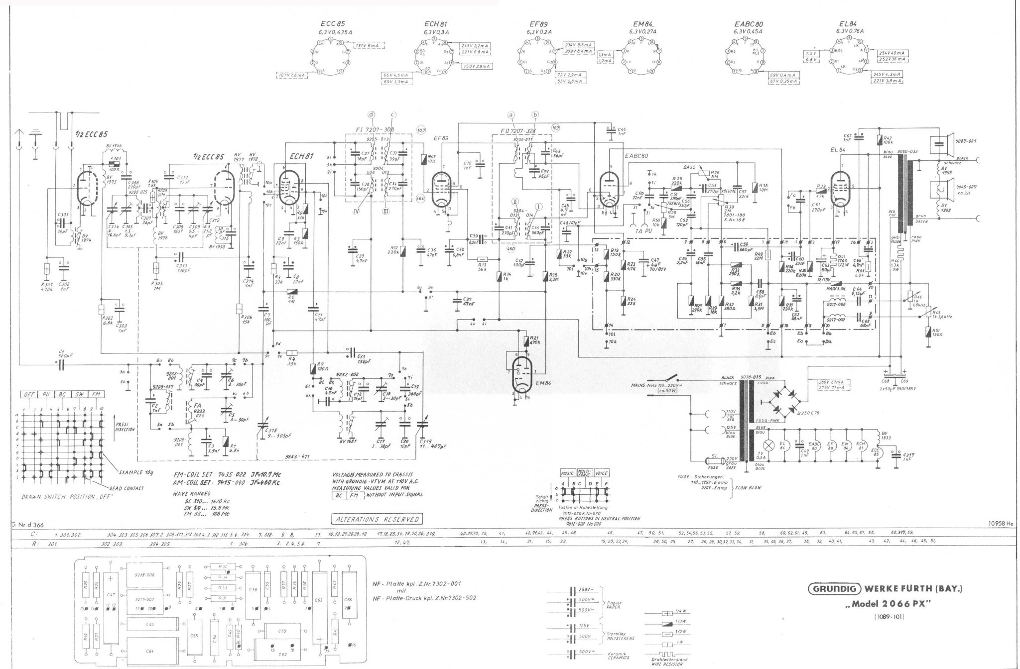

Speakers transform the current of the voice coil into sound pressure but not in all frequencies. Bellow resonance, the current results displacement. At resonance, speed and above EBP, gradually becomes acceleration until the diaphragm breaks up and becomes back speed. Acoustically, frequencies above the frequency fixed by diameter of the diaphragm, 1khz for 30cm, the speed transforms into pressure. Bellow, the acceleration of the diaphragm becomes pressure. The art of designing the diaphragm of open back speaker, is maintain speed to pressure on the whole spectrum.
This is a Grundig radio of high quality with electrostatic tweeters that the speaker is driven in current mode. Look at the break up frequency compensators.

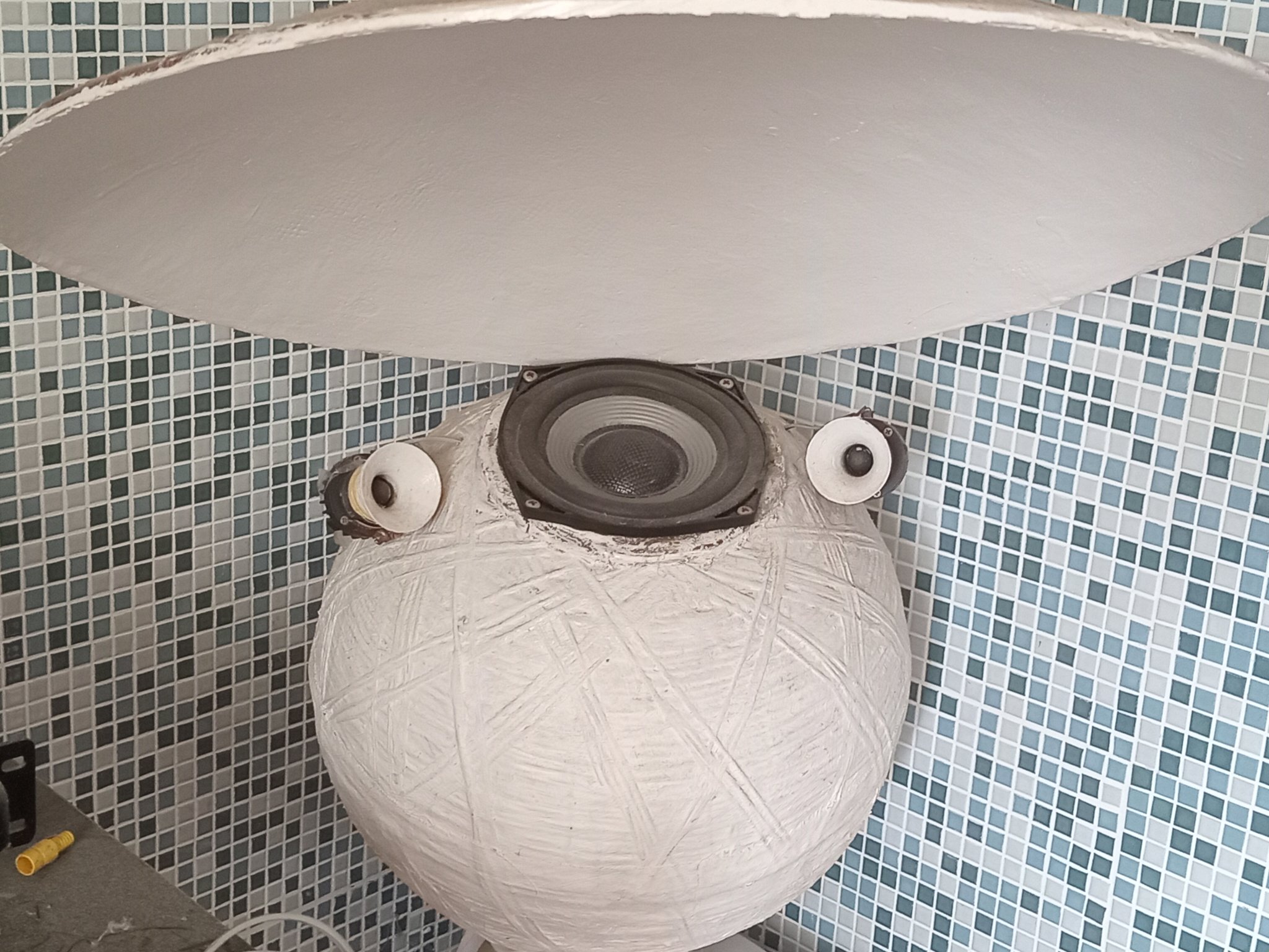

There is another way of increasing the presence of the speaker other than horn loaded is parabolic reflector. When the direct radiator was invented, the problem compared to horns was lack of presence, a term introduced by Bell Lab. A French electromechanical engineer Joseph Leon got an idea to load the speaker not on horn but on reflective ellipsoid and founded in 1938 Elllipson. The idea existed beforehand used in last generation of phonograph where the cover made part of the horn.
This is my version of it that makes a 6.5" speaker behave acoustically as 60cm diameter. The driver I made it from a PAudio midrange a longer stroke voice coil and JBL diaphragm keeping the carbon fiber cap. The efficiency is 97db/W/m 6db increase with reflector. Of course the guitar version doesn't need closed enclosure and can be very compact with the reflector replied.
