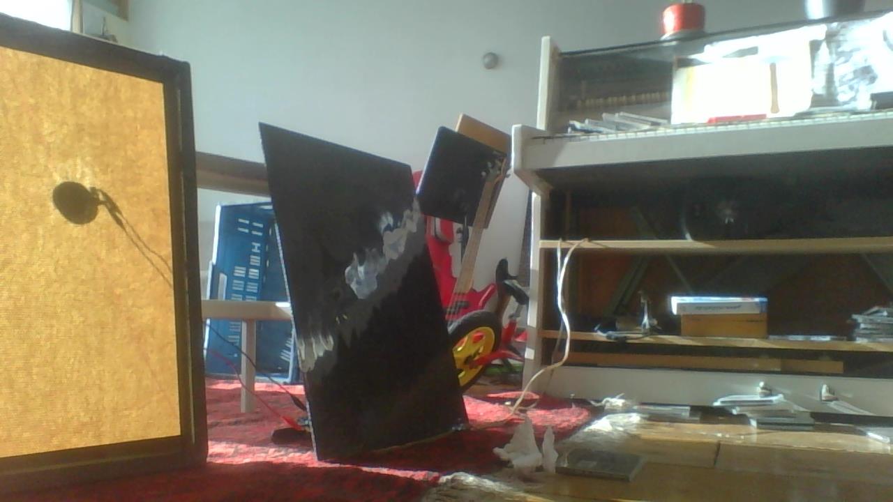

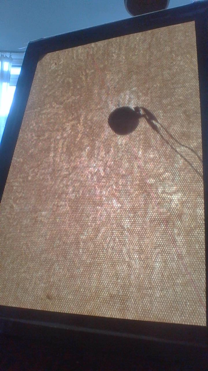

Experiments continue. Made a nomex/carbon panel, and a nomex paper-epoxy impregnated. The paper panel is much lighter, but of course not as hard and stiff. The carbon has 200 g/sqm skins, too much I think - I'm hesitant to buy the thinner carbon because of the expenses.
The paper panel sounds "better" than the carbon, but that may be because there's less upper mid and high freqencies, and more lows. The paper panel sounds a bit more "cardboard -y", it is an expensive and stiffer cored cardboad panel with impregnated skins after all.
It was again easier to make than I had anticipated.
Pictures with web cam, sorry for the quality.

@HvdZ
Nice, can you teel a bit more about the process you use?
I did get some nomex and carbon fibre, but only got around to doing some experiments with glass fibre, but found it tricky to ensure that you don't use excessive amounts of epoxy but still get good adhesion, and ended up liking the GPS so much and never got around to try out the carbon. It is a bit tricky since I don't really have good space to work with it, so it has to be right season to be able to do it on the veranda...
I have some of this: https://www.carbix.se/product.html/kolfibervav-flattow-62g/m2-plain
Designed some grills for my plates now to add some protection for the GPS, and will probably stick with that for this version of the speakers, but I'm very curious about lamination and hopefully find time to try out a carbon plate during the spring.
Hello Leo,
First a disclaimer : I'm familar with working with fibres/epoxy/foam (boatbuilding). But I'm no expert.
I followed advise from easycomposites to thicken the glue for adhering the nomex with fumed sillica, and "scrape it" over the laminate to make a kind of microfillets. They show it here from 15:00 https://www.easycomposites.eu/learning/mouldless-carbon-fibre-aero-wing
The proces of making the fibre plates and glueing them to the nomex in one go was my own idea (I'm not so patient), but it's been also described here : http://www.ofremmi.info/HowTo/HonecombPanels/how_to_make_honeycomb_panels.htm
I applied the epoxy to the release film (with a brush), let it soak through the carbon cloth (you can look under the film if there are no dry spots), then made some extra thickened glue, applied that to both pieces of cloth, and sandwiched that between sheets of mdf + quite a lot of weights. I used too much epoxy (also for the wetting out of the cloth), because I was weary of the nomex not adhering. Too much epoxy will make the cloth "float" on the release film, and that's not so beautiful (and heavy of course).
I hope this helps.
One thing : if it's to cold (on your veranda) the epoxy will be thick, and difficult to apply thin enough.
Greetings, Hans

This looks like Nidaplast, of which I have a 2.4 x 1.2m sheet in my workshop.
Precisely. Although we can purchase the honeycomb and experiment with different material skins.
My approach is not so much the "best material" per se but the compromise with the material tonalities to use less EQ. On other hand i`m trying to solve the crossover point problem, pull the subs to the 150Hz region is not the best option for me.
For example, the combination of polyestyrene with cedar guitar top wood in the front skin, (ex: first on the honeycomb center and the second around that) with the flexibility to use other material on the back skin (ex: accoustic foam diffuser),
