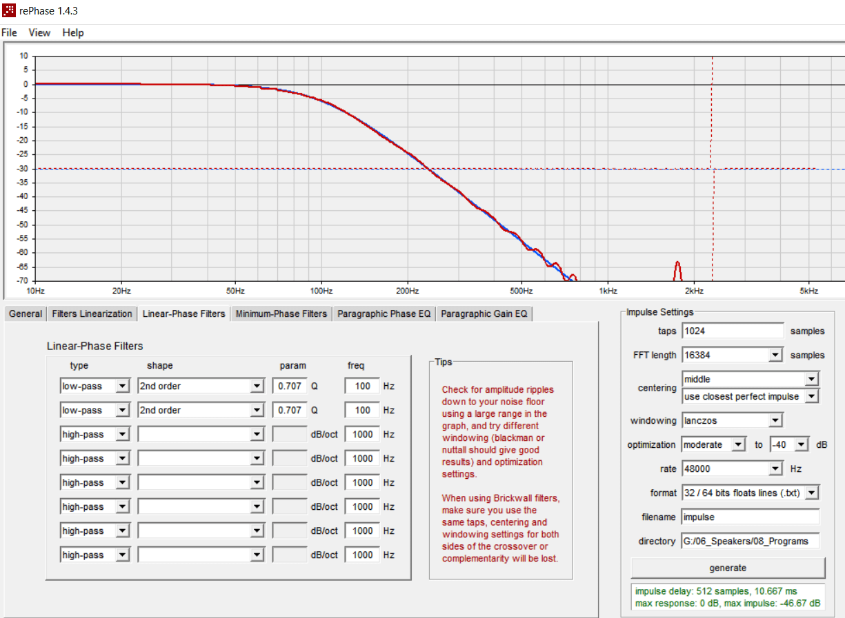

A 4th order LR lowpass at 100Hz is possible at 48kHz and 1024 taps with a tiny bit of ringing.This means that you can not do anything in the bass really. It's just too little. My Mac Mini from 2012 run 160k taps as we speak - with 17% load. What was your plan for FIR?
S/N ratio ≤112dB - this means that SNR = 56dB is within spec ;-)
Nice subs!!!
A 2nd order highpass at 100Hz is also JUST about possible with 1024 taps.
At 96kHz, you need double the taps to get the same.
Or 4 times for 192kHz.
I would consider that the absolute minimum (if you want to include the 100Hz highpass filter, otherwise you can go lower)
For just some param EQ with a relatively low Q and boost/cut it's probable also fine for anything above 200Hz.
I think in the order of about 16384 taps for 48khz or 65536Hz for 192kHz would give you enough wiggle room.
Just put the response in rePhase and just see what fits! 🙂

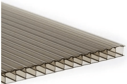

Normal Twinwall polycarb as-is, with careful edge damping, and a few coats of spray-paint, is one of my favourite solutions. I use 5mm thickness. It is anisotropic, but this could be an advantage when building very tall or very wide panels.
I believe there's a polycarbonate honeycomb available from a manufacturer in Belgium.
https://econcore.com/en/technology/technology-for-licensing/polycarbonate-panels
Now THIS is what I would consider first-prize, taking into consideration sound, ease of manufacture, longevity and price.

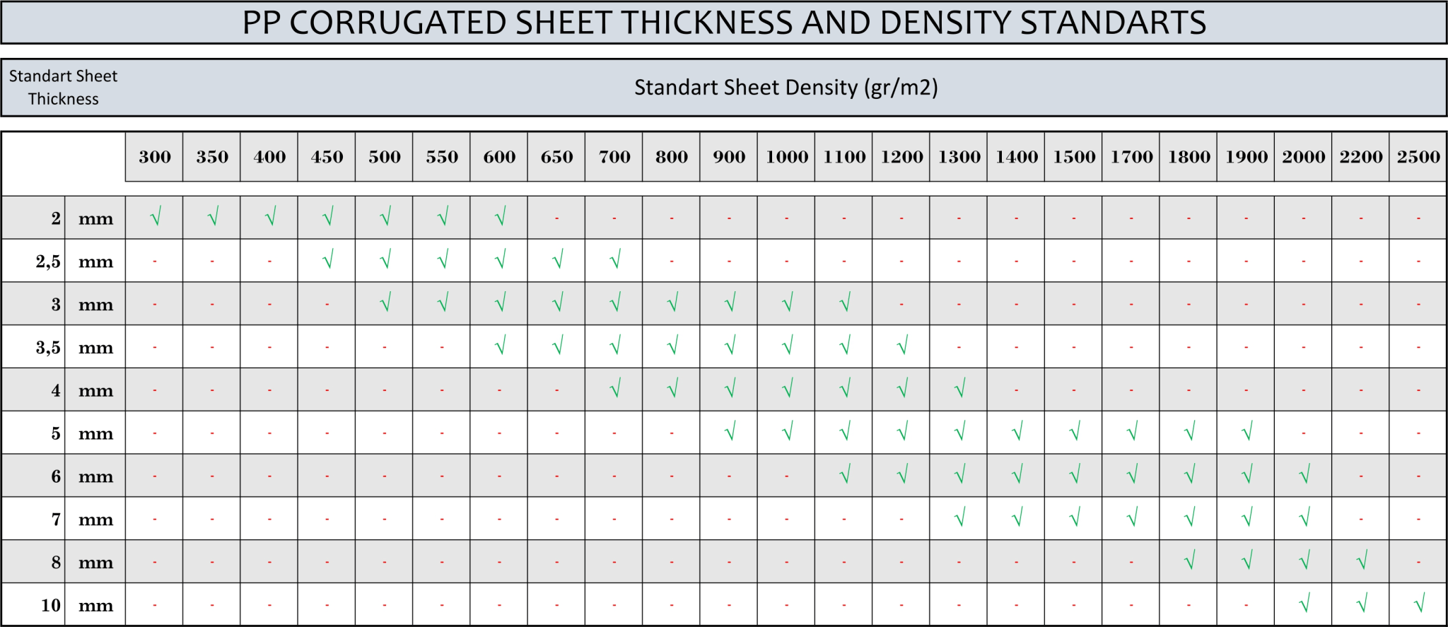

Other possibility:I believe there's a polycarbonate honeycomb available from a manufacturer in Belgium.
https://www.hexapan.com/?gclid=EAIaIQobChMI8KHes9HrgwMVggaLCh1QuwDiEAAYAyAAEgJ6dvD_BwE
RMAM, the stuff you are posting is all Polypropylene (PP) - very different to Polycarbonate and probably not well suited for DML.
