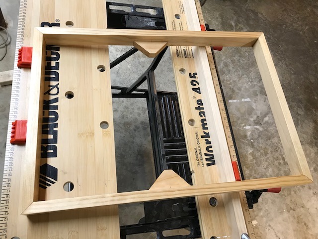

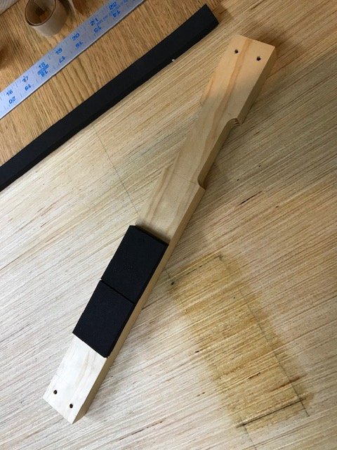

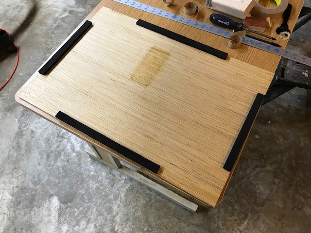

Yes, I use printed parts for the corners, in which I slot in wood ribs. You can use wood, glasfiber or even plastic for the ribs.
Like I said you don't need much stiffness or even worry that much about vibrations, the frame only clamps the plate lightly on a few points with foam isolating the vibrations from the plate.
I can say that initially my frames dampened too much, and I had too reduce the foam used for clamping to two 20mm per side, otherwise response in bass region suffered.
So the job of the frame, apart for offering enough support to hold up the plate, is really just to dampen the plate and control FR a bit by touching it slightly.

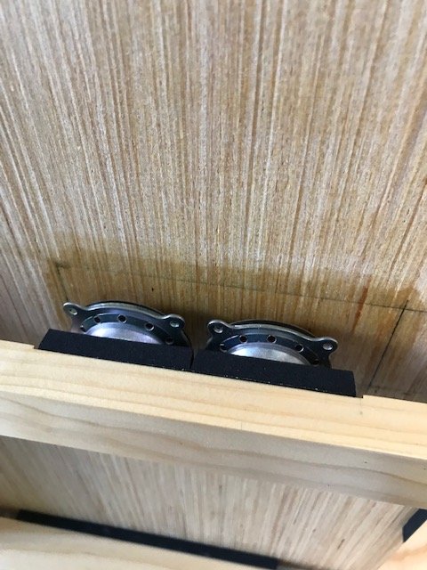

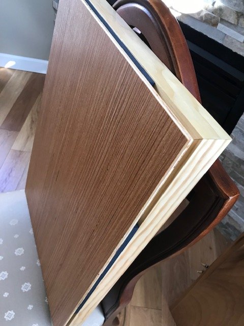

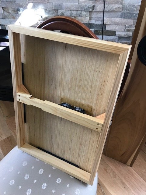

Not sure if this helps, but here are some images of a fairly simple and light frame construction for my 400 mm x 580 mm plywood DML. The framing members are 64 mm x 19 mm pine. Perhaps something similar might work for you. I can weigh it later but I suspect each speaker is under 1.5 kg. The main drawback of this design for you, I suspect, is that the frame does nothing to protect the face of the panel. However, I think there are some easy ways to fix that, which I could suggest if you think it would be useful, although it would all a little more weight.
Eric
Eric
Obviously my frames would not handle proper road abuse for long. The wood would scratch and dent if not handled carefully, and I certanily would need a mesh to protect the plates.Hi Leo

Having said that, they are cheap to make and fix if something breaks and are very light, so they are perfectly fine for me that use them maybe once or twice a year and have plenty of time between events to service them if needed.
I think Tectonic uses molded aluminium, probably not because the plate needs that stiff a frame, but because it is easy to manufacture in series, very strudy and reasonably light weight. Then they have proper steel grilles for protection.
I would love a design that is as sturdy as that, and would think it is worth the extra weight, but it is very hard to DIY.
I think the kind of design I use is very easy to implement and gives a lot of freedom to adjust the look, wight and sturdyness to your liking.
For example, you can use aliuminum profiles instead of the wood ribs and add grilles, then they would be quite sturdy but still easy to build and fix. The 3D printed parts is not a concern IMO and will stand quite a lot of impact and bending force. There are also specialist filaments that can be used to make them extra strong.
Regarding how much suspension they need, that is something you have to adjust carefully depending on the plate material and dimensions and compliance of the suspension material. My initial attempt I did it similar to Tectonic, but with my GPS plates and the foam strips I used they ended up way overdampended. Perhaps nomex-carbon needs more damping, at least if you have very thin carbon skin. But your plates are probably different than the ones they use even if materials are the same, so again you have to do trail and error.

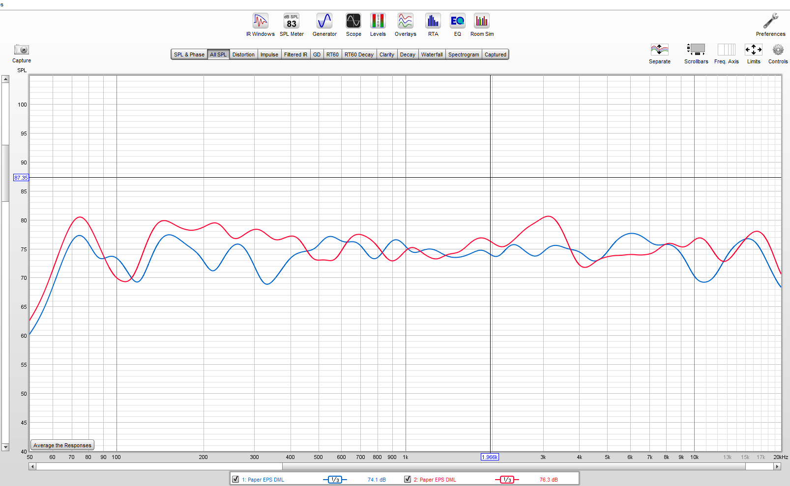

Sooo I've been playing with this... after battling with Tectonic exciters, and multiple variations of substrates and laminates, I've eventually settled on 20mm EPS with paper skins which sound kinda ok.
The screen-shot shows FR curves for two panels sized 460 x 770mm and measured nearfield (50cm). The panels are fixed, undamped, on their long sides, and the short sides are unsecured. The drivers (one only per panel) themselves are bolted into a stay, and mounted on 100m dia polycarb discs behind a 105mm hole cut out of the EPS. Three blobs of hot-glue secure the polycarb discs to the EPS. The paper skins are the only damping.
As the other pic shows, I WAS going to do a hybrid open-baffle with a 15" high-Qts driver for the extreme lows, but the slight bass loss vs better dynamics and definition (without the cross-over and additional woofer) is a no-brainer. So these curves are for the panel only.
The difference between the curves is due to the amount of glue used to secure the paper to the EPS. The panel with the flatter response (blue) weighs about 240g in total, and t'uther (red with the peak at 3k) is about 290g. Too much glue...
Next step: Drive this baby with 4 exciters per side and see if I can use it for live gigs. Each panel SHOULD handle around 160WRMS. And at around 99dB/W sensitivity per panel, this translates to over 119dB when driven at 300W peak.
I suspect that the EPS/paper laminate might not handle so much ferocious abuse for 3 or 4 hours at a time. In which case I might have to revert to polycarb twin-wall panels, and a bit of EQ.
Whaddaya tink?

For the DML speakers, I find that they started to sag a little causing distortion. Initially I made the braces a bit tighter, but that resulted in too much tension, lifting up the exciter, resulting in distortion and reduced sensitivity. When gluing the exciters I did not push the plate as much as possible downwards when setting the position, and with time suspension became a bit softer so they could move downwards a mm or so, causing the exciters to be slightly off axis.
Plan now is to tweak the design of the braces a little to get them tighter without pushing the exciter and use a tougher rubber for clamping with adhesive on both sides so that the plate cannot move at all.
