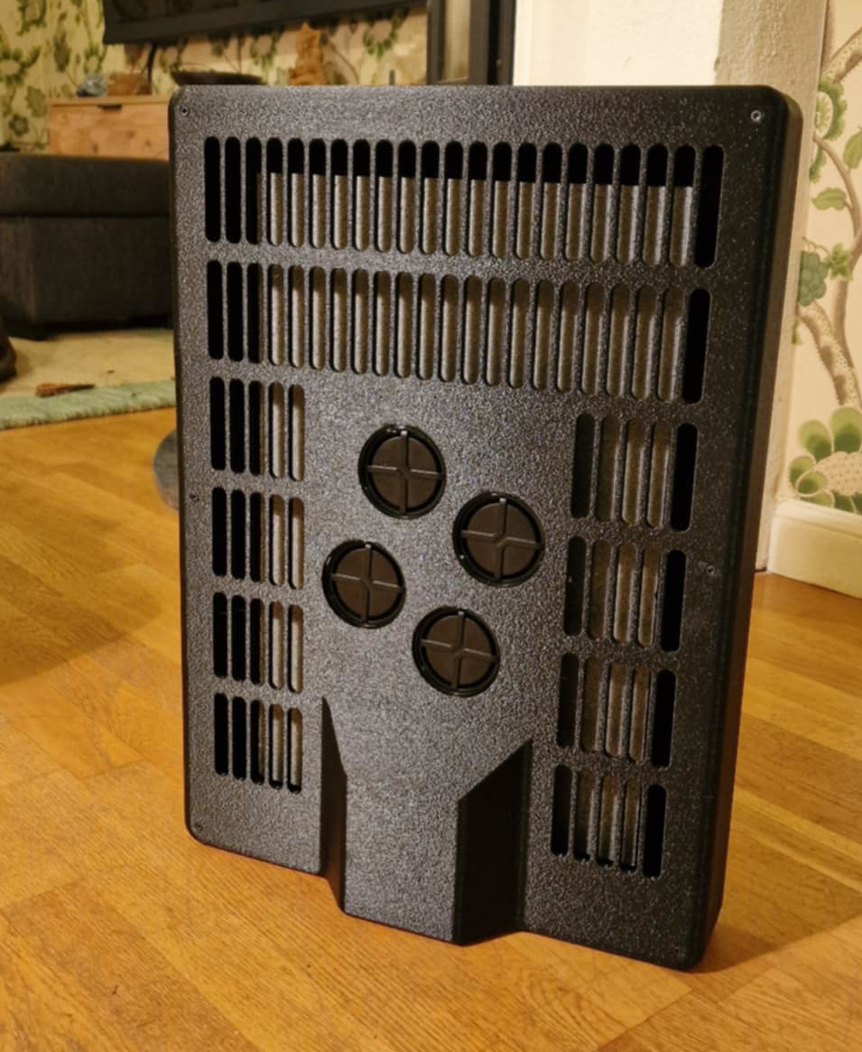

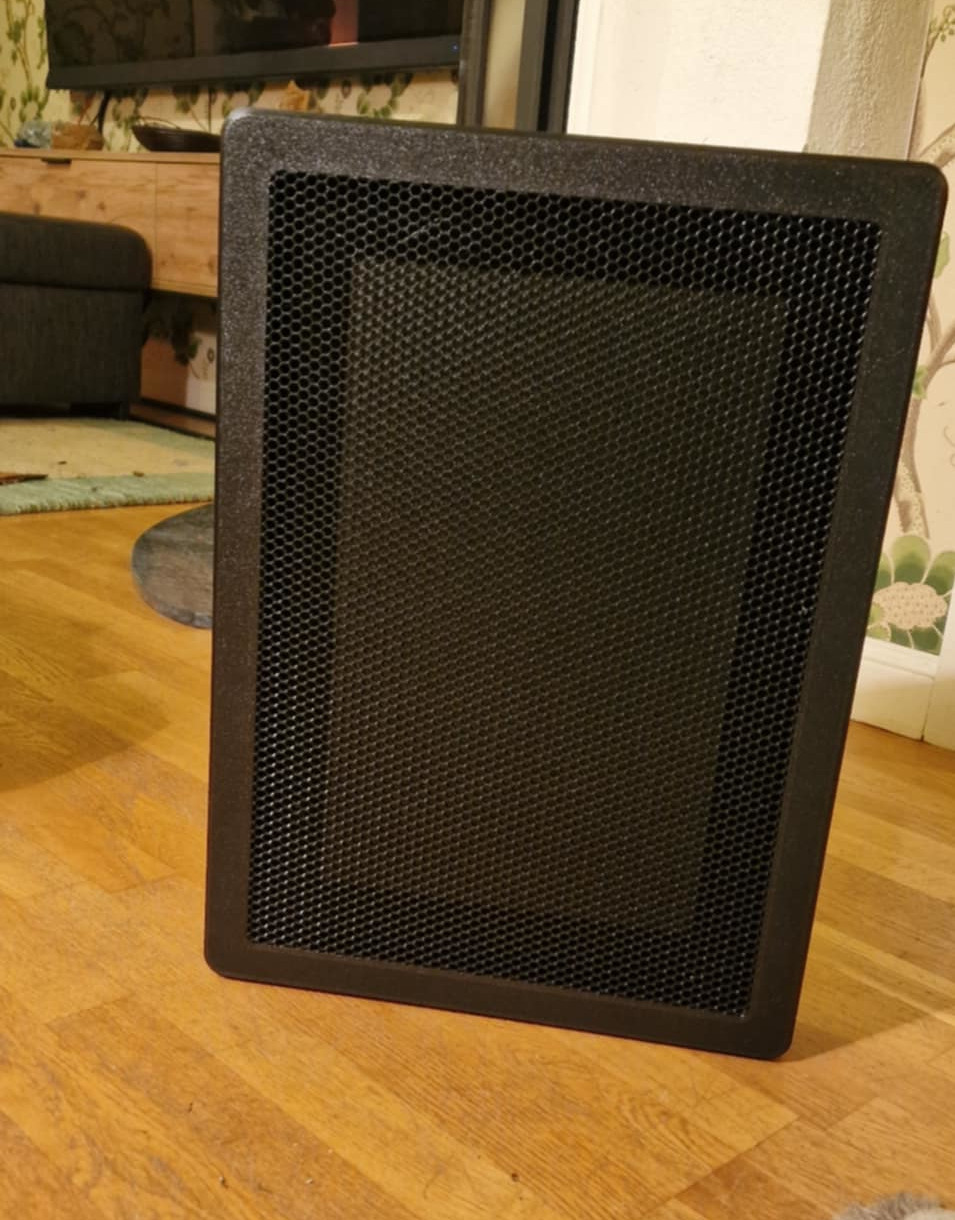

After a lot of trial an error and wasted filament, I finally got a first unit assembled today!
Have not done response tests yet, but first listen was very promising!
Seems better by every metric. Noticeably more sensitive, stronger bass and tighter and punchier throughout the spectrum.
All parts are connected with TPU seals to ensure no distortion from the frame. The plate is held up by a thin TPU suspension to allow it to better transition to piston action at lower frequencies.
One small but important improvement is that the exciters are held up by TPU surrounds that are fixed to the frame, but they can just about slide in and out which means they will find they "natural" most relaxed distance from the frame, but are still supported enough to not sag I hope. With my previous version I was forced to get the distance exactly right when mounting the exciters.
Will get back with measurements!

Hi Leob,
Nice work that looks amazing, glad it is sounding good as well. Are you still using graphite EPS 20mm for the plate? How is the plate attached to the perimeter TPU filament?
Are you still using 4 panels per corner of this arrangement?

Still using the same 20mm GPS but trimmed to a smaller dimension to give room for TPU perimeter without increasing the size of the speaker.
TPU is glued to the EPS using 3M Super 77 spray glue. Can be tricky to find an adhesive that sticks to TPU but does not dissolve EPS, but Super 77 seems to work really well.
Yes, will stick with four plates per sub, I had to push them very hard to match the subs, so the improved sensitivity is a welcome margin.
