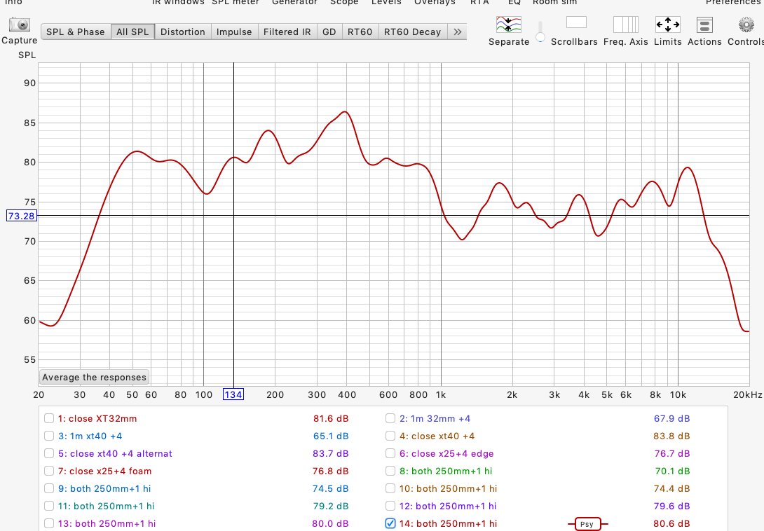

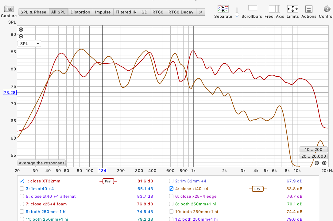

I received a couple of XTB40-8's and some XT25's today, I didn't have much time to play with them but did a quick test on an HD Eps panel I had.
The panel is approx 12mm thick HD EPS 600/400mm, I had tuned it with a couple of weights for the XT32 I had on it. It is suspended in a frame with 30/3mm foam tape around 3/4 of the edge, corners free. Around a 5mm gap to the frame. I removed the weights when I added the XTB40.
The XTB40 definitely falls off above 1khz then very steeply from 7khz. There is good bass to mid 40's but not noticeably more than the XT32 on the same panel, it will be interesting to see if it can handle more power and play louder without strain once I run it with the dsp crossover. The panel needs some work as there is suspension noise when it's turned up and the bass is more extreme.
Below are some quick dirty bench close mic measurements comparing XTB40 with the XT32. I didn't have time to try different positions but will in the future.
I also added the XT25 with a capacitor high pass near the edge to try them together, this is measured on the bench from 250mm. Second screenshot.
I think this could work well with a little tweaking and tuning.

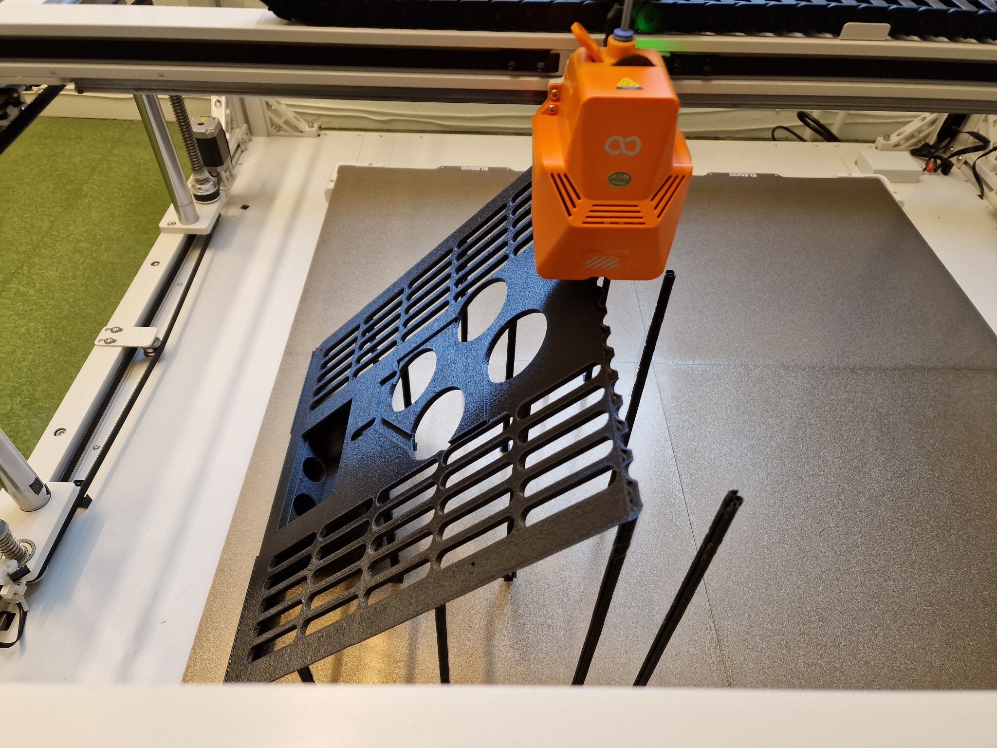

I got my large format printer set up and tuned, and did test printing a plate from LW-PLA to see if that could be a viable material. I had low hopes, and indeed the results was not very good. I did not bother to do measurements, just tried sticking an exciter on it and comparing to the EPS, and it had a dull sound and low sensitivity. Maybe improvements can be made to printing process and by applying coating, but with such a bad starting point it does not seem worth exploring further.

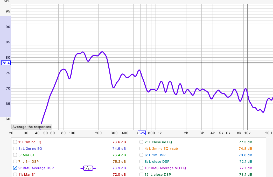

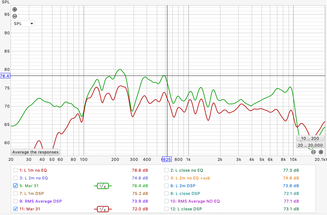

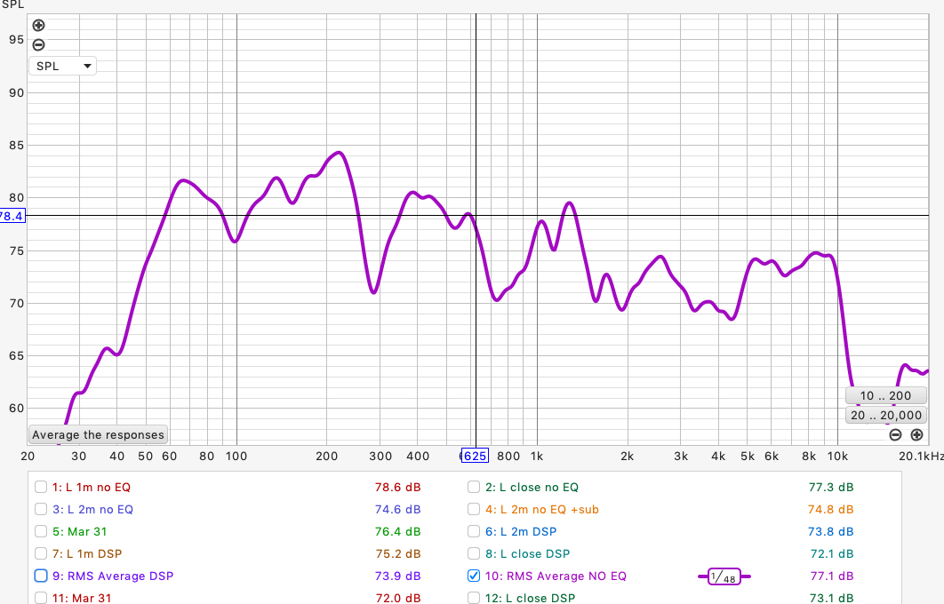

I've made a couple of panels now with the XTB40 and XT25 combo, high pass 1st order capacitor around 4khz. They are 600/400mm 20mm thick HD EPS with dilute hide glue and shellac coating. Suspension surrounds are 40/3mm adhesive foam tape all around, will see how the adhesive stands up to use but it is an easy suspension with damping and allows piston motion for the bass to some extent. I'm not sure if it is as good as the clamping in places with EPDM foam I was using for other panels but a lot simpler.
Un Eq'd they sound pretty good and definitely listenable, much stronger in the below 300Hz than others I have made, they fall off pretty steep at 10khz so I need to tweak the XT25, maybe different coating or thin the mounting area more as I have had better HF results on the EPS before with other exciters so know it is possible. I haven't tried to physically Eq these with weights or changing the damping yet.
With DSP I smoothed and boosted the highs plus put a high pass at 80Hz to save the panel as I thought the XTB40 may rip out the poly beads as it has quite a bit more force and weight than other exciters.
Did some quick tests, first is no EQ, second DSP both average of close, 1M and 2M measurements in room. 3rd is comparison moving mic 1m no eq vs DSP.
They have a lot more punch than other panels I've made and solid output to 60Hz they play loud too but haven't pushed them too much without a high pass. Moderate volume they sound good without a sub.
These will be my party panels probably, with a sub. I have a little BRU5 amp that has inbuilt DSP so makes it fairly portable.
