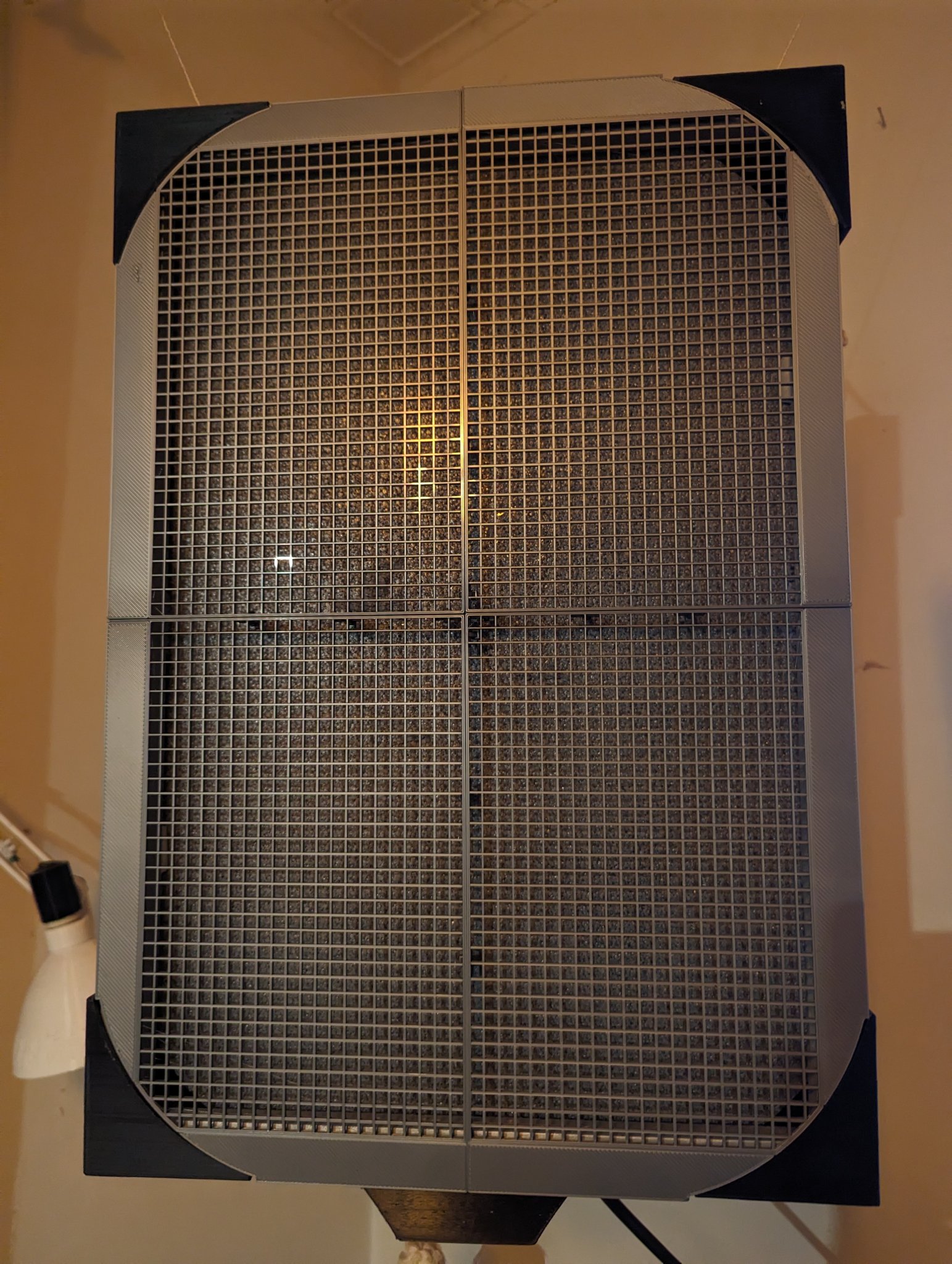

Designed som grills to give the fragile GPS some protection, and also made a version for the back side that will hold the exciters in a similar way to Andres design. Not the prettiest perhaps...it is a bit tricky since I have to split the print in four parts to fit on the print surface but looks acceptable I think.
Started printing parts for the back side, and will take pictures of that and do measurements when I have a complete speaker assembled.
Reactions: 1 users
I will make photos when I completed a plate, some more printing to do first. But here is a pic or the central part of the back that will be surrounded by grill, same as in the front:
The white material is TPU which is a bit flexible and that holds the exciters in place very gently.
I have been trying to soften up the suspension on some X32-4's by playing a low sine for many hours, and I do think they seem fine unsupported and it is what the manufacturer recommends, but I'm quite confident that this support solution is precise enough not put any strain on the exciters.
Reactions: 1 users
